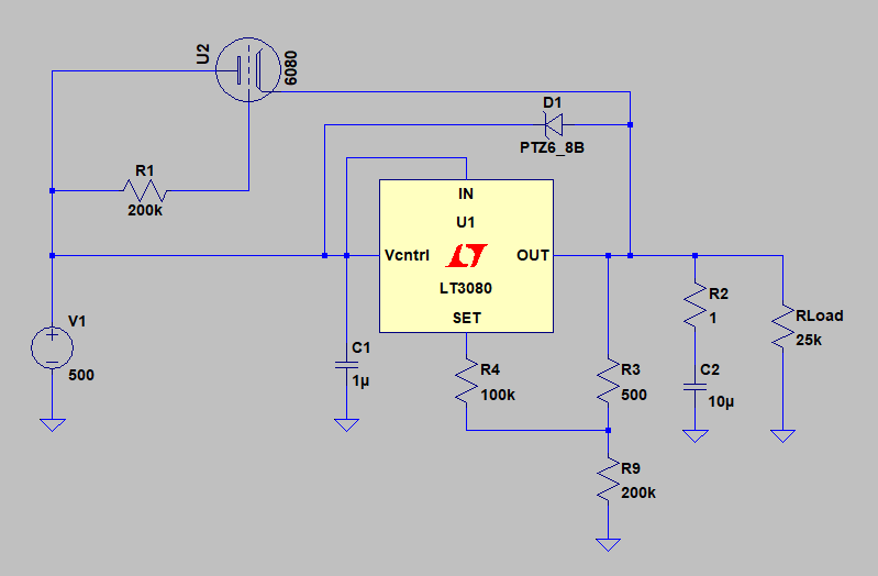

I want to add a shutdown circuit to this circuit. I want to put a photofet optocoupler across R7 to kill the SET current, as per the LT3080 app sheet. This will make it totally floating and allow it to interface with the TTL error output of my bias regulator. The app note also shows a diode from the output to the set pin. Is all of this sounding "kosher" to you?
You will have some leakage to the output through D2 and R1+R10 (~1 MΩ). We're talking uA in most cases, so you can probably kill it by a resistor on the output of the regulator (maybe in series with a MOSFET to eliminate the power dissipated in the load resistor while the amp is operating).
I have not tried implementing a shutdown that way, but I think it will work.
Tom
The app note shows another FET as a pull down device on the output. I do not need 0.00V on the output as my intent is to avoid using a fuse to protect the output transformer. If I get a few uA leakage , that is OK, I just want to make sure I don't fry the optocoupler or the regulator or any thing else. I am taking the plunge and making myself learn LTspice so I can sim this idea and check voltages on C3 and R7 during startup and shutdown during fault conditions. Thanks for the vote of confidence.

why not use the SHDN pin?
The big question is what happens to the cascode when you do that. Somebody's gotta prevent the LT3080 from sudden death over-voltage conditions. I think it'd work - at least in steady-state. The big question is the transient conditions (power up/down). A simulation would reveal that - or most of that.
What pin is that?
I'm guessing the SET pin. Similar to the "Adding Shutdown" schematic on page 17 of the LT3080 data sheet.
Tom
I get that the set pin voltage is brought to zero for shutdown, not a problem, I want to know what the 1n4148 diode is doing. And in a 400V reg is there a chance of putting to much voltage on the SET pin or the transistor that bypasses it. Tom, when you said your amp sounded better with the regulator, were you going from original Maida to your circuit or, unregulated to your circuit?
It limits the voltage between OUT and SET during shutdown.
Absolutely. That's why I'd run a bunch of simulations before making any recommendations.
I've tried CLC, floating voltage regulator (similar to Joe Curico's design), and 21st Century Maida Regulator. I found improvements at every step.

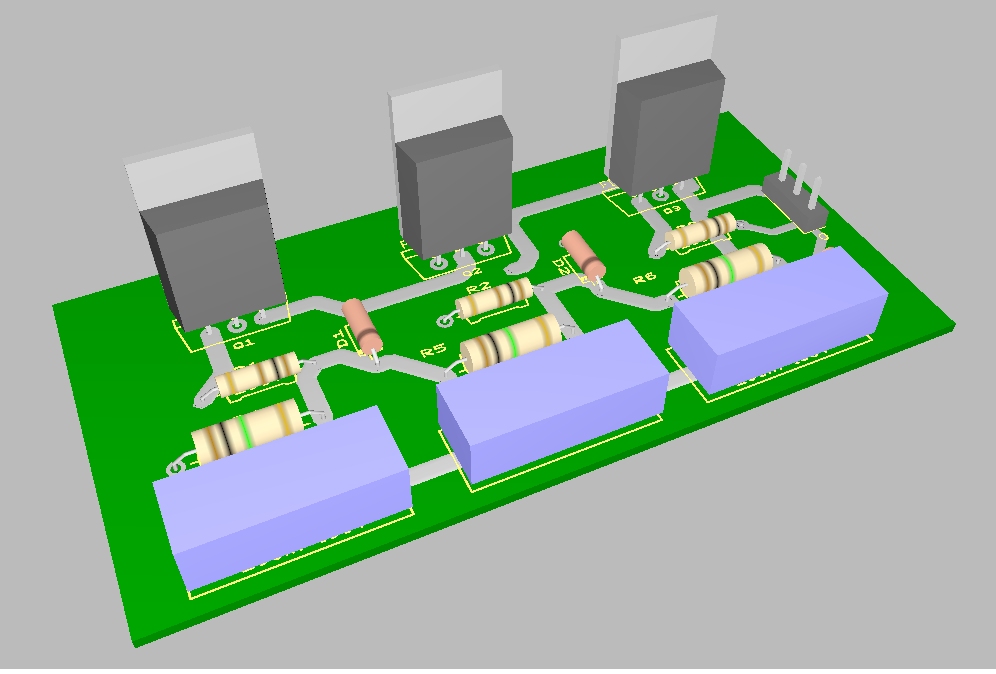

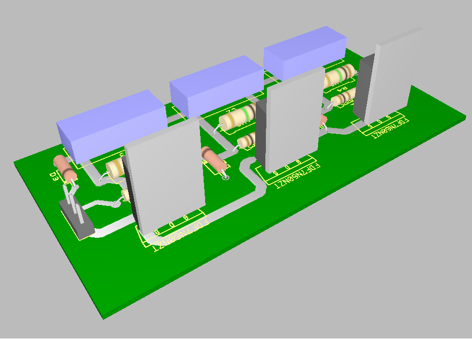

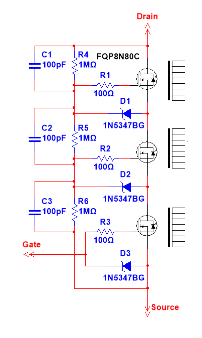

From Horowitz and Hill, the power (heat) across each MOSFET is divided by the number of devices:
Sure. Now you just need to get rid of ~250-500 W worth of heat (assuming you want 0.5 A or 1.0 A max output and regulation down to 0 V). That't why high-voltage supplies often use a switching pre-regulator.
Tom
Looking at the SOA of 3 heat-sinked TO-220 devices, at DC and 150V across each they should perspire, but not expire.
As you suggest, however, a variac on the front end! I also have a computer fan in my modified Heath IP-17
Could a MOSFET such as the FDL100N50F from ON Semiconductor work in place of the STW11NK90Z?
It has a larger SOA, but comes at the cost of higher capacitance. Is there a good way to predict whether instability would result from the FDL100N50F or any other MOSFET that has a greater SOA?
