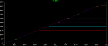

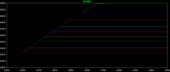

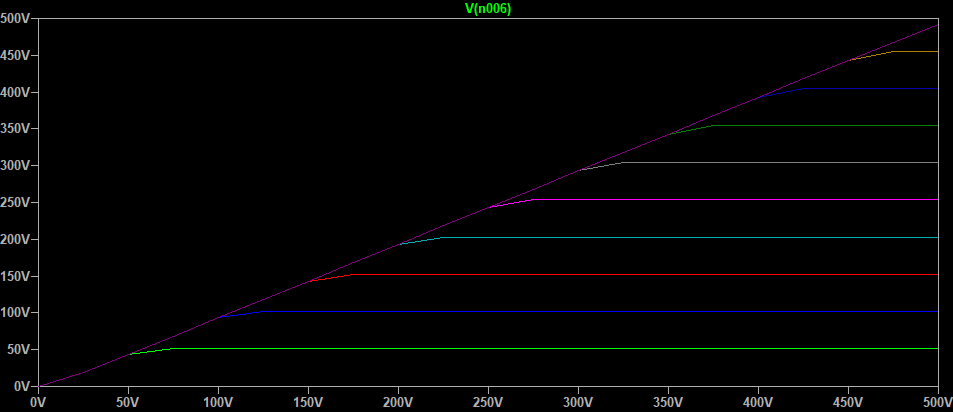

Tom has had part of his design ripped off for commercial use so most would be hesitant to give you this information. I wouldn't take it personally, if you email Tom, he might help you with some values. Are you trying to adjust nominal voltage? If so, experiment with R9 values until you get the results.
Let's do this again, here are two examples of stepping either R4 from the original schematic, a 5K potentiometer from 1 ohm to 5k in 500 ohm steps, the second image is stepping R9 from 50k to 500k in 50k steps.
