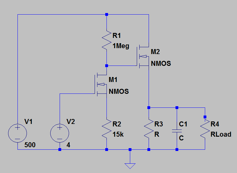

A depletion mosfet cascode current source with will have Zout in the tens of megOhms.
A simpler method for a DAC adjustable HV supply in bare bones -- imagine V2 as a DAC. For a regulated supply you can use an error amp in the control loop. One of my Heath Supplies had the tubes removed and this circuit substituted -- for an article in AX in 2003.
It's not going to work Jackinnj.. where am I going to get a precision HV rail with zero ripple?
The 2 DMOS current source was described by Walt Jung in AudioXpress, and is deployed by SY in 2 of his preamps. (Only the 1 DMOS source is described in "Current Sources 101, Part2).
The 2 NMOS AofE circuit I roughed out works very well indeed. It's been updated a bit in the current edition. I used it as sweeped souces for an mcu curve tracer, one for B+, and a stepped source for C-
We are straying from the topic which is Tom's design and how to control the ouptut with a DAC.
You could use a 21st Century Maida regulator. 😉
Tom
We are straying from the topic which is Tom's design and how to control the output with a DAC.
Instead of DAC, what about a digitally-controlled potentiometer? There's probably a real good reason why it won't work...and I'll admit, I've not given it much thought.
A dream of mine has been to take Tom's design and make it externally adjustable. I have a small assortment of tube radio receivers and transmitters for which I need to build mains supplies. The "correct" transformers are expensive; I'd much rather use the big iron transformers I have that are too high in voltage with Tom's regulator. If I can make it adjustable, one power supply could power multiple radios.
Problem is, the adjustment is in the control loop and 8" leads from the board to a front panel mounted pot could cause issues. A DAC or digital pot on the board would keep things nice and close in the control loop.
Things to think about... 🙂
thanks,
ben
Digital pot, or digitally controlled switch can only stand off a bit less than the rail voltage.
For the LT3080 there's a way to deploy the LND150 TO-92 DMOS in the Rset circuit ... look at the Supertex application notes.
