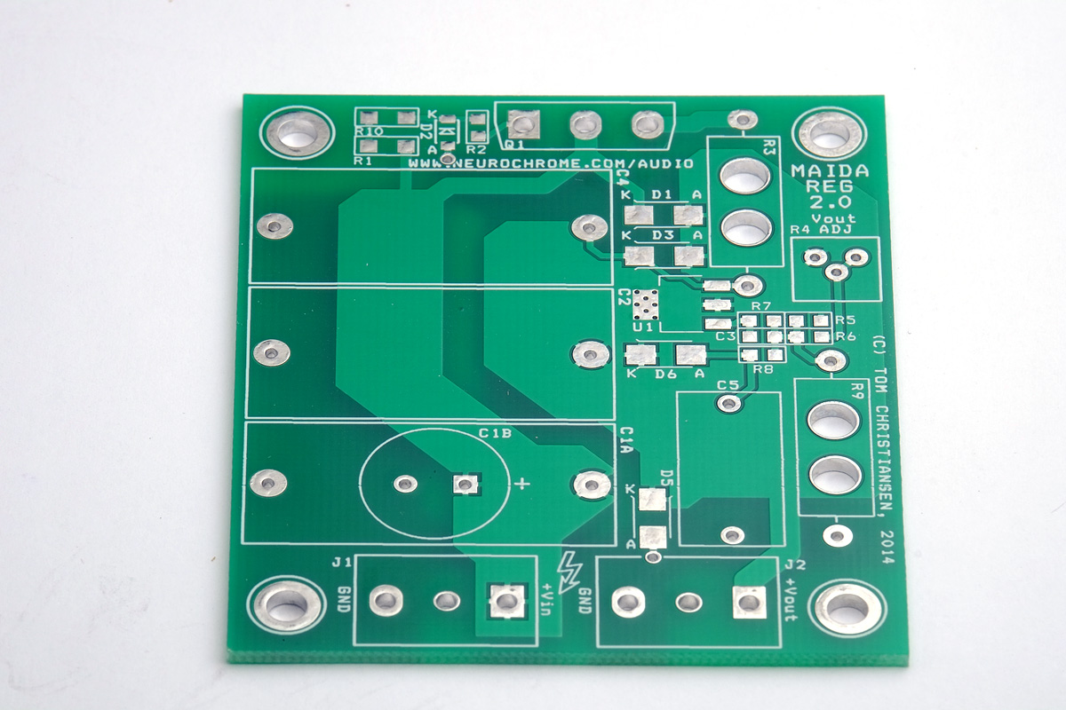

Tom,
On the 21st Maida reg. PCB capacitor C1b has a value 10uf/450 for voltages lower than 400V.
For higher voltages you populate position, C1a, with a lower value polyprop cap instead. C1b is intended for an electrolytic cap due to size limitations.
Will using the lower value polyprop intended for higher voltages in a lower voltage set-up (200V) give inferior results? My reason for asking is that I am planning on an all polyprop PS.
More capacitance is better, hence, I specify an electrolytic cap for C1 for voltages where electrolytic caps are available. If you'd rather have a polypropylene cap, just go with the one I specify for operation above 400 V.
