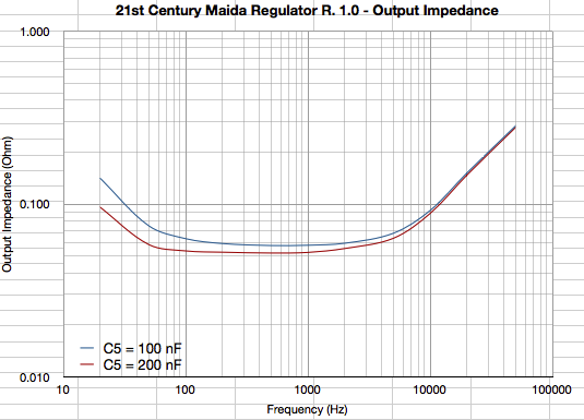

Tom, as I recall, you reported an excellent PSRR - something like 20uV out of 20V ripple. Do you have a graph of output impedance vs. frequency?
Yes I do. See Post #46. Here's the plot:
The current BOM has C5 = 220 nF. 21st Century Maida Regulator Rev. 2.0 likely has lower output impedance at higher frequencies as the layout has been optimized for that. I've yet to take the measurement to confirm, though.

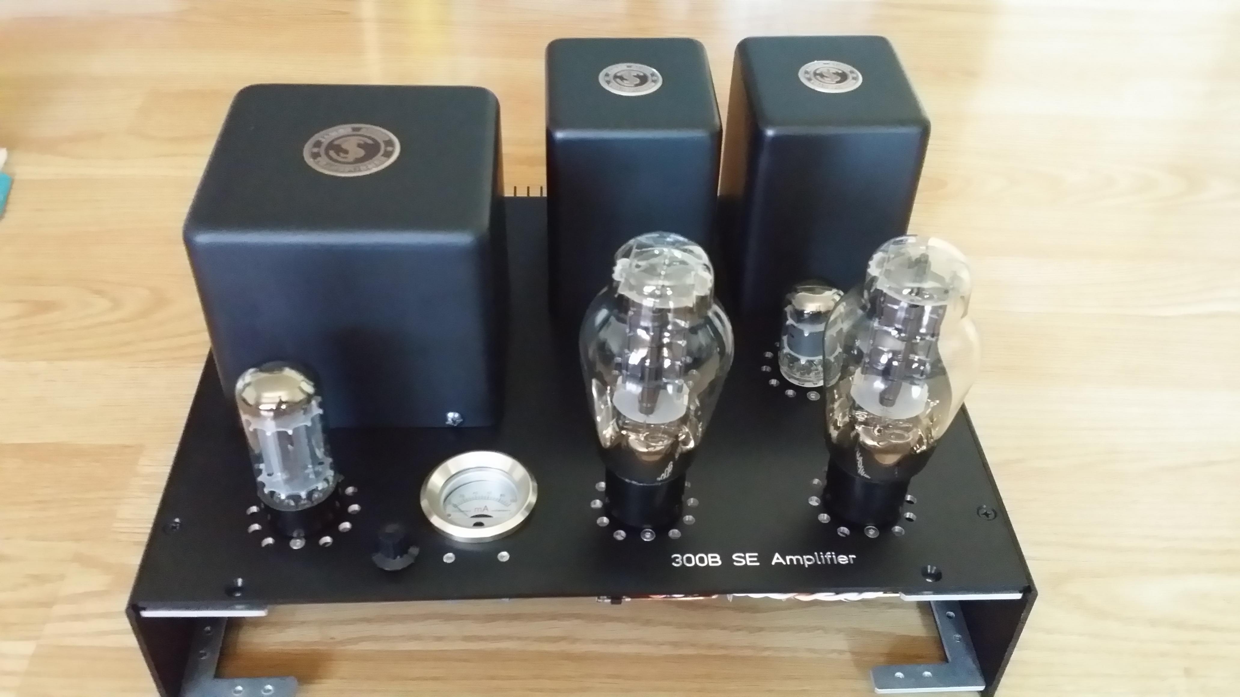

I've been searching for something like this 🙂 The first thougth is to put your
regulator between C11 and C12 and to shift the 380v ac tap to the the 390v tap, the amp is already built.
That would give me (at least) the necessary 15 v aquired for regulation to the 445V in the schematic. Any comments ?

Sorry for the belated response. I was traveling. You can get rid of the LC filters in the supply if you wish. The Maida Regulator will provide plenty of regulation, so you don't need all the filtering. I'd leave C11 and C12 and hook the regulator to C12.
