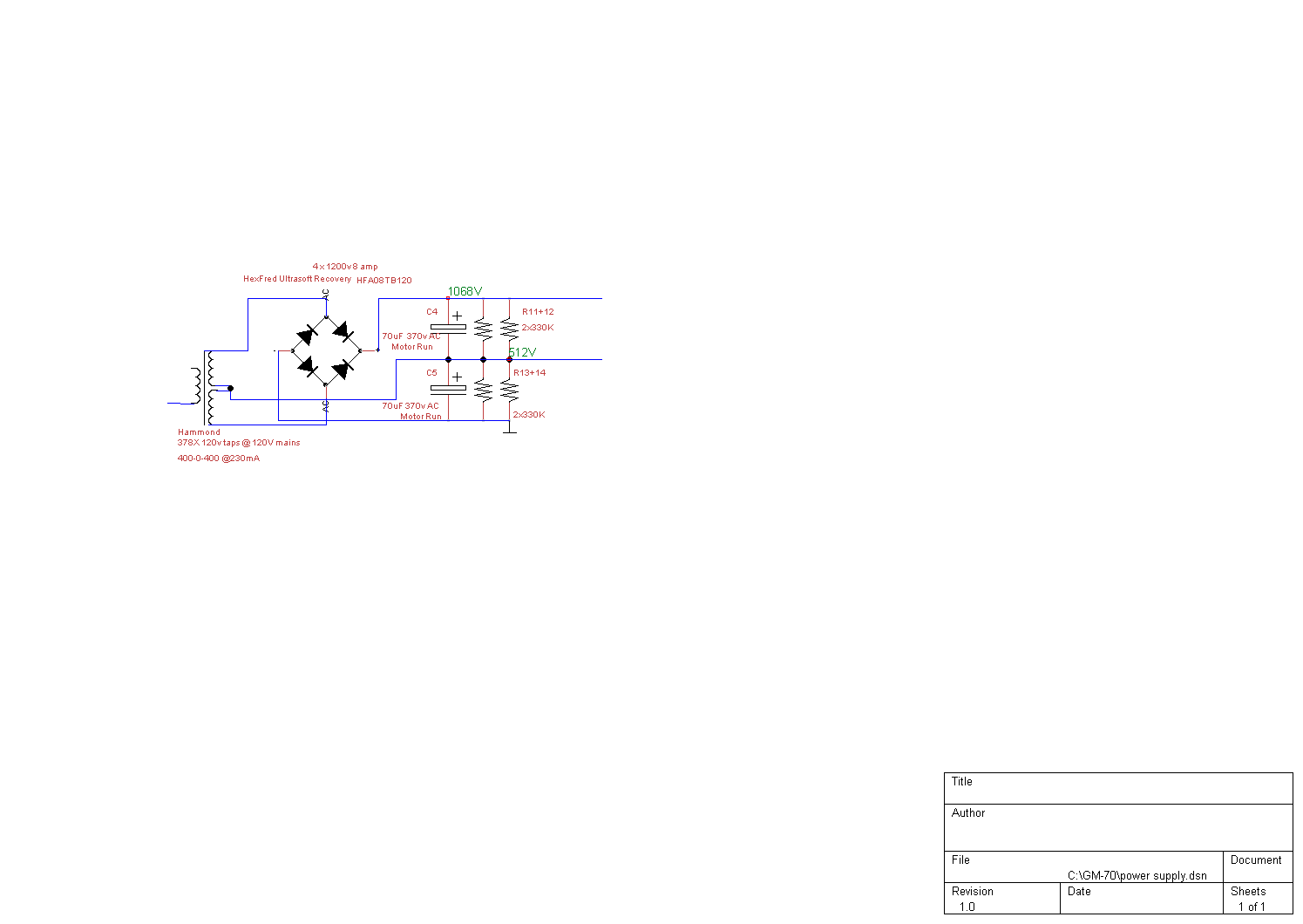

Would something silly like using a regulator like this on a 211 @ 1000/1100V be possible?
Provided all components are replaced where necessary for ones that can handle the voltage(if they exist). Maybe through hole for some extra spacing. At first glance not a lot low rson / high PD 1500/1700V n-channel fets, it might be a bridge to far.
211 and other similar tubes require a separate dedicated anode voltage transformer. It makes no sense to regulate this supply, you would just burn off tremendous heat in the regulator.
The driver circuit runs from its own lower voltage supply, and may well be regulated.
The 21st Century Maida Regulator can operate with up to 800ish V in. The output voltage is limited to about 600 V.
As mentioned above, you'll burn a tremendous amount of power in the regulator at such high input voltages.
Tom

I don't want to burn a lot of power, 1150 in 1050 out @ 70mA, something like that.
The same way you use it in a 300b amp, running a 211 @ 600V makes no sense
I need regulated supply's in the driver because it will be a dc coupled design, but the output stage will benefit the most from the Ultra-low output impedance swinging between 140mA and 10mA at full power

I think a tube-based regulator may be a better candidate for voltages above the 600 V supported by the 21st Century Maida Regulator.

Would stacking a maida regulator on top of a maida regulator work? If your power supply design would allow it.
Like attached:
I'm already stacking supply's to make the amp dc coupled, the 211 ground will be at +320V compared to the input stage ground. And a 100V supply will stack on the 320V one providing the power for the input stage.
The 320V and 100V need to be regulated to provide a stable bias for the 211.
What's one more stack gona hurt 🙂 , but I'd prefer a single regulator.
Or use this regulator.
that design seems a lot more complicated and would be operating at it's limits it seems, but could be made to work.
But it would be easier to get the 21st Century Maida Reg. working at 1100V.

STW9N150 1500V 8A 320W nfet or STP12N120K5 1200V and keep Vin under 1100V.
The biggest challenge with the Maida Regulator (21st Century or Mike's original circuit) is to make it survive start-up and the high di/dt pulses you get if a socket is loose and the B+ disconnects briefly. It's very easy to hit the SOA limit of the cascode device during start-up. This results in spectacular fireworks... Ask me how I know... 🙂
I wonder if a tube-Maida would be the answer. Use a tube for the cascode. They can handle both the voltage and the power and tend to be rather indestructible compared to silicon devices.

are these risks so much bigger at 1100V 70mA than at 400V 300mA?
The issue is not the power during steady state operation. The issue is at start-up. 1100 V at whatever current the load draws on start-up means trouble. If the load has any capacitance, it'll behave like a short circuit at first. This kills cascode devices.
I suggest running a simulation to play with this.
