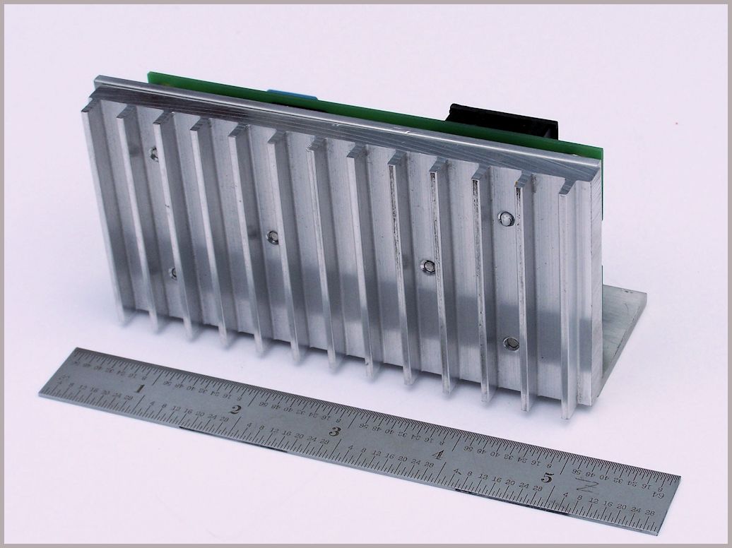

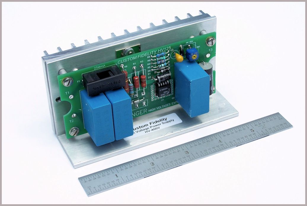

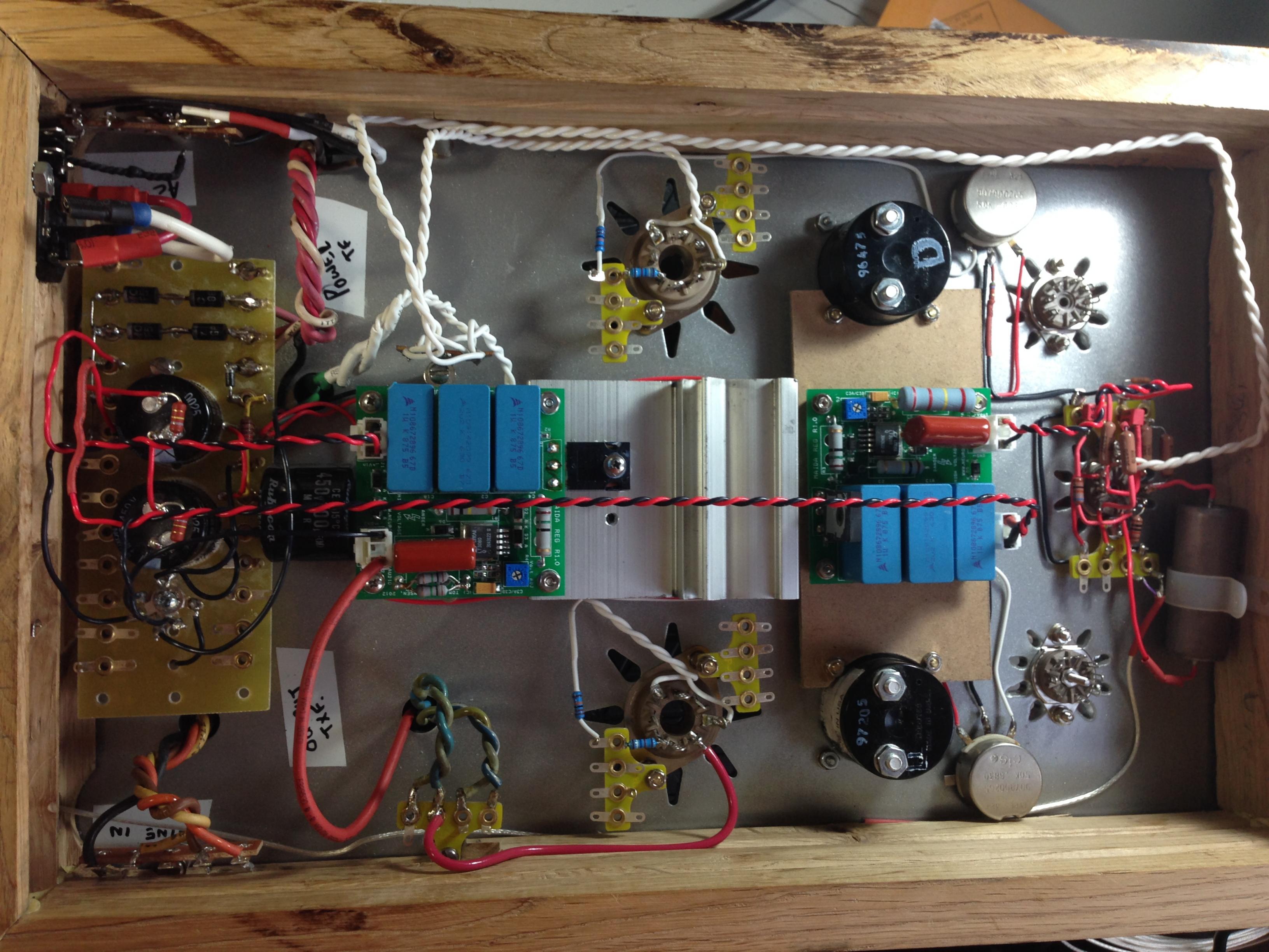

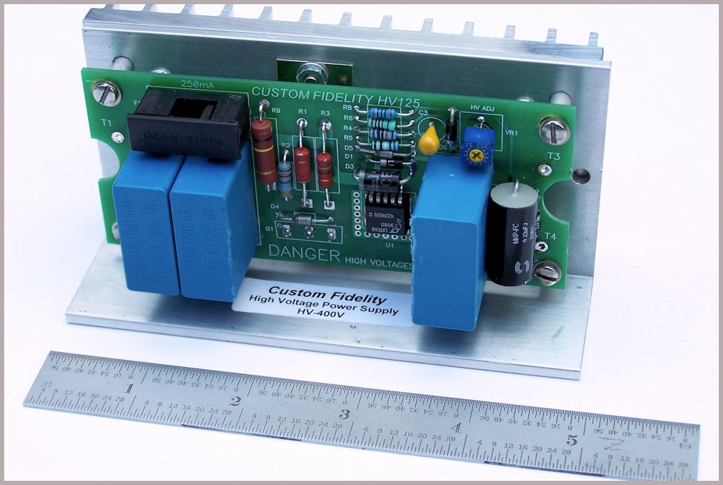

My version of the Maida.
Hi all:
I've played around with the app note LB-47 for several years now and have
made several proto-types in the past. But thanks to Tom's fine work and inspiration I've revisited this project. I wanted a "goto block" for my pro-audio
tube projects. This design comes in 2 offerings of a high power (no external heat sink) and a low power version. The low power is for preamp or microphone projects. The high power version handles loads up to 200mA. Let me know what you think. All comments appreciated.
RonL
Hi all:
RonL
