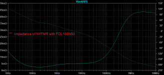

Is there a good way to predict whether instability would result from the FDL100N50F or any other MOSFET that has a greater SOA?
If you plot the output impedance wrt frequency you can estimate phase margin by looking at the Q of the impedance peak (if there is one). It looks to be stable.
You can make the NYFMR unstable by playing with the values of the output capacitor, its ESR, or the other caps.

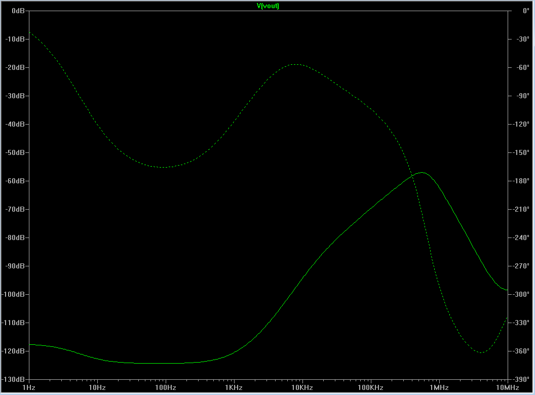

[*]What is the bandwith of the ripple attenuation and regulation?
You can see the simulated line rejection in attached figure. You should see about 70 dB of attenuation at 200 kHz.

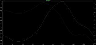

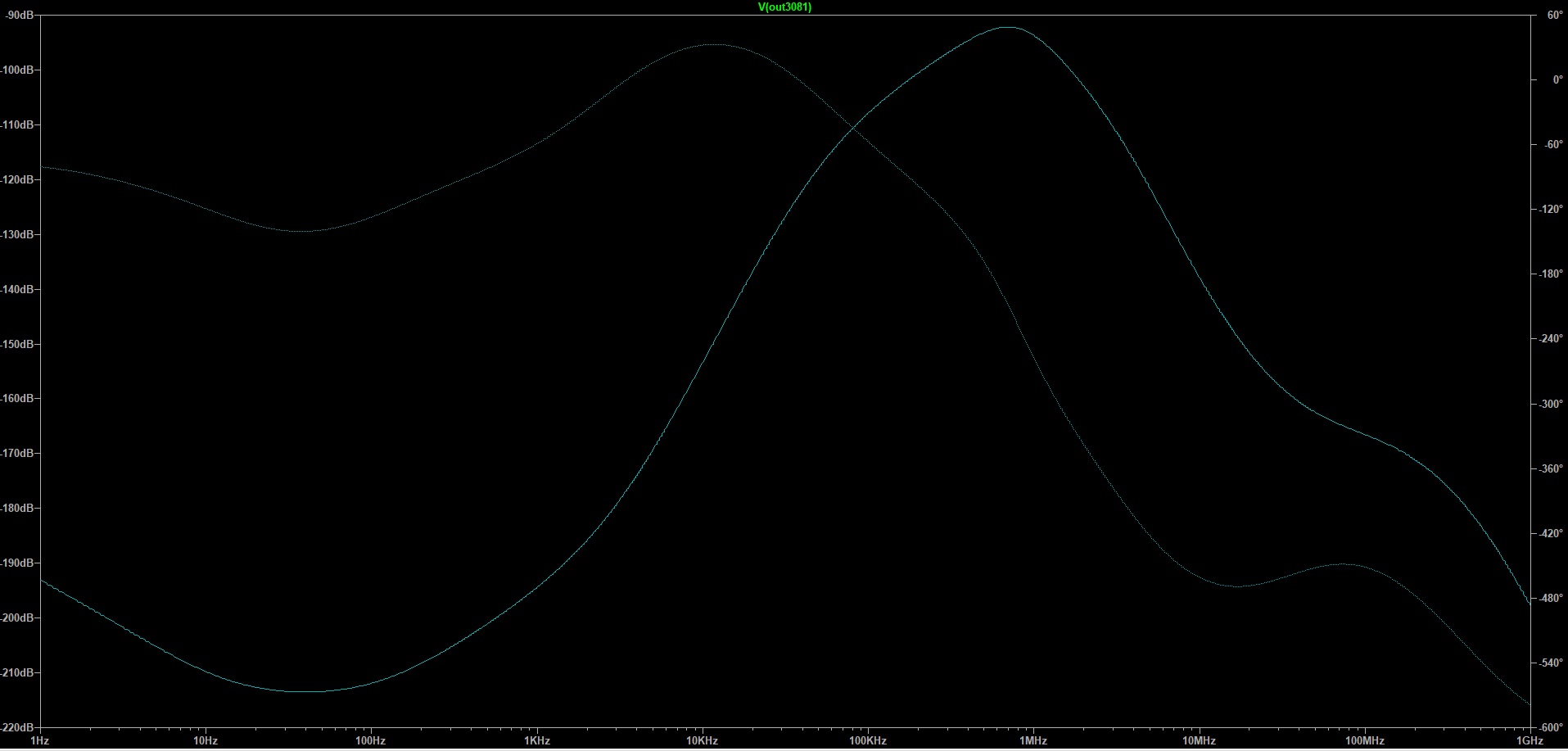

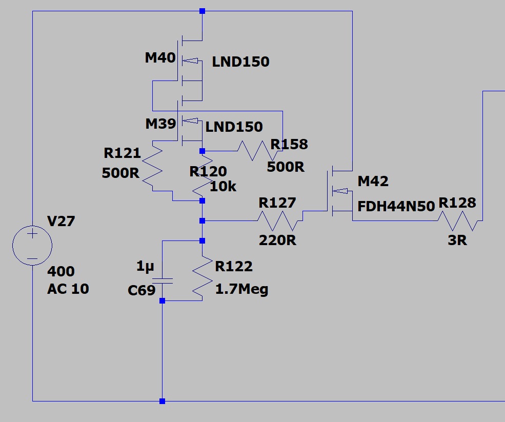

I was playing around for fun with Ltspice to see if I could drop the PSRR even further (though I image there would be no practical benefit). I was able to get extremely high PSRR by adding a Mosfet pre-filter. Not bad for $10 of extra parts.

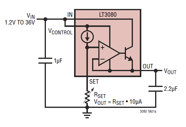

Regulators such as the LT3080 and LM317 employ a ground-referenced voltage divider whose output is connected to the adjust pin and whose input is driven by the regulator output.
The VRef of the LM317 is more correctly stated being "referred" to the output pin, providing a fairly constant ~ 1.25V between OUT and ADJ.
The LT3080/LT3081 uses a current source into Rset to fix the reference voltage at the non-inverting input. It is ground-referenced.

You need to look at the schematic that I posted to understand how the LT3080 and the LM317 are used in high voltage regulators by Tom, me and others - with the referenced positive feedback network.
You are correct that the LT3080 sources a very accurate 10uA current meant to flow through a resistor to establish a voltage, and of course, it does this very well - that's the genius of the part.
We are generally reluctant to employ an R = 40MegOhm resistor to establish 400V out, although I have tried a 30MegOhm resistor, and it does give me 300V! You can even parallel it with a capacitor C to obtain a turn on time constant of R x C.

30 MΩ is awfully high. I get nervous with impedances much over 1 MΩ. At those levels, any flux residue, dust, humidity, whatnot will impact the DC precision of the circuit.
I use the 10 uA to set a reference voltage across a resistor. This sets up a reference current of 2 mA in the resistor that sets the output voltage. That's how I can have a 200 kΩ resistor set the output voltage to 400 V.
