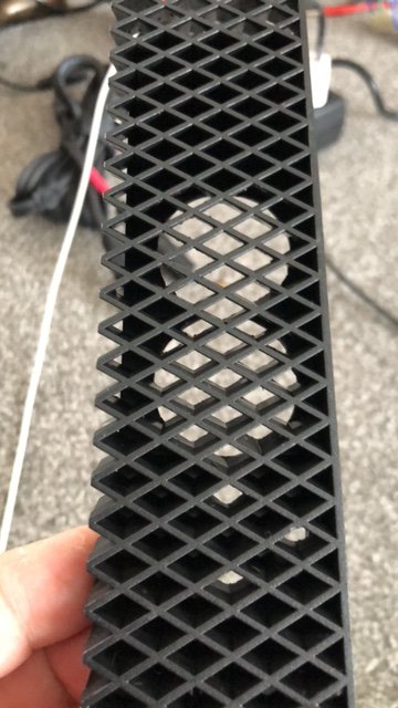

correct 👍Flat on the bottom sucking fresh air from below through large enough slots creating overpressure in the device and therefor blowing out hot air through ventilation slots at the back and those at the sides. Probably a non perfect way but at least (...)

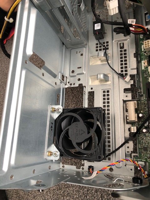

Agreed, the heat dissipation inside a case by means of one or more fans requires in my view a more scientific and not approximate approach.If anyone thinks that installing a low-noise fan is the solution, they are mistaken, because how is the laminar flow (necessary for the A1) to be generated?
In my opinion inside the A1 case the fan would be without a doubt too small and therefore with too little air flow to demonstrate any effectiveness.
And in any case, no more than one would fit and in that case it should have an extractive flow in my opinion.
But it should also have a quantity of slots sufficient to feed the air flow of the fan and to let fresh air into the amplifier.

At that point, a large external fan blowing cool air onto the boiling "heat sink" would be more rational (however, it wouldn't be my choice anyway), also because the larger the diameter of a fan, the smaller the noise it generates for the same air flow.
Post #100: 60 x 60, 70 x 70 or 80 x 80? Larger is better. Sunon maglev is good. BTW 1 fan is a necessary evil, adding 2 fans is SM. Some therefor prefer non class A as excess heat, high energy consumption, shorter lifetime and now the need to add fans all really are a nuisance except when one likes the sound of air flow over music while checking the energy bill. An external fan is in my strong opinion a dealbreaker making the A1 a non desired device.

1. No space for enough 4 or (better) 6 mm holes?
2. No space for just 4 mounting holes for an elevated fan mounted on standoffs or rubber grommets to the PCB?
Even just mechanical air flow from the sides can be adequate.

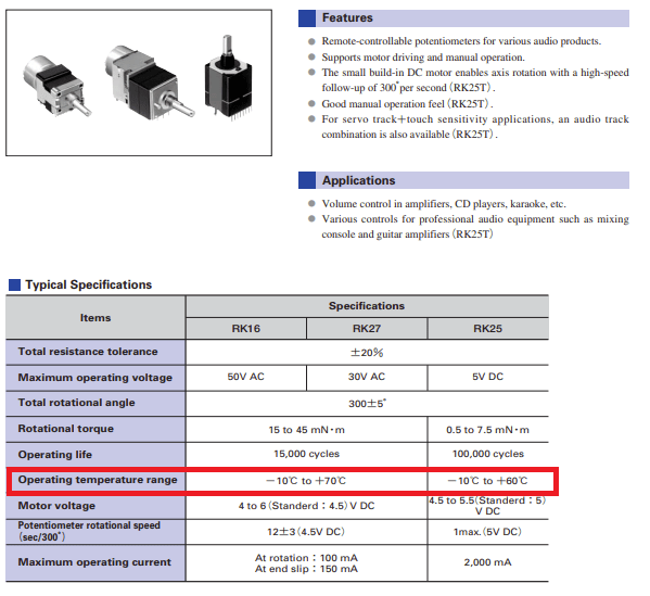

thats is what you can buy ....you know that big boys can have a custom part ??It seems that the temperatures reached inside the case will easily make the pot (gear) go beyond the limits imposed by its design as from Alps spec.
In other words, it simply seems yet another bad choice by the designer(s), or a consequence of it (that's the overheating). 😉
if is fault unit ask for new ones quite simple
I think that if any component is forced to work outside of its operating temperature range then it is not a fault of that component if it breaks, it is the designer who have inevitably caused it to fail.if is fault unit ask for new ones quite simple
Furthermore, no manufacturer's warranty covers that kind of "fail".
it is your idea as you DO NOT know the pot used nor if is alps , btw 70° on datasheet you posted the amp work at 60° quite normal for classA in summer
