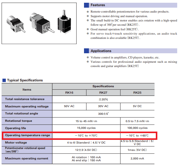

With my DUT, the motor potentiometer reproducibly no longer wants to be operated motor-driven after a very short operating time - just to name one effect of the internal device temperature.

Blame Alps or the makers of pot ....tollerance gearboxLast repetition:
The engine potentiometer no longer likes to turn (the gearbox!) when it has become burning hot after 1.5 hours.
It seems that the temperatures reached inside the case will easily make the pot (gear) go beyond the limits imposed by its design as from Alps spec.
In other words, it simply seems yet another bad choice by the designer(s), or a consequence of it (that's the overheating). 😉

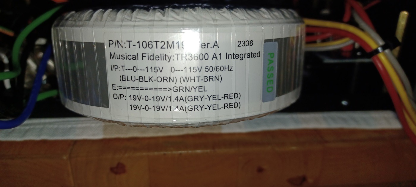

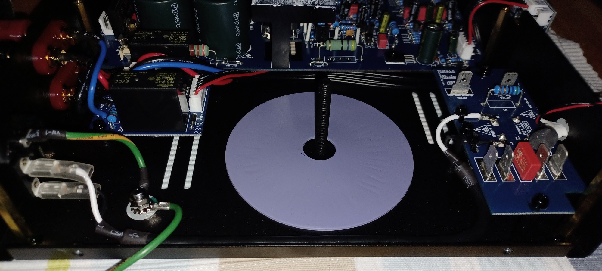

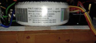

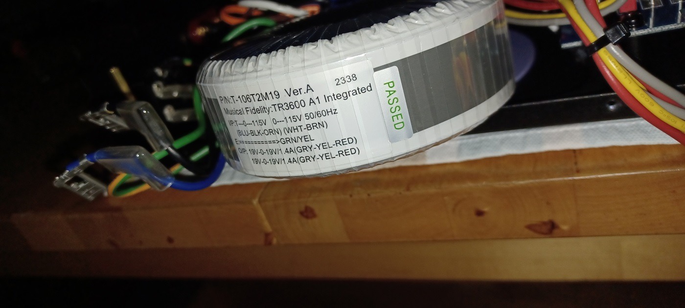

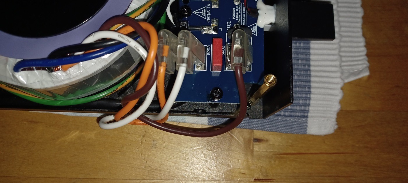

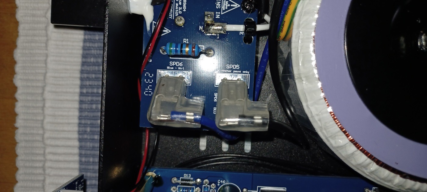

It is not possible to turn the mains transformer so that the conductors carrying the mains voltage do not touch the hot cover. The secondary side (4 times 19Vac_1.4Aac) also touches the cover with its cables.
Hopefully the PE is really in contact with the anodized cover, the heating plate.
I find this point impossible and dangerous.

PVC melts at 90 degrees I think 😀

So there is a lot wrong here.
I can't remember that the old, original A1 getting as hot as the new one - the bottom of which is also at least 50°C after 2 hours of operation and the distance to the load-bearing rack surface is effectively only 10mm to 12mm - so the “Satan” heats up all around.
Somehow I hope that the responsible MF chief designer is reading this thread: a hi-fi amplifier that can no longer be touched during operation is (2024) a nogo.
- After 2 hours of operation, the lid temperature directly on the surface is 58°C and 54°C inside
- When I look at the tiny mains transformer, tiny in terms of VA, then I know immediately that the current MF-A1 can never deliver more than 2 times 16Wrms of continuous power
- Can the MF specification of the damping factor with 150 never be correct, more than theoretically 34 are not possible with the current circuit - or is there a negative internal resistance of the two halves of the circuit(?).

The A1, with its typical 0.8Adc quiescent current, is a 20Wpeak (ergo 10Wrms into 8Ohm static loads) PP class A representative.
And it doesn't have to get that hot - rails of +/-16Vdc are sufficient, as a result a modern, somewhat up-to-date A1 would only have to convert >51W power loss into heat.
As we all know, the A1 gets a little bit cooler under signal control /modulation. But not at a high room-volume, that's not enough.
Such a small class A PushPull representative should therefore not get so hot, unless the cooling element is incorrectly dimensioned, incorrectly mounted and the operating voltage is too high. Both are present in the current model!

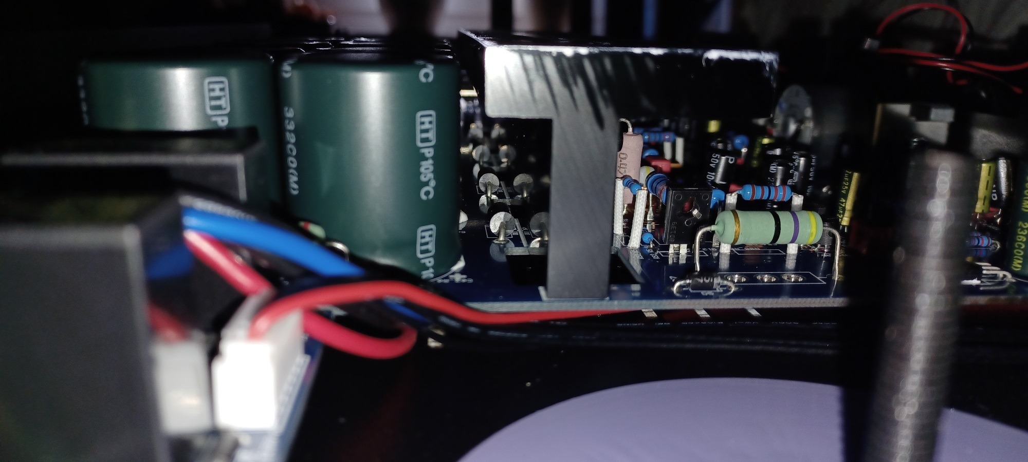

How long will the small TIP3xC survive an external housing temperature of 60°C during operation? A 1/2 hour and then they start to think about when the first of them will fail next year!
That really didn't have to happen, the alibi relays on the output side are really just ballast - or did the old ones have a switch-on/switch-off pop? No. I can't remember that.
I doubt the existence of a protective circuit - the µC and the output relay seem to be just waste.
