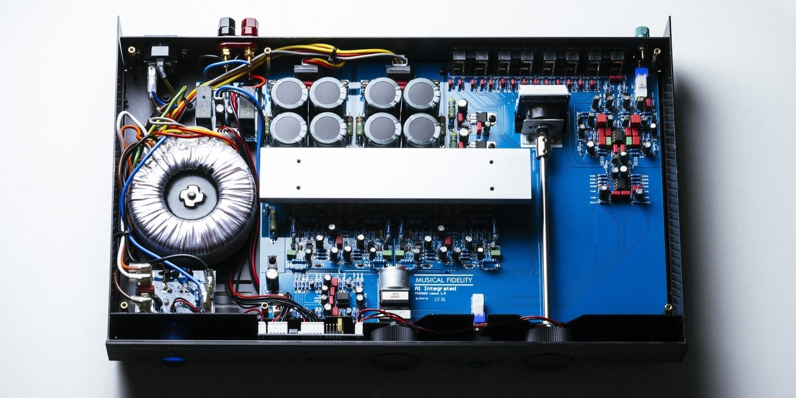

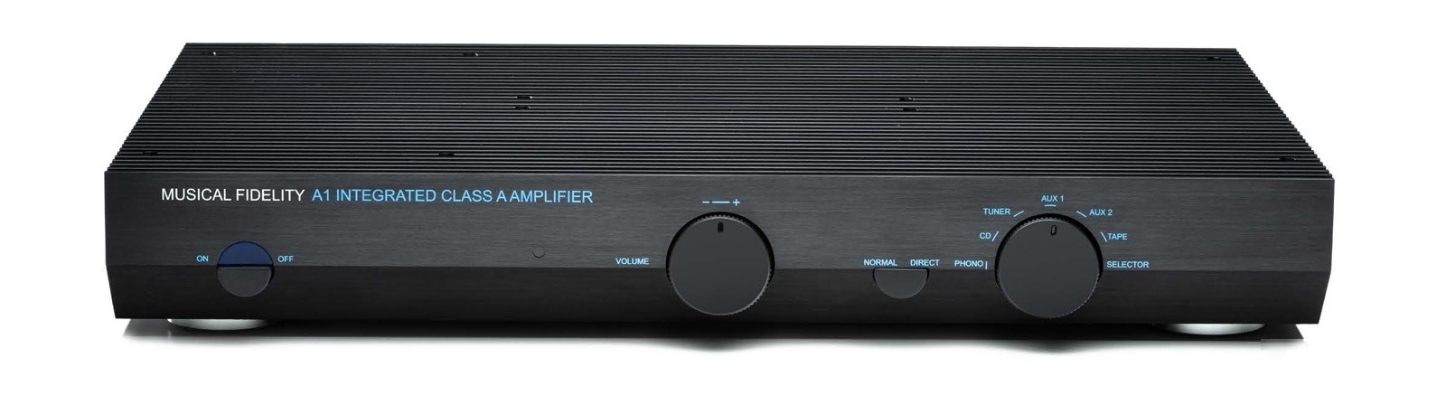

It is back. Like a horror movie it keeps haunting us. This time with speaker protection.

Oh yes it did sound excellent ... when it worked. The 2023 one seems Chinese built so things can only get better :) Curious: the exact same and often criticized preamp stage with TL072 has been incorporated just like the T beam construction for the heatsink (used to be spread with a thick layer of dried out heatsink paste).
Note: the A1 was a very musical device but I repaired them enough to avoid them.

The inside of the one you posted seems just like new...

Good idea. I'll make another one too. Just noticed that MF reintroduced A1 again which brought back fond memories of exploding caps and burnt woofers. This device nearly cost me an eye so I think my criticism is justified. Probably its popularity is driven partly by the famous name behind the design and the class A mysticism around it. That really works OK marketing wise even when devices break down way more than the average. It just works like that, no one trusts a nearly perfect design by an unknown person. Crappy devices (of which most have gone to recycling) by a famous name keep high value and are cherished even when they're totally defective. I was asked various times to repair these even when they were clear goners.

As a technically orientated person I would have cutoff supply lines if I did not need the power amplifier section to avoid energy loss and useless heat. The energy loss and generated heat make sense when one uses the class A power amplifier of course as they're part of the deal.

However it was really impressive the heat that emanated all the top heatsink, it was literally untouchable, maybe that’s why the breakdowns were so frequent.

Not maybe but for sure. I recall the first versions to have volume potentiometers and source selector switches going bad because of the heat. The electrolytic caps unsuitable for the heat launching like missiles out of a submarine.....
Love hate relationship really as I still think they're beautiful. I forgot but there also was a 2008 A1 revival model. Till this years model 200.000 have been sold which might explain the reintroduction in 2023.
