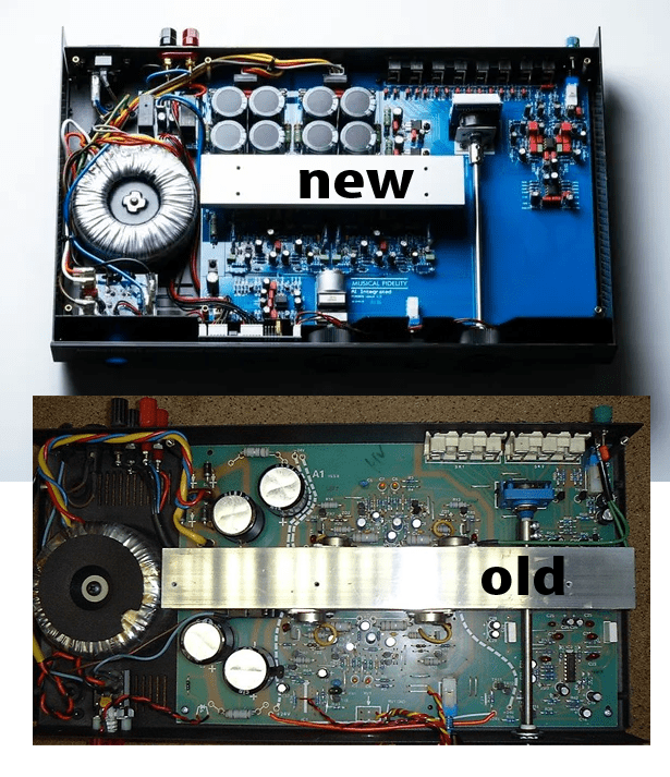

I can only say that you can clearly smell the components cooking! The new one has been running in test mode for three days now. The heating plate looks (or rather looked) interesting, but it was never intended to reach more than 35 to 40°C - along with the blue lightsabers, actually the exclusion criterion!

hbtaudio, if a fan is needed the device is not up to its task. Those 8 pieces 10.000 uF 35V by Jamicon will likely be the first to go. Before you want to mention the blue LEDs another time please send it to me and I exchange them for the color you like 😊

The old A1 had too tight chosen caps with regards to both working voltage and maximum temperature. If the Jamicons are again 85 degrees rated and again are run at their maximum working voltage then MF just did not learn from its own mistakes.

The detailed photos (inside) reveal quite a lot of internal details immediately. The installed capacitors (all) cannot withstand the thermal stress for 2 years, never ..!

Have you noticed that there is no longer any space for the cooling lid above the standard charging cap's ("Ladekondensatoren") - they are literally grilled like sausages. And the KBU8 rectifier bridges will definitely also get very hot, many series heating resistors in the supply voltage lines can be identified ..!

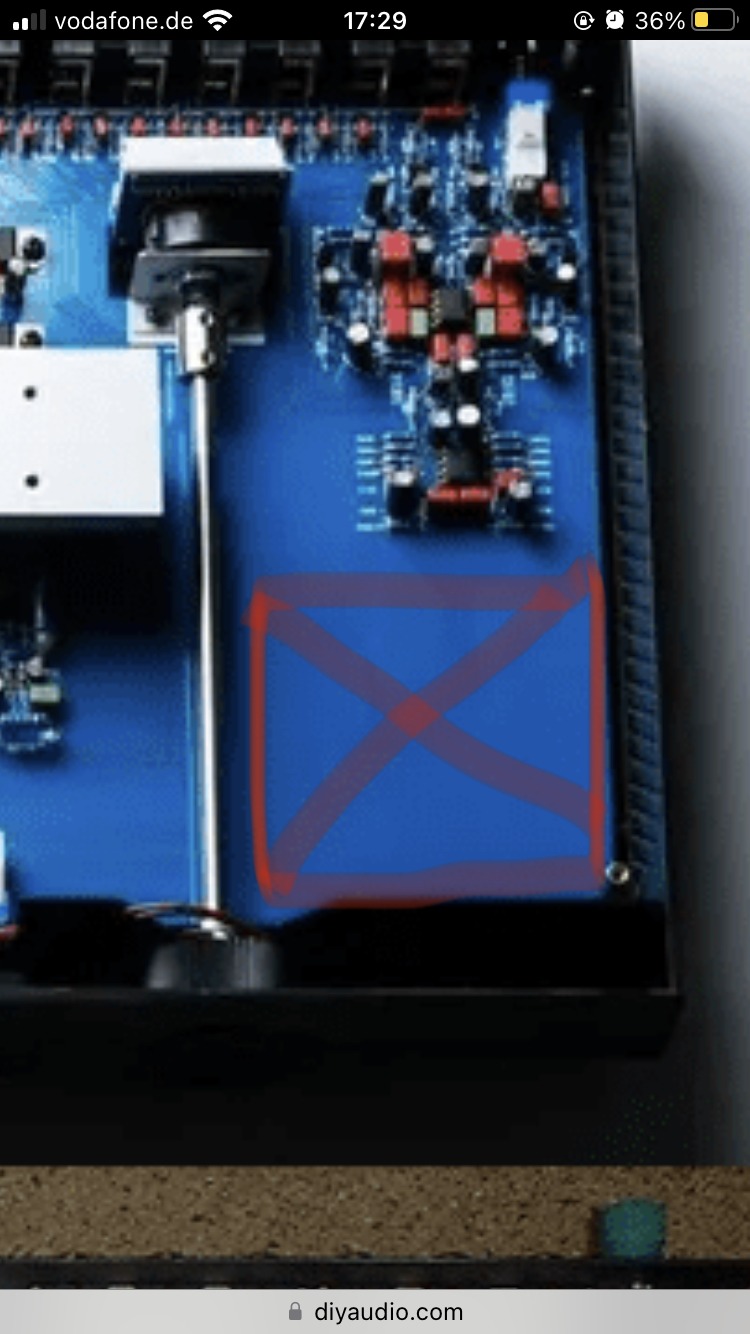

There are no ventilation holes in the PCB either. Not enough slots/holes/space/air flow around the bulk caps so heat buildup. Also no Schottky rectifiers. Caps mounted too close to the heatsink and power resistors. Basic design errors easily avoided even by good willing amateur/DIY designers. We spend too much time on words, it is better left to enthusiasts.
There are (only) three small slots in front of and behind the aluminum T-heatsinkholder /lid. Take a look at the detailed pictures in full screen, then you can see quite a lot.There are no ventilation holes in the PCB either. Also no Schottky rectifiers.

Side by side comparision of construction. Old one had somewhat more open space and bottom slots below transformer and heatsink looks like bigger in size.
The T bar is larger but the question is if the heatsink itself is larger/smaller with larger/smaller cooling fins. In the right lower corner there could have been an air inlet possibly with an ultrasilent fan.
