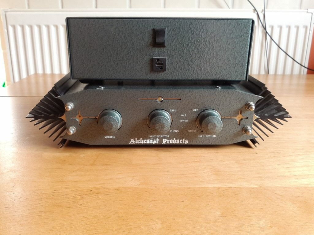

We should not spend too many words on the ancestor in this thread, but first get a comprehensive picture of the current situation and circuit. The considerably higher operating voltage alone, in conjunction with the (I'll just say this now, even if it's not entirely correct) level shifter for the TIP35/36, must have resulted in changes to the component dimensioning. At the same time, the parallel voltage regulator (shunt) of the TL084 of that time seems to have been replaced by fixed-voltage regulators ..! A µC and motor potentiometer inserted.

The Hammerschlag-Lack and Hutmutter both are pretty retro but the fuse holder on the front cover is a big nono! What about the heatsink fins orientation and the wrongly placed feet?! Probably built while the alchemist was brewing and consuming a heavy potion.
The styling is genius and the only reason I want one 🙂 I'm not surprised that German is not thrilled with an obvious lack of purity of that design ha ha ..
The top box is a separate PSU which normally is placed elsewhere.

Maybe I was a bit too restrained, but I like the sound of the new Flounder - I am not dissatisfied with it. After two days at the latest, my hearing got used to the enriched sound. What remains is the knowledge of the sound spectrum and behavior of the heating plate. So you don't necessarily have to reach for a soldering iron and other tools to be happy with the new one.
Only the stupid, super-bright blue LEDs are a nogo. The PowerOn illumination simply destroys everything. It will soon be the first to go.

My apology. After glowing reviews of MF A1 from vintage forums I was about to buy one in need of repair. Only to learn that the bloody thing is almost impossible to repair and maintain.
Usually they aren’t difficult to repair or maintain. They run hot and eventually the heatsink compound dries out, but you can clean and redo it every 5 yrs or so. If you are worried about the heat, a low noise fan placed on top of the heatsink works wonders.

Yes, of course you know to apply a thin layer. Still the way things are done and the large area makes things messy quickly.
They are dogs to repair as many laymen accept errors and wait. When it breaks down “catastrophic style” (usual way) many things will need attention and/or replacement. Source switch and volume potentiometer, all large caps, power transistors…. Woofers… This every 5 years when one is lucky.
Quite a few Chinese class D amplifiers are more reliable, cheaper, sound very good and they usually don’t eat woofers 😀
