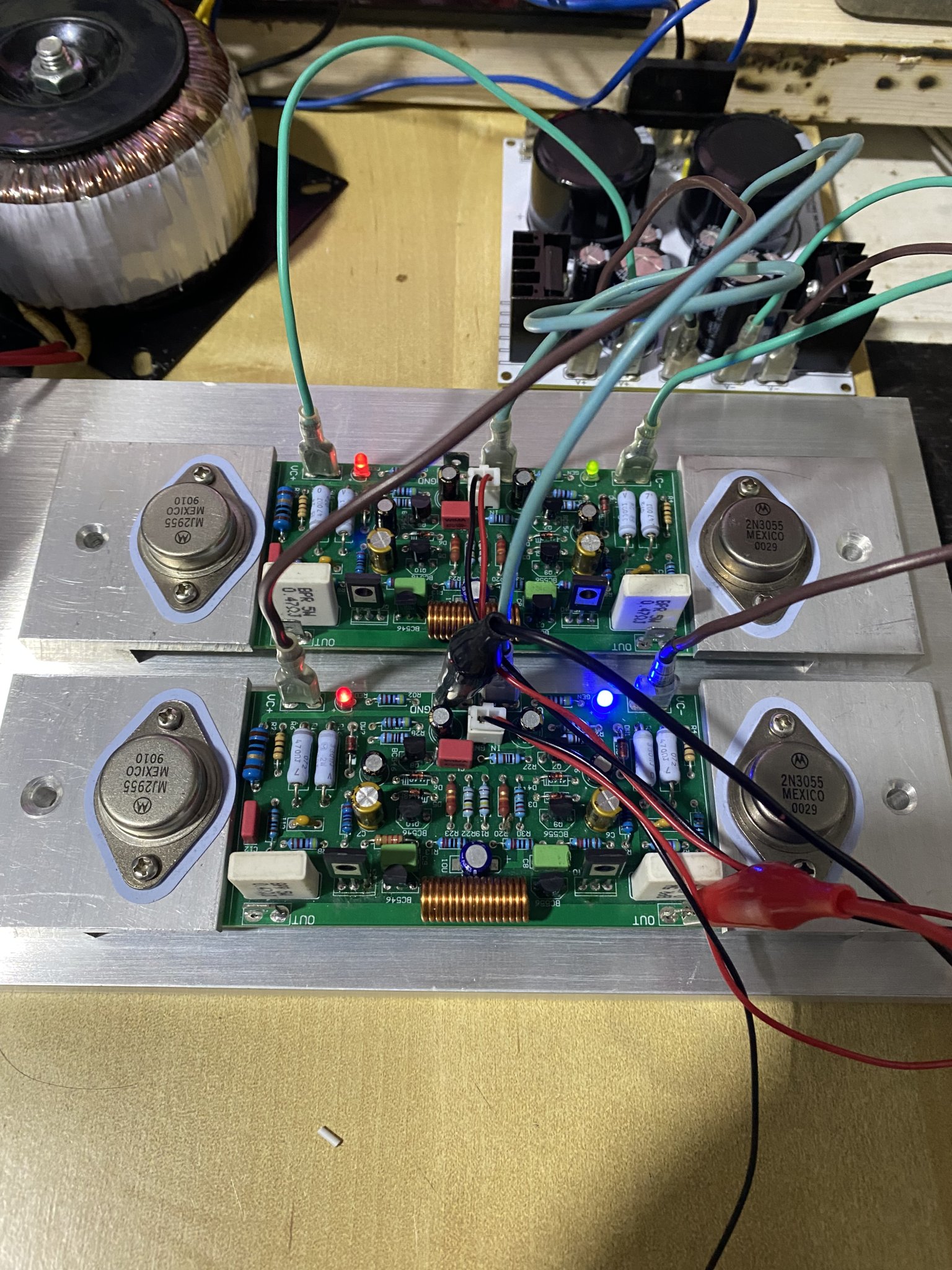

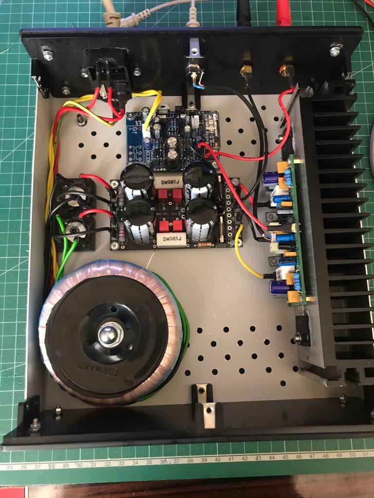

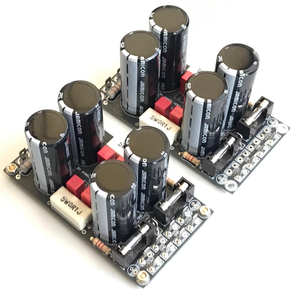

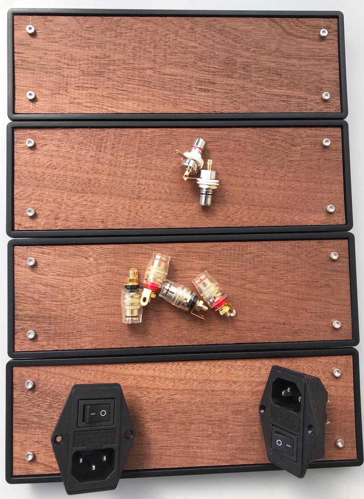

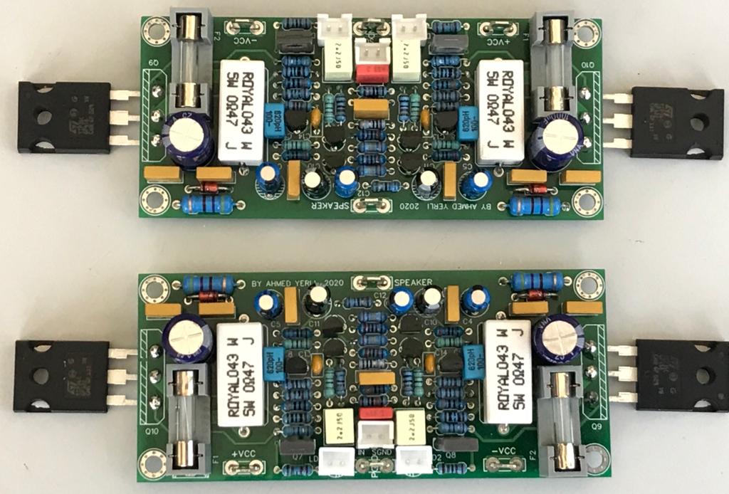

This is my A1 project. I love your voice very, very much.

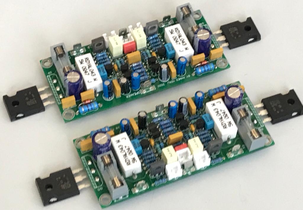

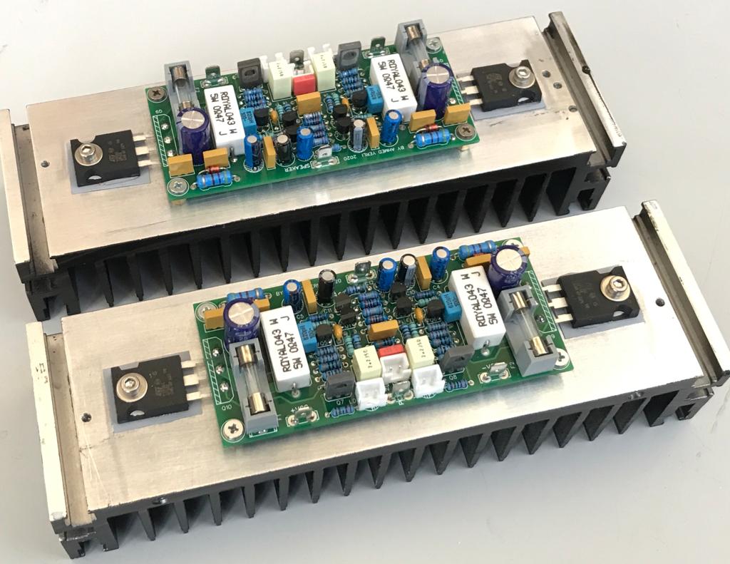

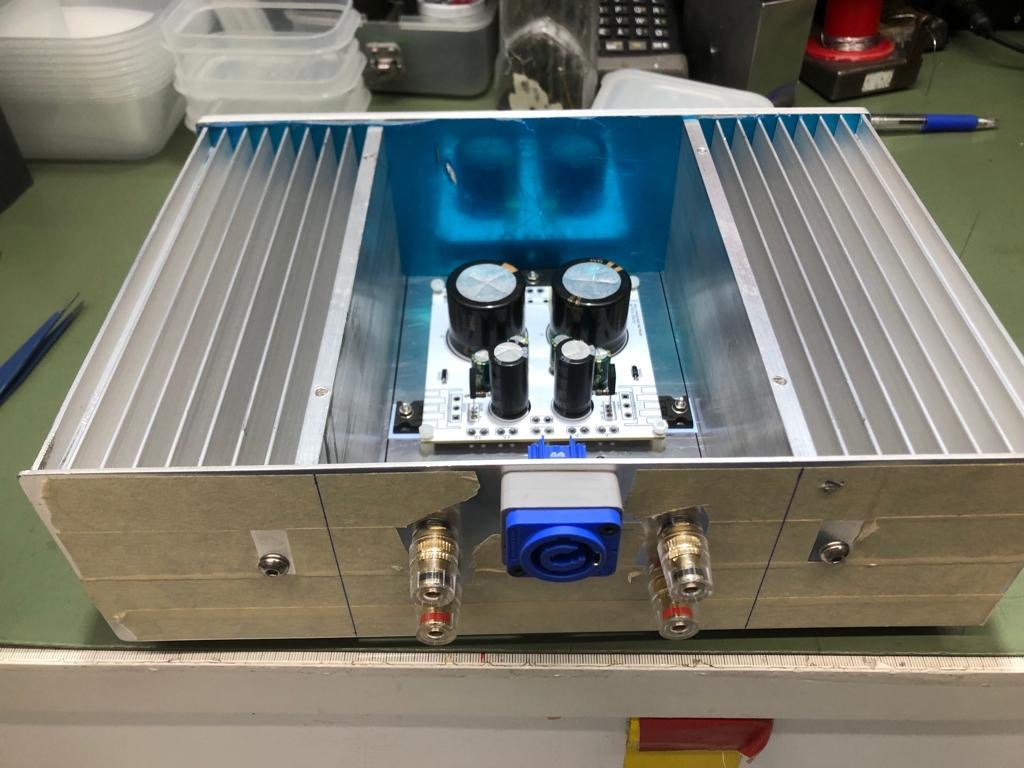

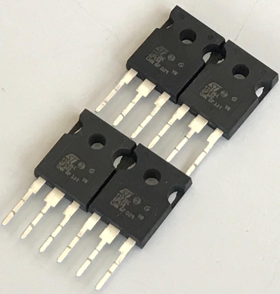

Hi Greetings from Indonesia,
this is my MF-A1.
the final transistor I use MJ2955/2N3055 and TR input BC556/546 & driver ON ML340G/350G
@R30/31 if 0.22R =1.5A run class-A 18W. @R30/31 if 0.47R run class-AB 20W.
PSU capacitance Multiplier
(Heatsink minimal 1kg per Channel Class-A)🥵🥵🥵🥵
Happy diy
this is my MF-A1.
Happy diy
