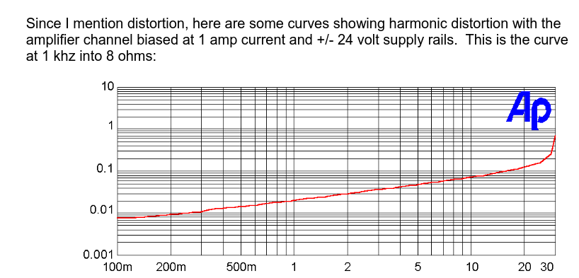

quite simple ,with 18Vac x 2 and 1A di bias you can have ALL 25W in ClassA as in F5m

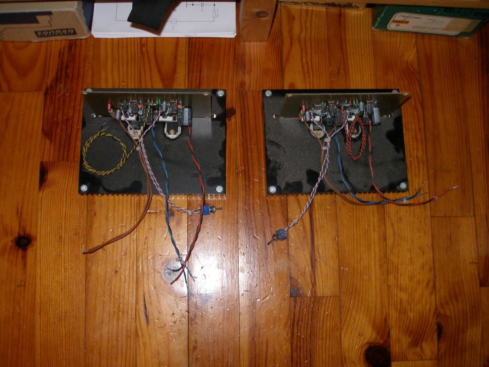

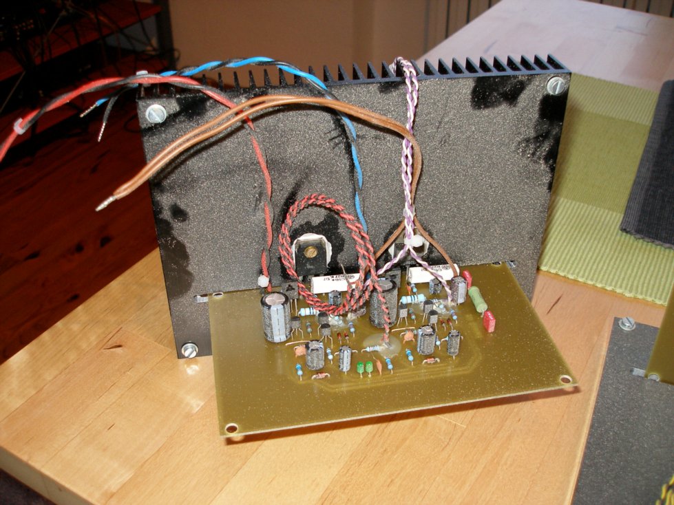

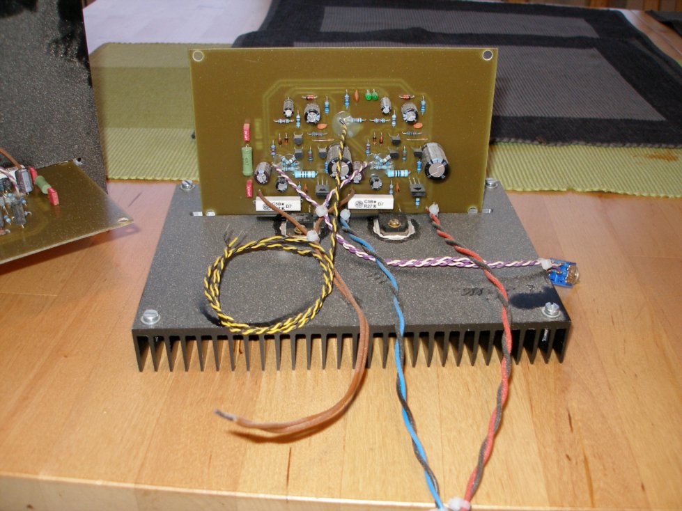

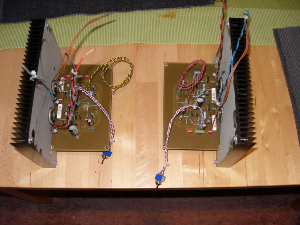

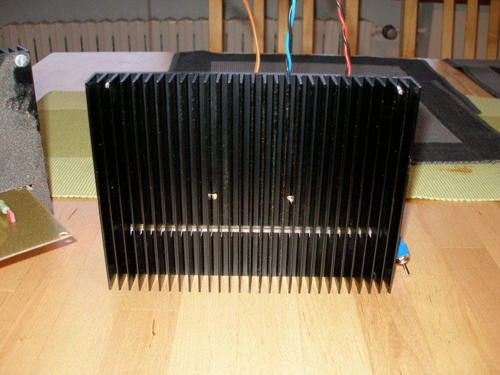

An A1 that barely gets warm to the touch (when in use, of course) can be seen in the attached photos. Unfortunately, I gave away these two modules and even a complete stereo amplifier (my personal version of the A1) 8 years ago - and currently no longer have access to these two incarnations.
The dust comes from our basement, where a few sins still lie dormant on the shelf.

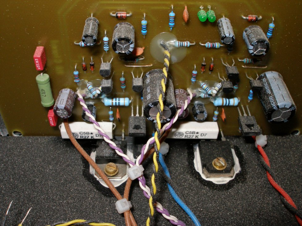

The toggle switch enables a reduction in the AC gain factor and increases the value /amount of the negative feedback.
The 2mm low-current green LEDs prevent the second thermal breakdown; as simple limiters in combination with the band-limiting input filter and the 3k3 seriesresistor, they ensure that the A1 is no longer driven to the rail limit and thus immediately destroyed. They limit gently, round off nicely and, above all, are absolutely symmetrical. No further protective measures are required - the woofer cannot seize up. No pop, no plop... all without an output relay. Absolutely reliable, always safe to use!
I only use TIP2955 & TIP3055 from TI & ST. Unfortunately, my stock is slowly running out, but for me personally, it will be more than enough to last while I wait for the Grim Reaper to come and pick me up.
