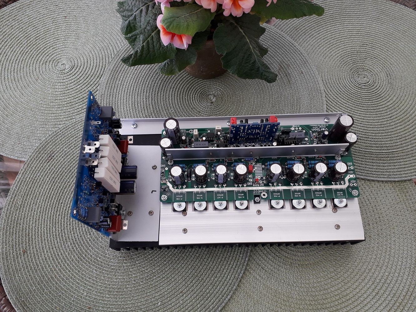

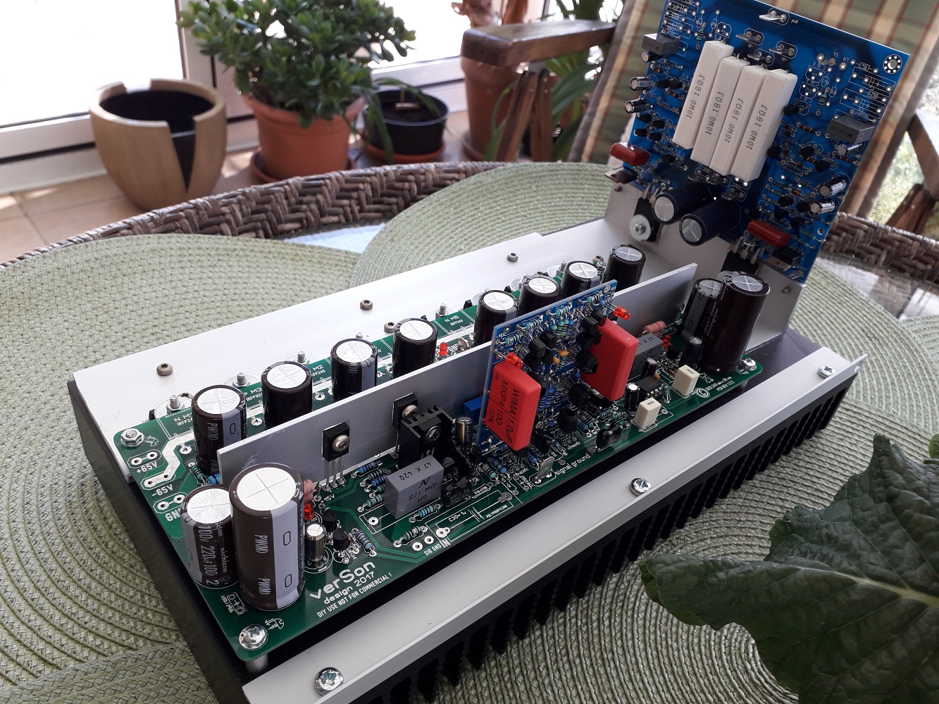

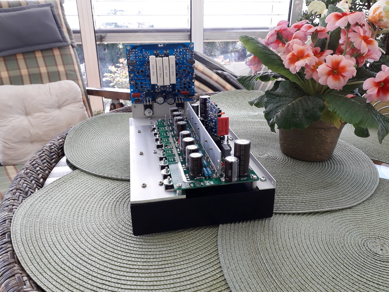

2oz Cu on 200W CFA and PS regulator boards. There are screening masks on high current lines where is possible to solder additional current reinforcements (wire).
One channel 200W balanced inputs + PS regulator
One channel 200W balanced inputs + PS regulator. Example how is possible to mount the bords on the heatsink.

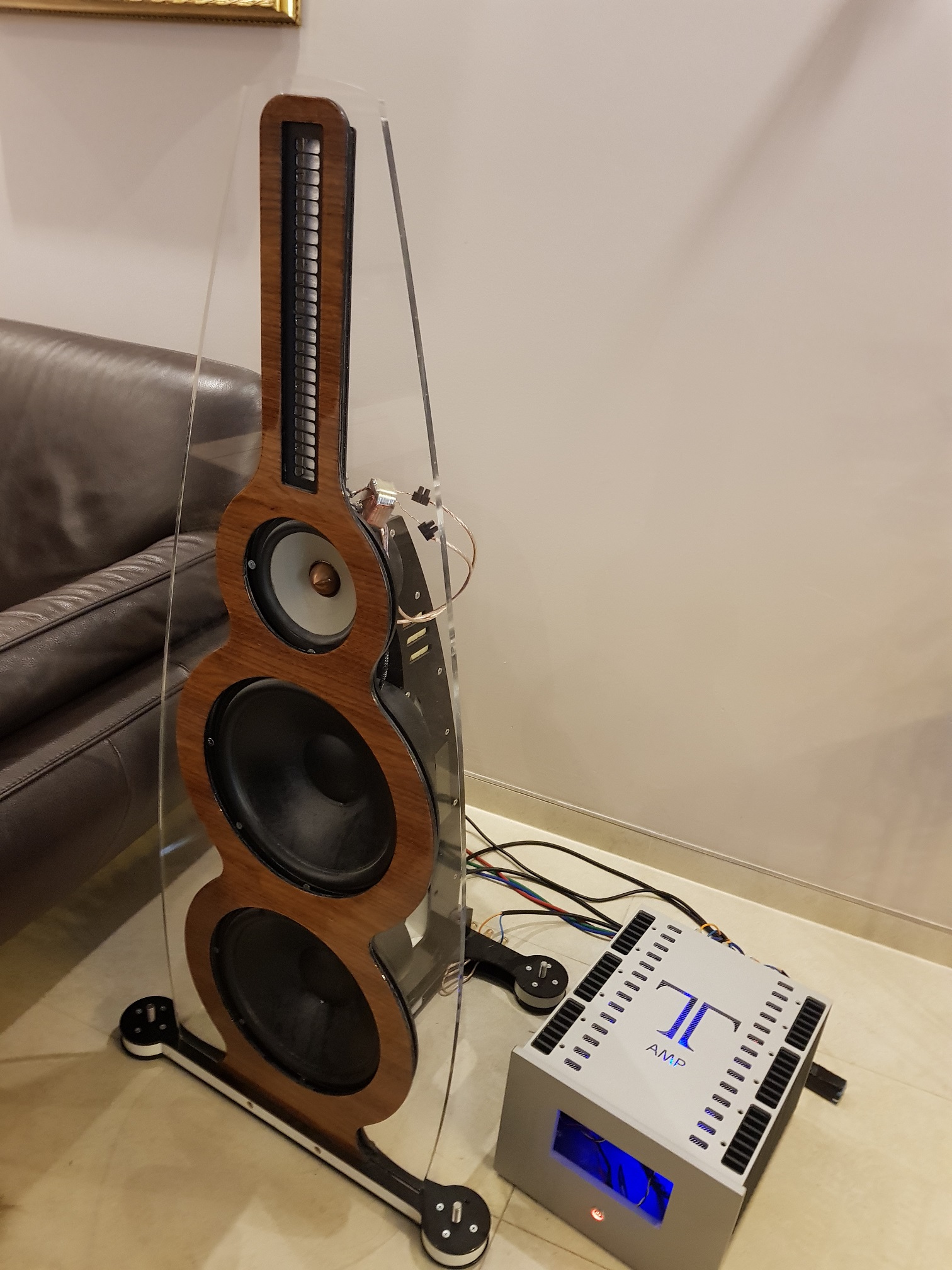

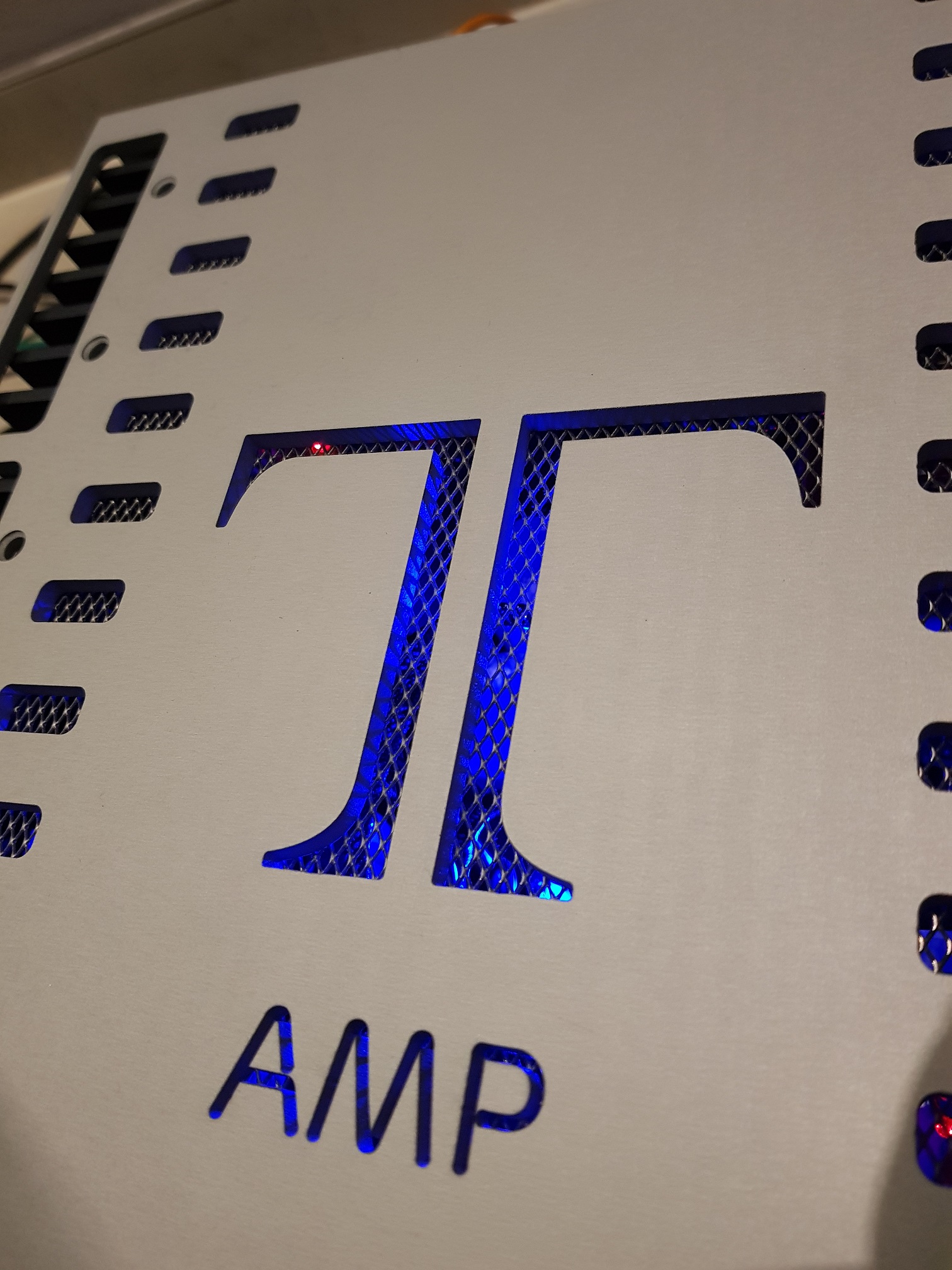

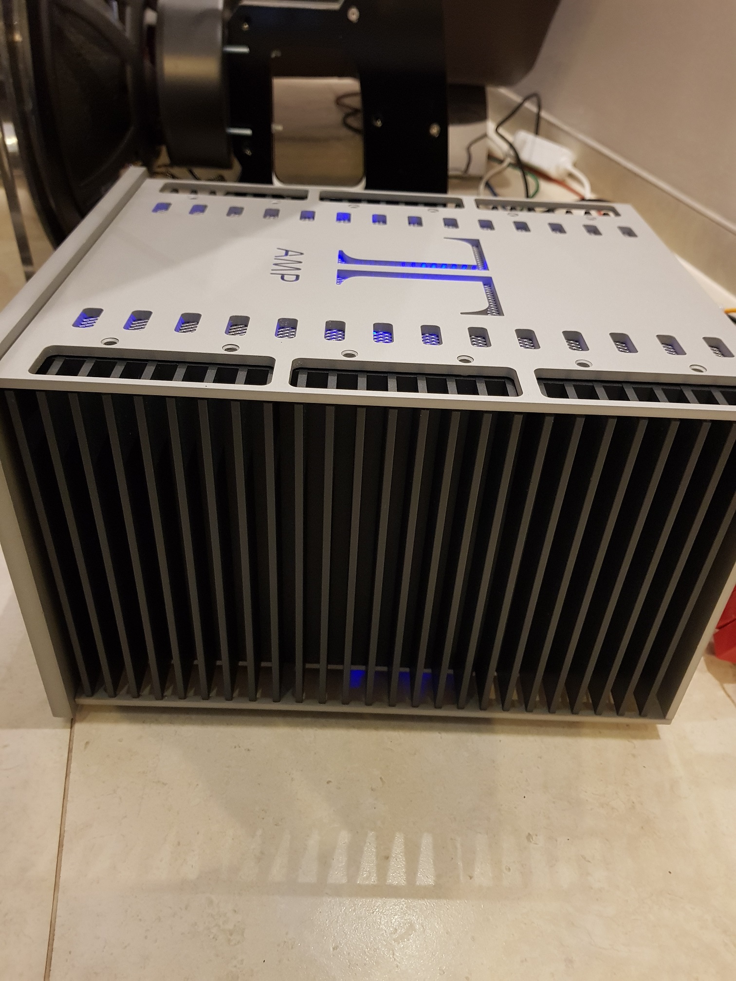

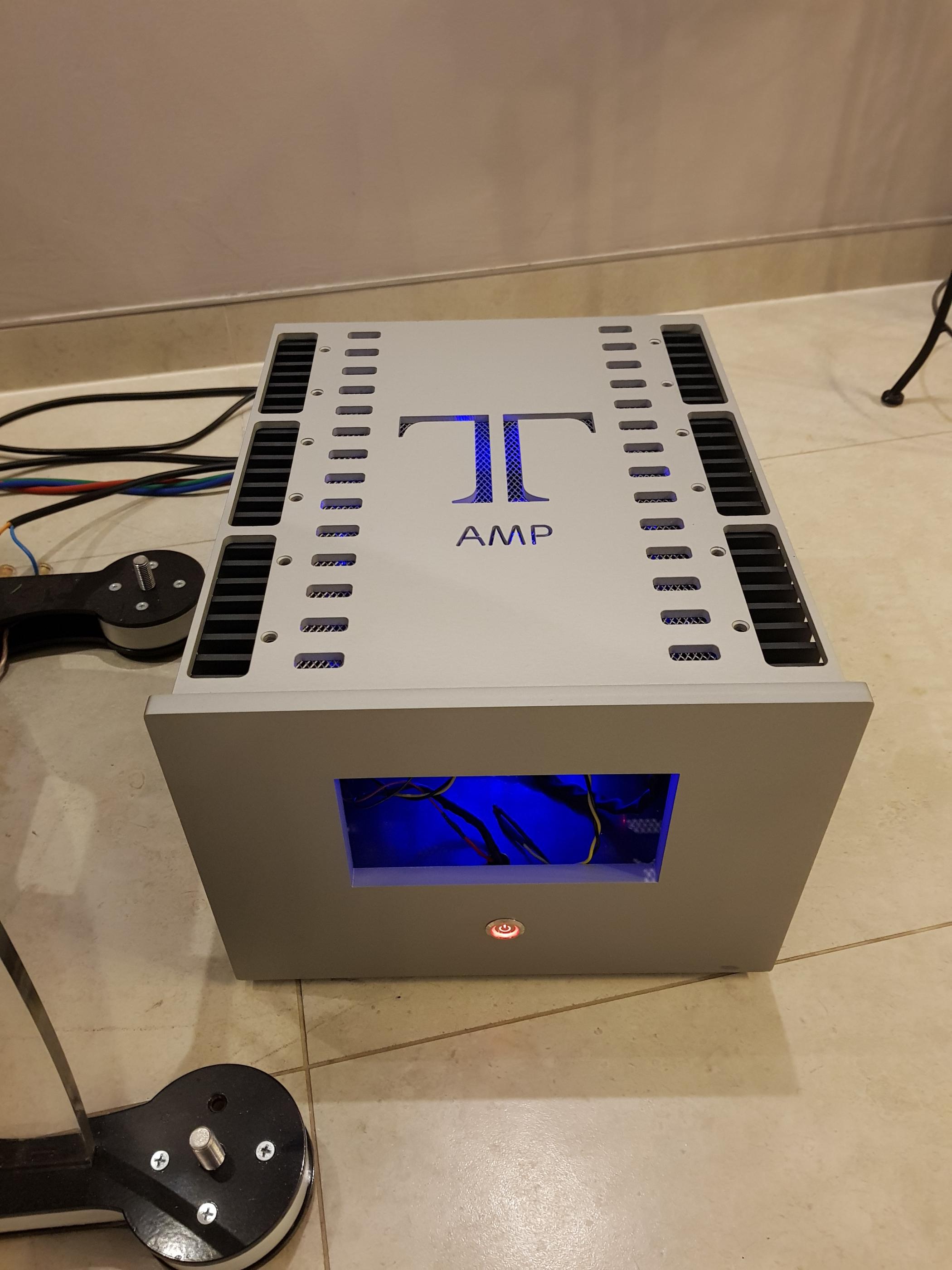

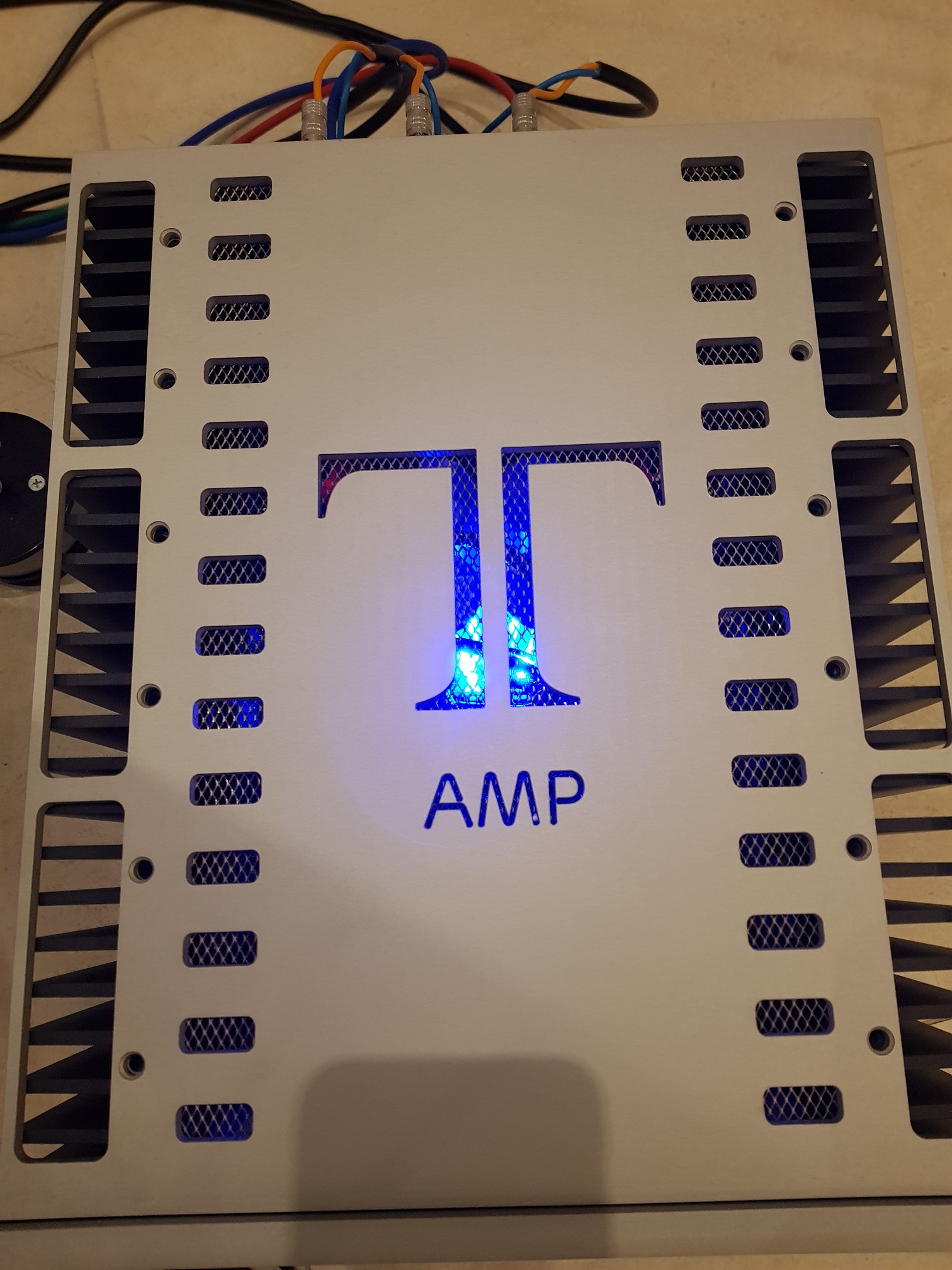

Here is my DIY packaging of your great SOTA power amplifier design. We had trouble finding blue LED source with consistent and even light output. Think they nailed it now.
Two, two-channel amps are needed for Bi-Amp'ed JBL M2 system.
Chassis is all CNC milled parts.... top, bottom, front, back.

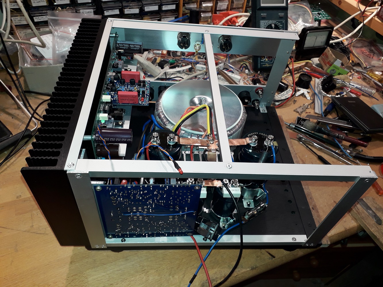

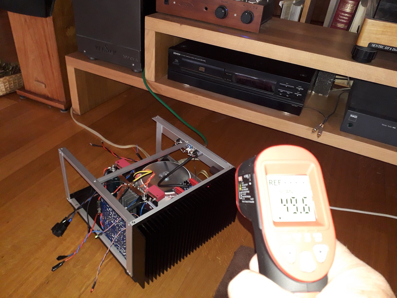

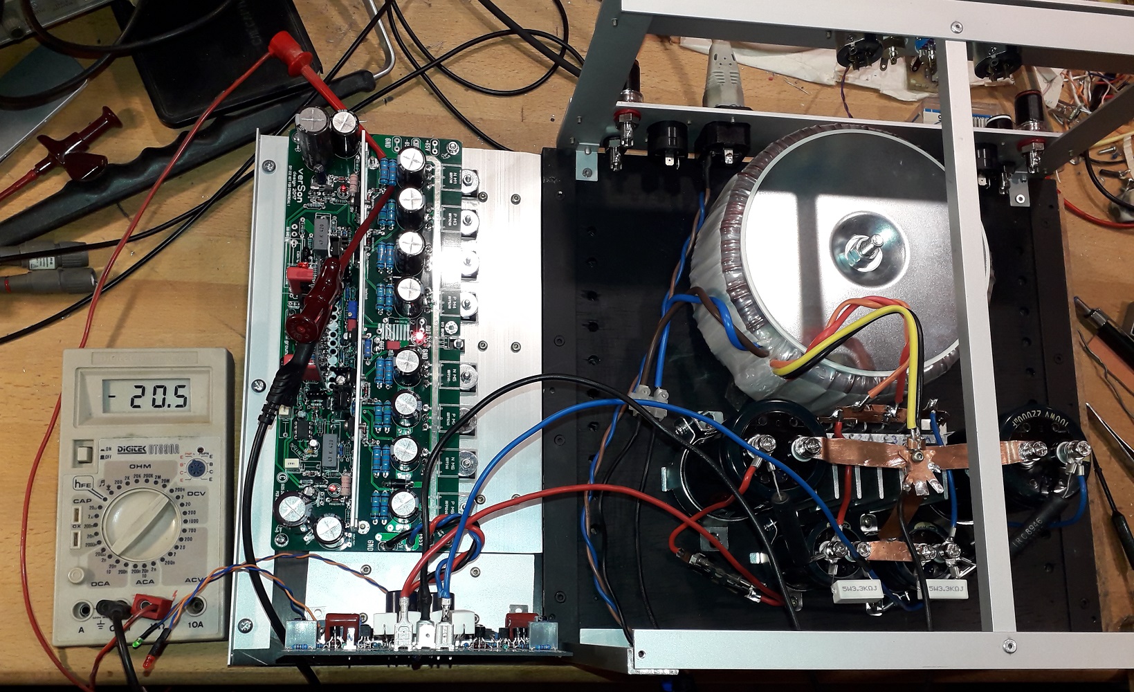

This is 200W amp on its way to the finish state. The photos show the bias setting. I used temporary power cabling to have one by one channel out of the box during bias setting and later fix it to the box sides.

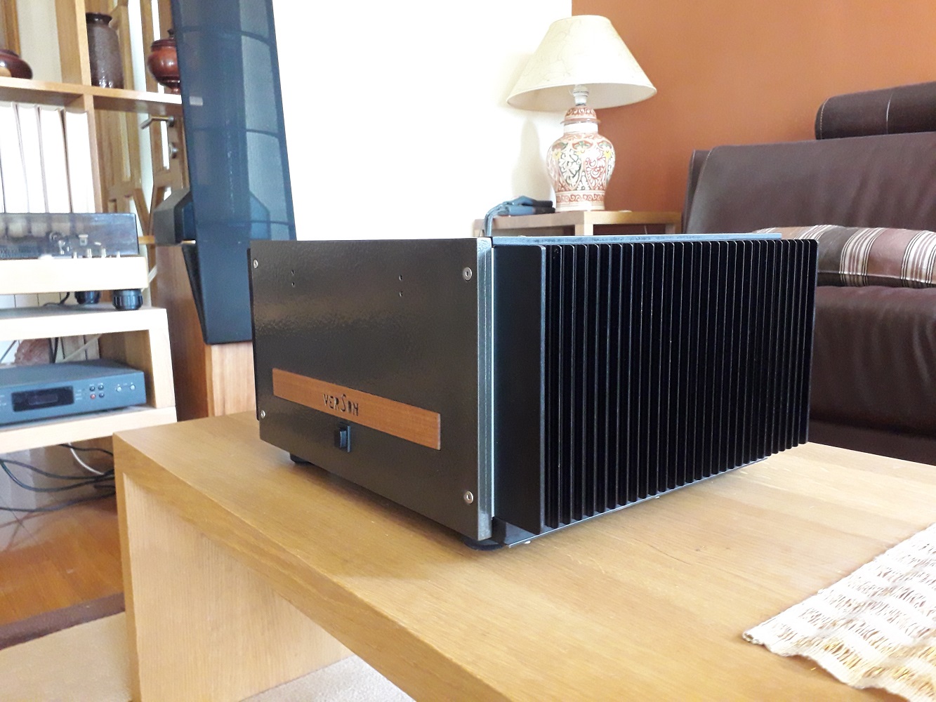

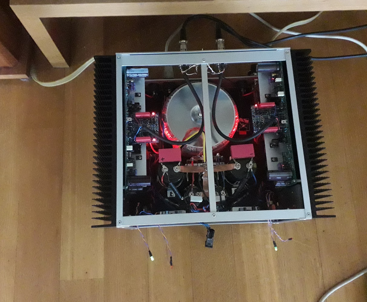

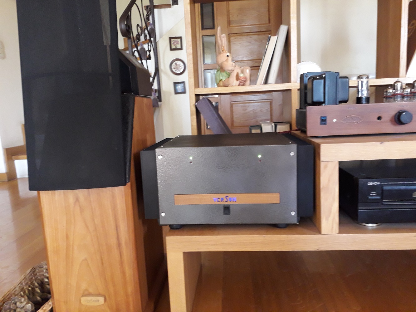

200W CFA -, now VFA, plays
Today I connected 200W amp via balanced inputs to the Benchmark DAC2 and played flac files from my laptop PC.
All is working flawlessly and I am very satisfied with the sound, now expecting results from others who bought the boards.
