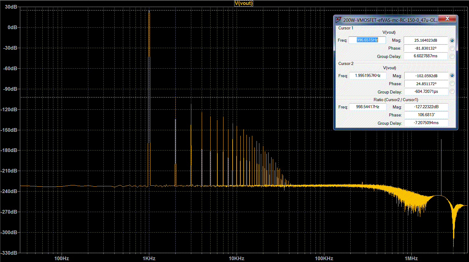

I made a sim of this amp today, and cannot even believe in what I had seen.
Flat loop gain in all the audible bandwidth, Incredible low distortions, with no hf components, better than a class A. (see attached), rock stable. As far i had seen, the only little flaw is the clipping behavior. But who want to clip an hifi amp ?
May-be a good idea should be to add some diode limiter at the input to avoid this situation or a clipping indicator ?

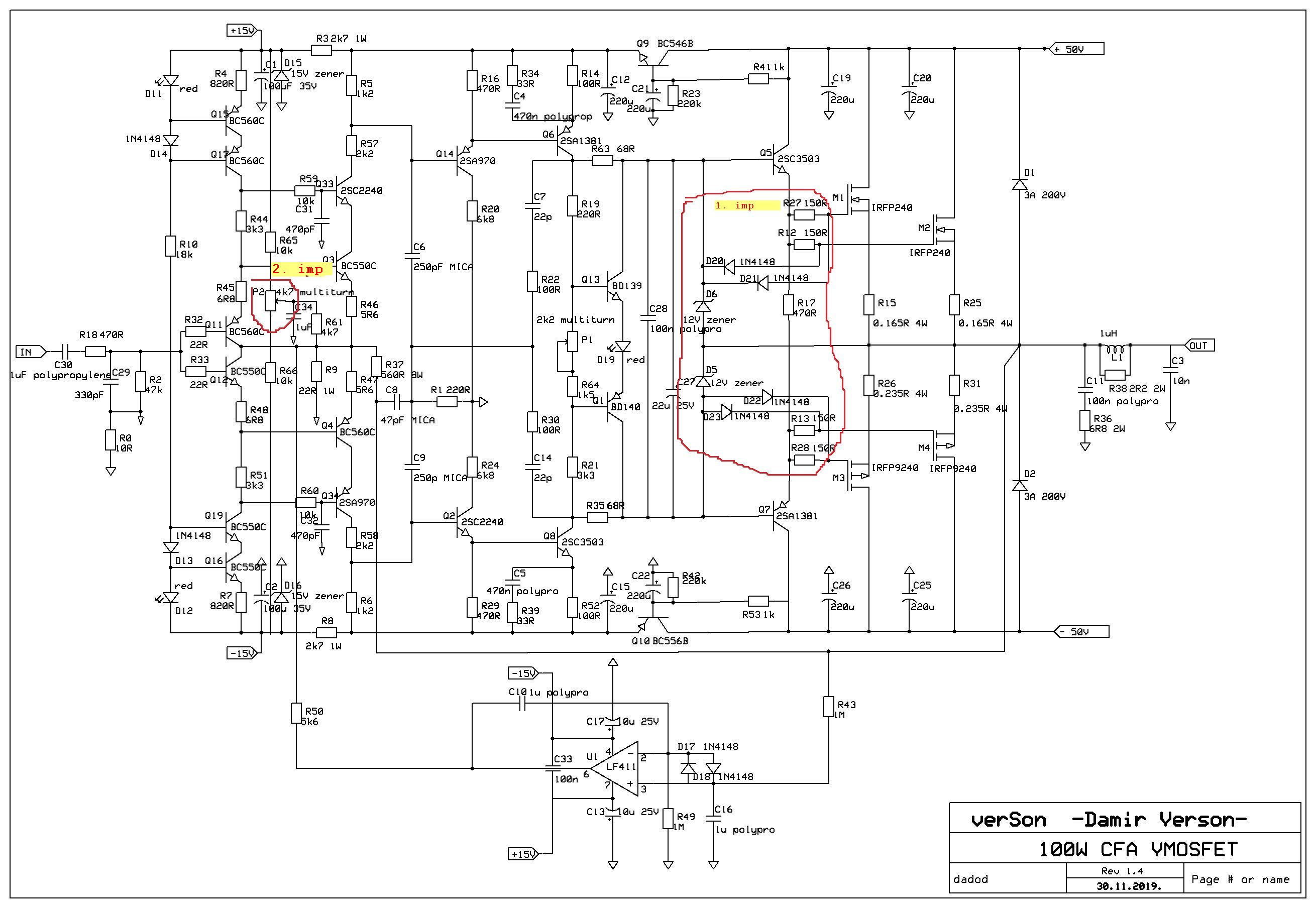

I'm stuck with the input stage. Unless using severely VBE matched devices, problems to be expected. And if we degenerate the second stage of the diamond, all the sand castle collapses. :-(
Diamond inputs and caccocoded VAS are not loving each others ;-(

Dadod, I tried your compensation, the cap paralleled with the VAS emitter resistance, in my case, cascoded. No way.
Amusing it oscillate at the class A->AB transition point of the signal. Like a marker.

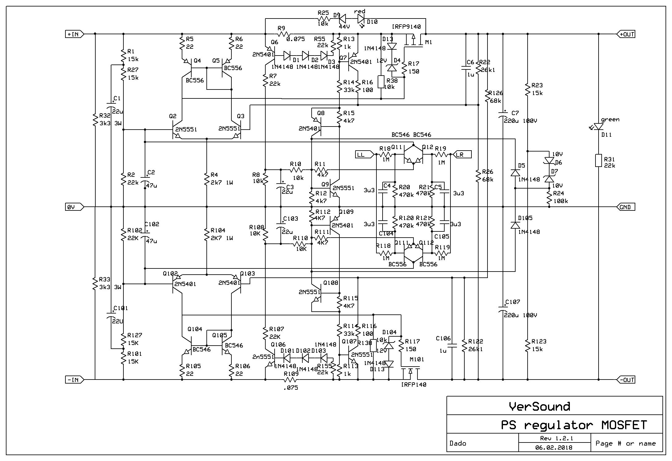

I used mosfet PSregulator in my 200CFA amp I built for me. It looked OK, playing music nicely, but one day I was intrigued by possibility that LDO regulator can easily oscillate and I checked PS regulator output with an oscilloscope and, oh horror, there was small level oscillation, about 0.2 V of very high frequency (30 to 50 MHz).
I tried different compensation but with no success. Finally I removed the drivers (when I designed it my intention was to provide enough drive for the output mosfet).
Simulation did not show any oscillation, but in real PS regulator that was solution. Now I use it in the same amp with no problem.
Attached PS regulator oscillating schematic and corrected one too.
It’s quite easy to correct existing regulator:
Remove Q1 , Q101, R3 , R103, C8 and C108.
Change R4 and R104 from 4k7 to 2k7 1W metal film resistors
Put the jumpers instead Q1 and Q101 between Base and Emitter positions on the board.

Did you simulate with square wave current load?
I simulated with square current load, not exactly square wave and all looked OK. The oscillation was visible even without any signal/load in real amp.

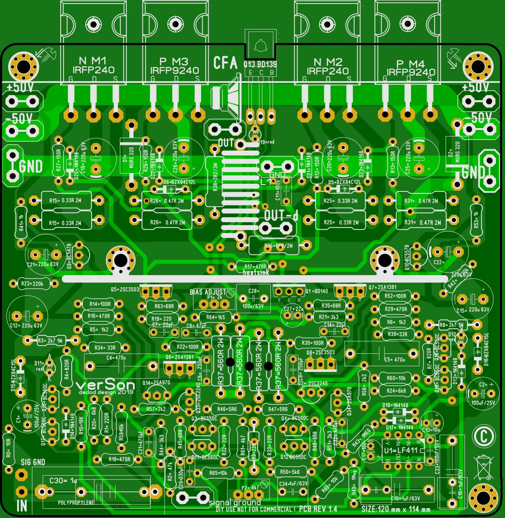

I've been asked for 100W CFA version PCB but I don't have any spare left.
If there more interest for those PCBs I can order new set of boards, so please put your PCB numbers here, as I need to order minimum 10 boards to keep the price reasonable.
There some layout improvements, and some functional improvements too, but the amp stays the same in principle.
The layout improvement is in the feedback resistors (R37), now contains two 2W in parallel and then in series with next two 2W resistors in parallel, in difference with previous version - four 2W resistor in parallel. In this case resistor voltage distortion lowers.
First functional difference is better output mosfets protection, and second is manual DC offset trim. It can work in tandem with DC servo, or individually, manual or DC servo, depends how good was the transistors matching.
