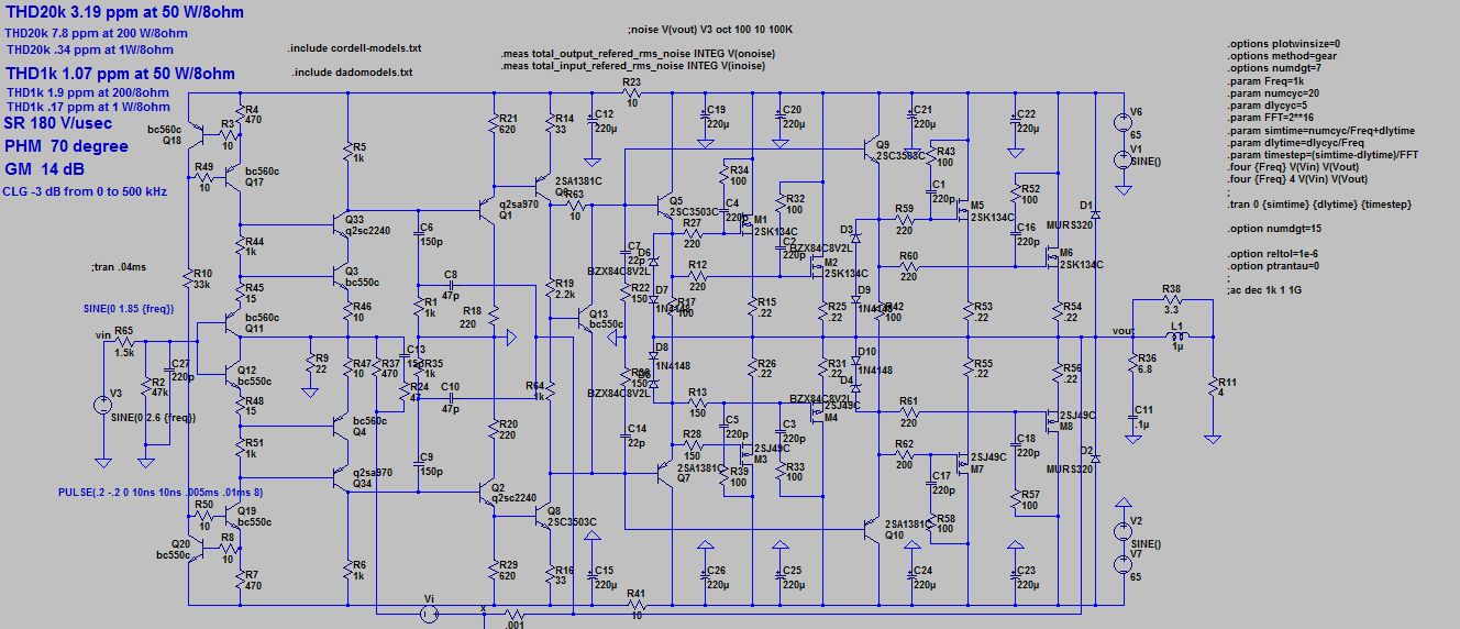

Some people are interested in more powerful CFA amp, and this is 200W//8ohm and 400W//4ohm.
It uses lateral MOSFET output transistors like Hitachi 2SK134/135 and 2SJ49/50 or similar from Toshiba 2SK1056 2SJ162 or from other producers.
Interestin part of this amp is use of TPC compensation, but unusual one with one capacitance branch connected to the output instead to the VAS collectors.
That brings 20kHz distortion down significantly.
This thread is open to discussion and suggestions as it’s tried in simulation only.

Maybe add diode clamps across the VAS/TIS to clean up the clipping. Looks like saturation.
Do you need a Vbe multiplier with L-FETs? Maybe simple resistor biasing would work.

This is typical TPC clipping, but here is no sticking, and the amp is going fast out of clipping.
Still I will try to find good way to make clean clipping, not sure what is the best way.
The Vbe multiplier is here to simplify Bias adjustement no for thermal control, as simple trimer can lose conntact and could provoke the bias go to high and burn mosfet. In the Vbe the resistor between base and collector is a trim pot and if loses conntact the bias is going down(but you know that).
I am not yet sure if some thermal compesation is needed for the drivers.
Good point but a couple of resistors in series could be used instead of a trimmer in a simple resistive bias. L-Fets appear to be very easy to bias as you know. My preference is not to use a Vbe multiplier, I worry about the potential for oscillation. 🙂
Have you got a good source for the a1381/c3503 transistors where you can get the same Hfe Rank? Wonder if mismatched ranks would cause a problem when used as drivers?

Just a few questions/comments
R46/R47 not symmetrical?
No equivalent for R63 on negative side?
FET gate resistors...220R in positive side and 150R in negative side.
Output quiescent current not adjustable?

Thank you for participation here. Your knowledge about latfet is very wellcome and can help to deign better amp here. I know that it's posible to lower didtortion by omitting source resistors if someone can get good matching.
You got good eye.
R46/R47 are different to set DC offset at output to zero. Actually it will contain two 12 ohm resistors and 100 ohm trimer.
About need for R63(to compensate for bias current fluctuation) I am not sure do I need the same on negative side, I have to simulate more.
MOSFET gate resistors are of different value as N and P MOSFER are with different input capacitance.
R64 is a trimpot actually (2k) used to set the quiescent current.
Good distortion results and slew rate on your design dadod. I think this clearly demonstrates the role in a CFA that the feedback resistor plays in setting the amplifier gm - you are getting these good results because there is plenty of feedback at HF, but you are able to curtail it at HF with TPC and avoid running into phase shift problems due to the output stage - FET's no doubt allowing this as well.
Yes you've got it right Bonsai, this twist in TPC(connection to the output instead to the VAS collector) improve HF distortion a lot and with BJT's it did not work(for now).
