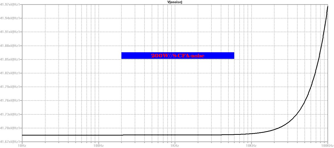

Can you add a noise sim to this (please 🙂).
Damir,
There is no difference in the noise between 200W//8ohm and 400W//4ohm.

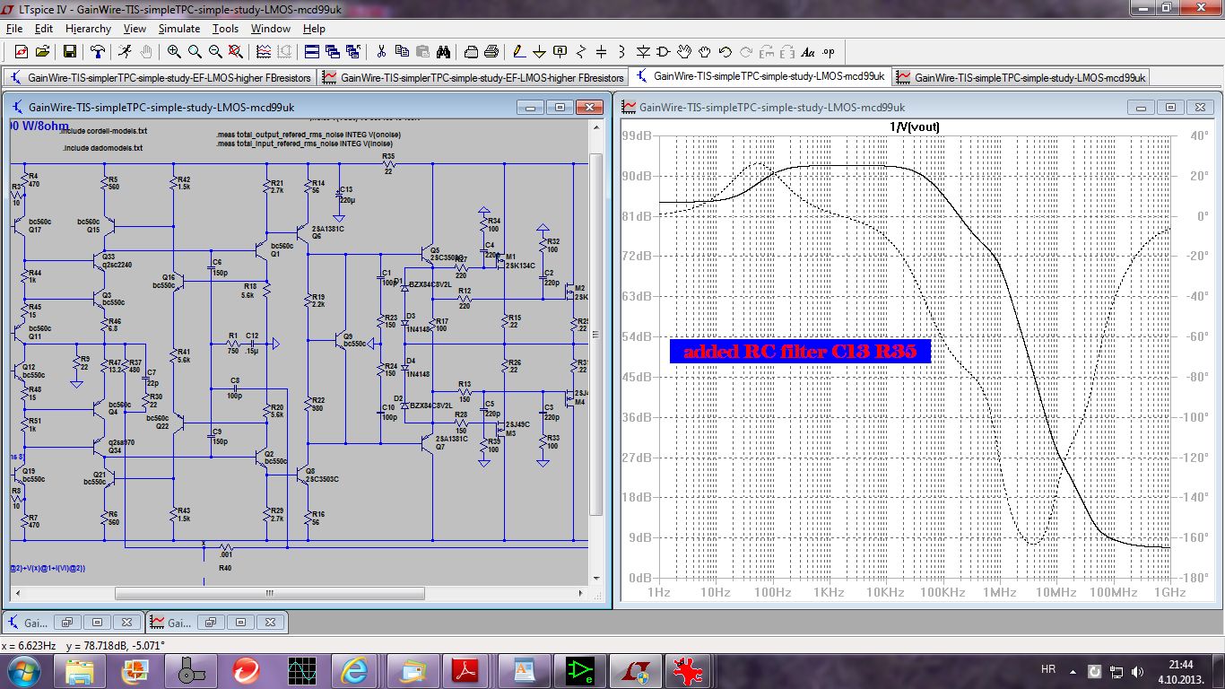

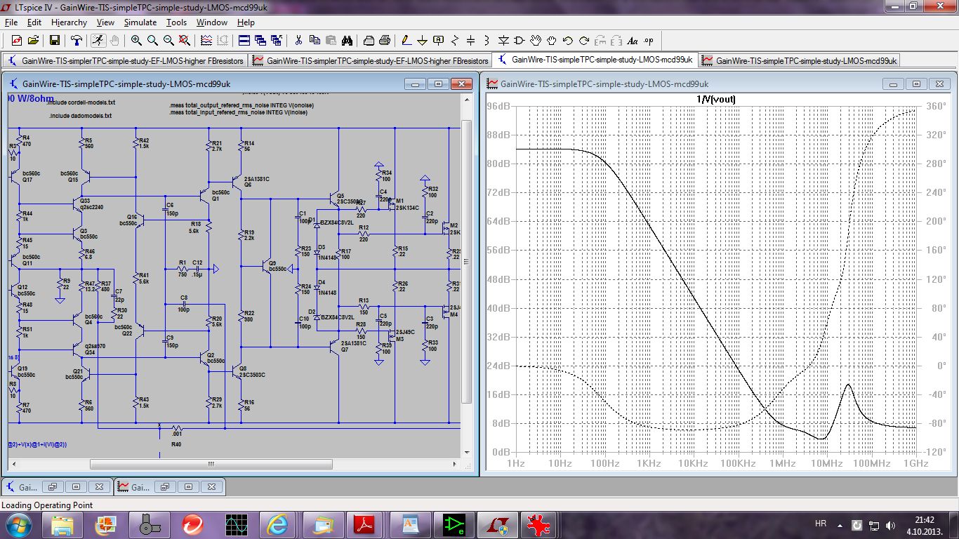

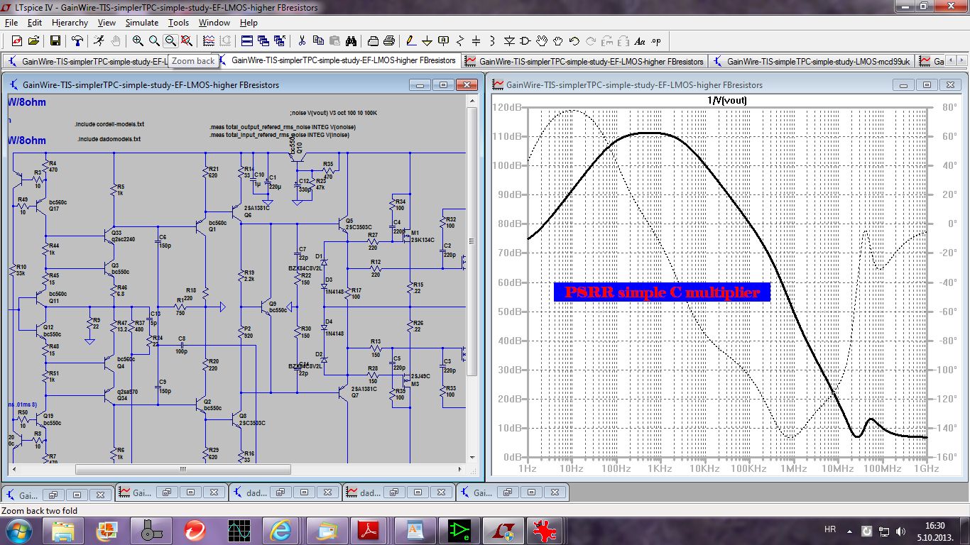

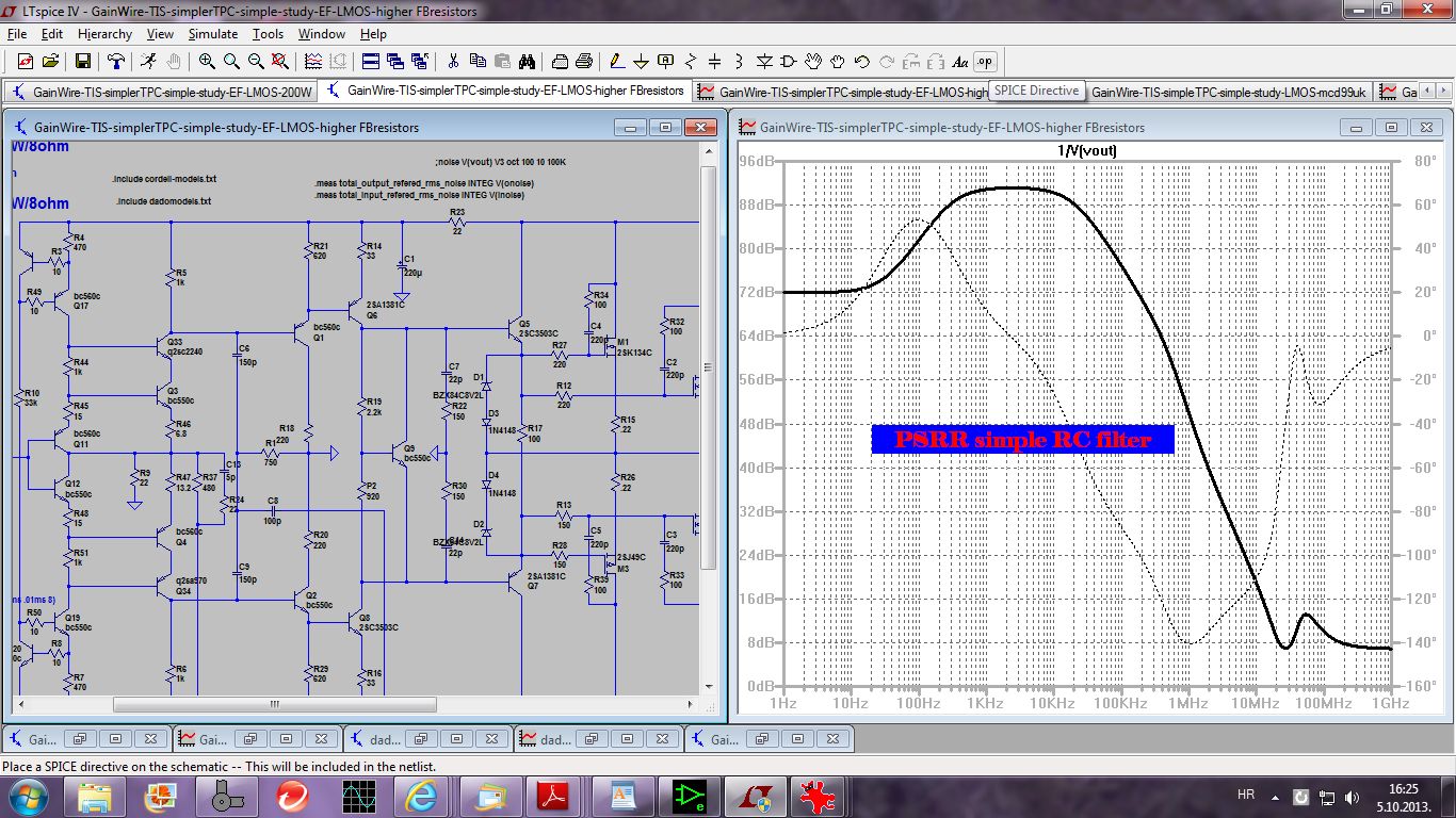

How good is PSRR for this amp and how could be improved in quite simple way. I simulated tree different cases, no any aditional power line filtering, simple RC filter for input stage only, and simple C multiplier for input stage. All this was simulated on + power line only, - line PSRR should show similar results.
BR Damir
BR Damir

You are a mind reader. last night I was thinking about asking you about PSRR.
Would you be able to do similar sims for the simpler (lower LG) version. It would be interesting to see how/if LG affects PSRR.
Paul

PSRR lower LG version.
Thank you. It shows some minor benefits to the added complexity for the higher LG version. Although these are only at low frequency.
The cap multiplier looks like a easy win. The complexity is minimal and the extra voltage drop could be countered by a small dual secondary transformer added to the main PSU transformer.
dadod, you need to use real world cap models to assess PSRR.
I used LTspice capacitance models, changed ESR and ESL and no any significant differences showed. Tell me what real world cap model you suggest?
JLH in his 80W mosfet amp used +-55V for OPS and +-50V for input stage not to saturate lateral mosfet when they go in very unlinear input capacitance(if I remember it correctly) so small voltage drop(1.2V) on the C multiplier is OK for me.
