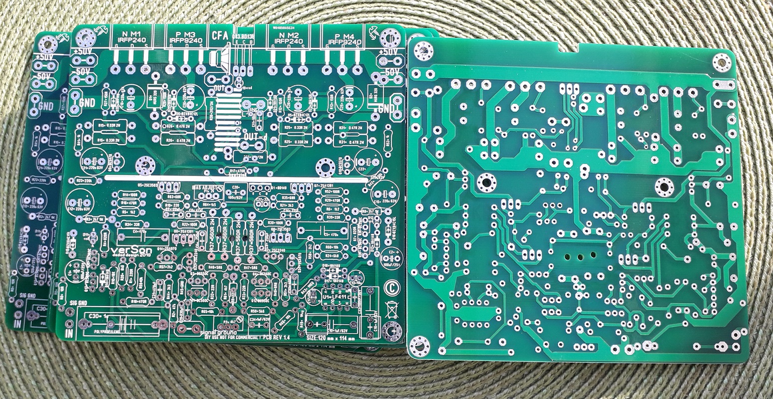

The boards are here.
Please PM to me your PayPal email address that I can send PayPal payment request, deps and fredlock missing.

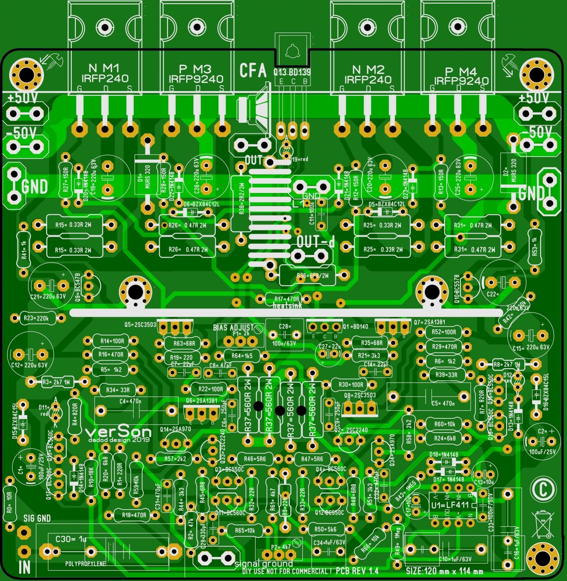

100W CFA

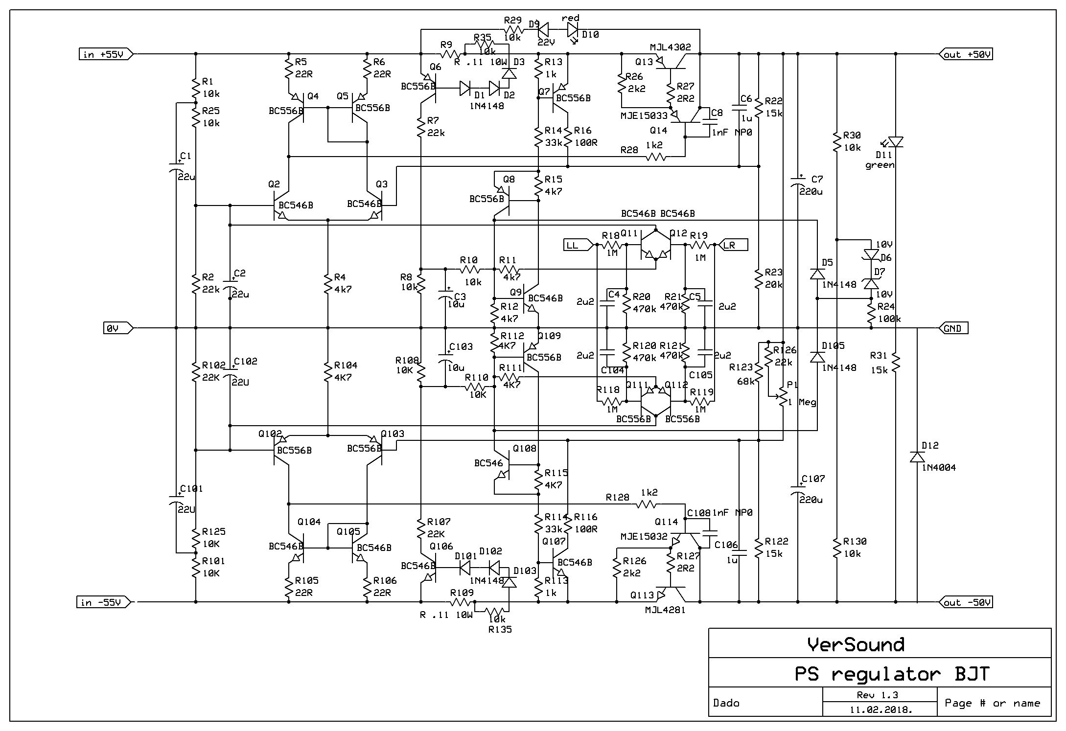

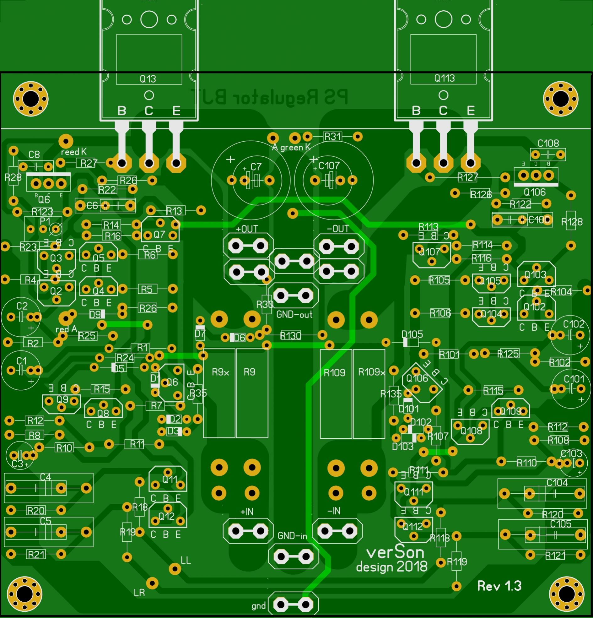

This is last revision of the 100W CFA. Attached amp schematic, PS regulator schematic, amp BOM, PS regulator BOM and layout photo of both boards.
One PS regulator could be used in an amp in stereo configuration, but if used in mono or dual mono skip half (do not mount) of loudspeaker DC voltage detection (Q12, Q112, C5, C105, R19, R21, R119, R121).
Damir
Damir

On the PS regulator, the speaker connection is not labelled, which I assume beside the Q12. I just have to trace it to make sure.
I mean Q11 and Q111. I know you're a busy guy but I wish you could have made a formal document on the build, so we don't have to go to the postings.
Yes it is, LR (loudspeaker left) LR (loudspeaker right).
Sorry LL (loudspeaker left)😱
