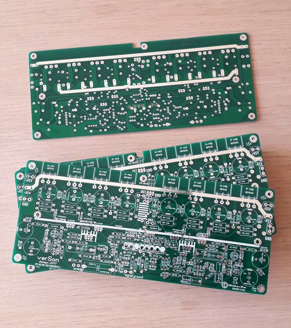

200W CFA and balanced boards are here, now I am waiting for PS regulator boards.
When all boards are here I will send PayPal money request to ones who ordered the boards.
Damir
