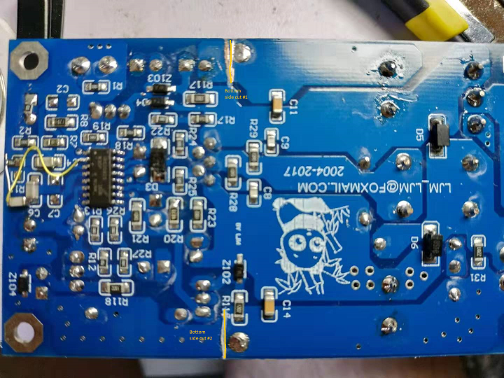

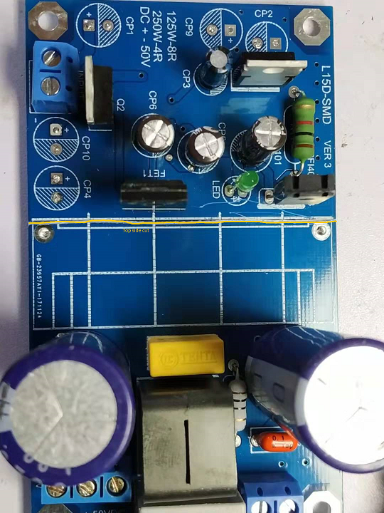

Groundfill cuts
This is what I did to the groundfill - I introduced a cut so that the large currents on the output side won't introduce any voltage drops across the signal side. Doing this necessitates cuts on both sides of the PCB - right across on the top side and through two wide 0V tracks on the bottom side.
Performing the cut on the top side means the heatsink has to be removed - unscrew the two mounting screws from the MOSFET and the temperature sensing transistor and then it can be desoldered - there are two pins into the PCB. The cut runs along the silkscreen marking for the heatsink just beyond the mounting pins.
I joined the two separated fill areas together with a wire between the output -ve and pin2 of the IRS2092.

@abraxalito Would you kindly explain briefly what are the benefits of such operation? Is it also relevant for the L-25D which I have? Also; Do you reckon that all L-xxD models sound the same. - I mean, that only difference is the output power?
Cheers!
Subjectively the combined mods - adding caps and separating the fill into two parts - have given a worthwhile reduction in the fatigue factor of listening. When I first fired up the amps they were a tad harsh in the HF but that's pretty much all disappeared now. I still get a little harshness at times but it seems that's on the recording itself rather than introduced by the amp.

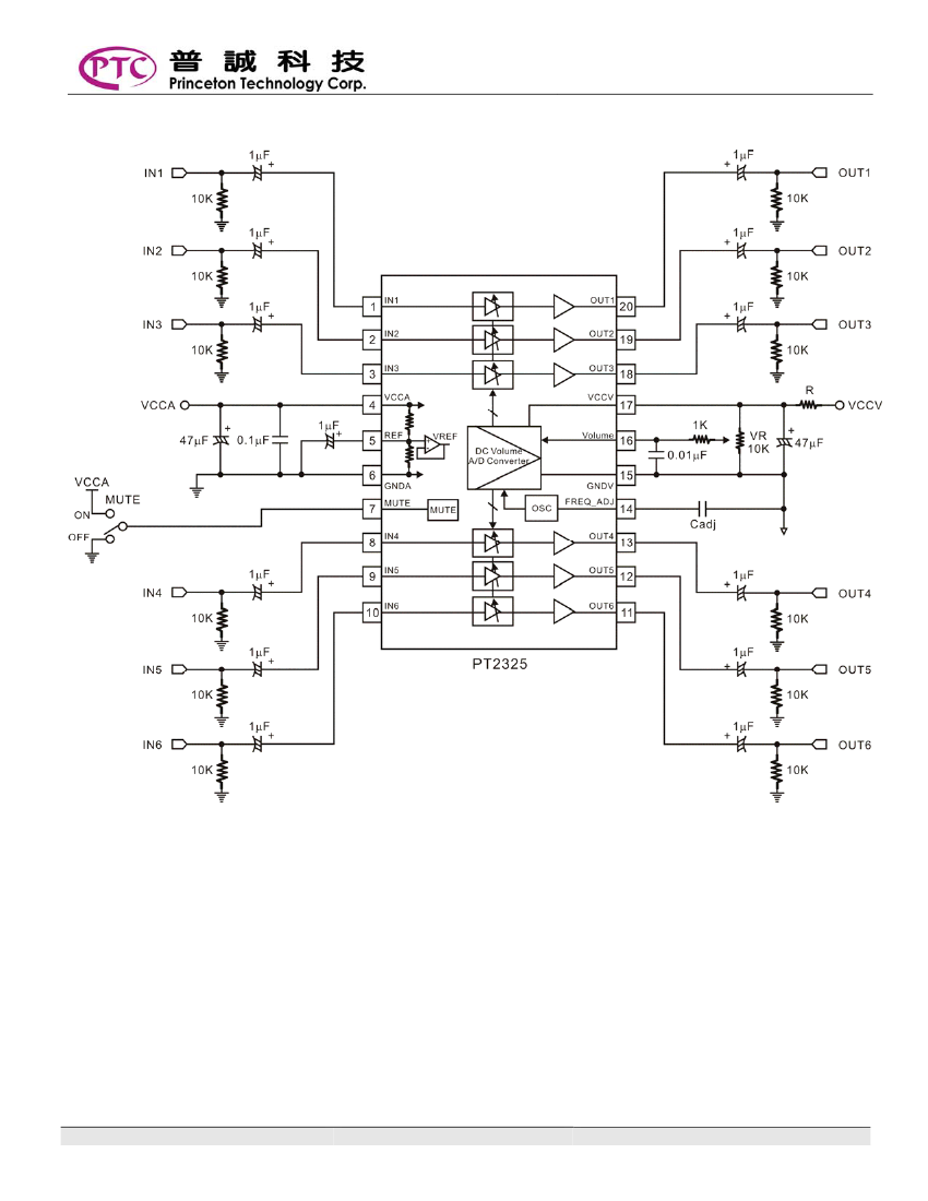

What do you think about PT2325 for volume control?
I plan to use PT2328 with WIMAs MKS2 1uF 63V 5%
On schematic one resistor and capacitor have no value.
Will 100R be good and 100nF ?
