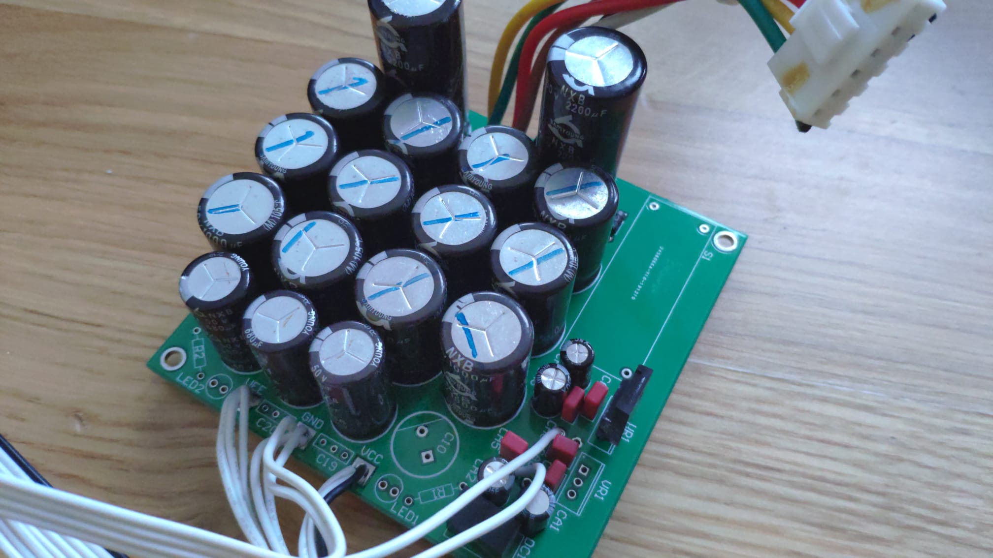

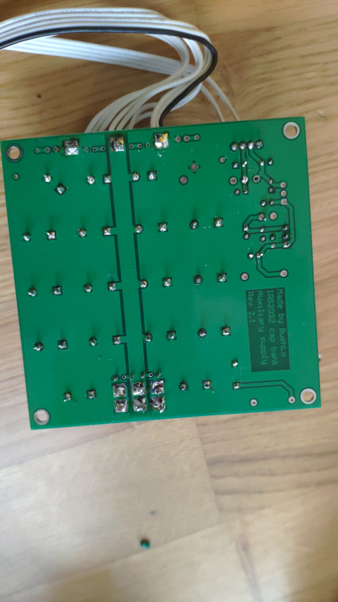

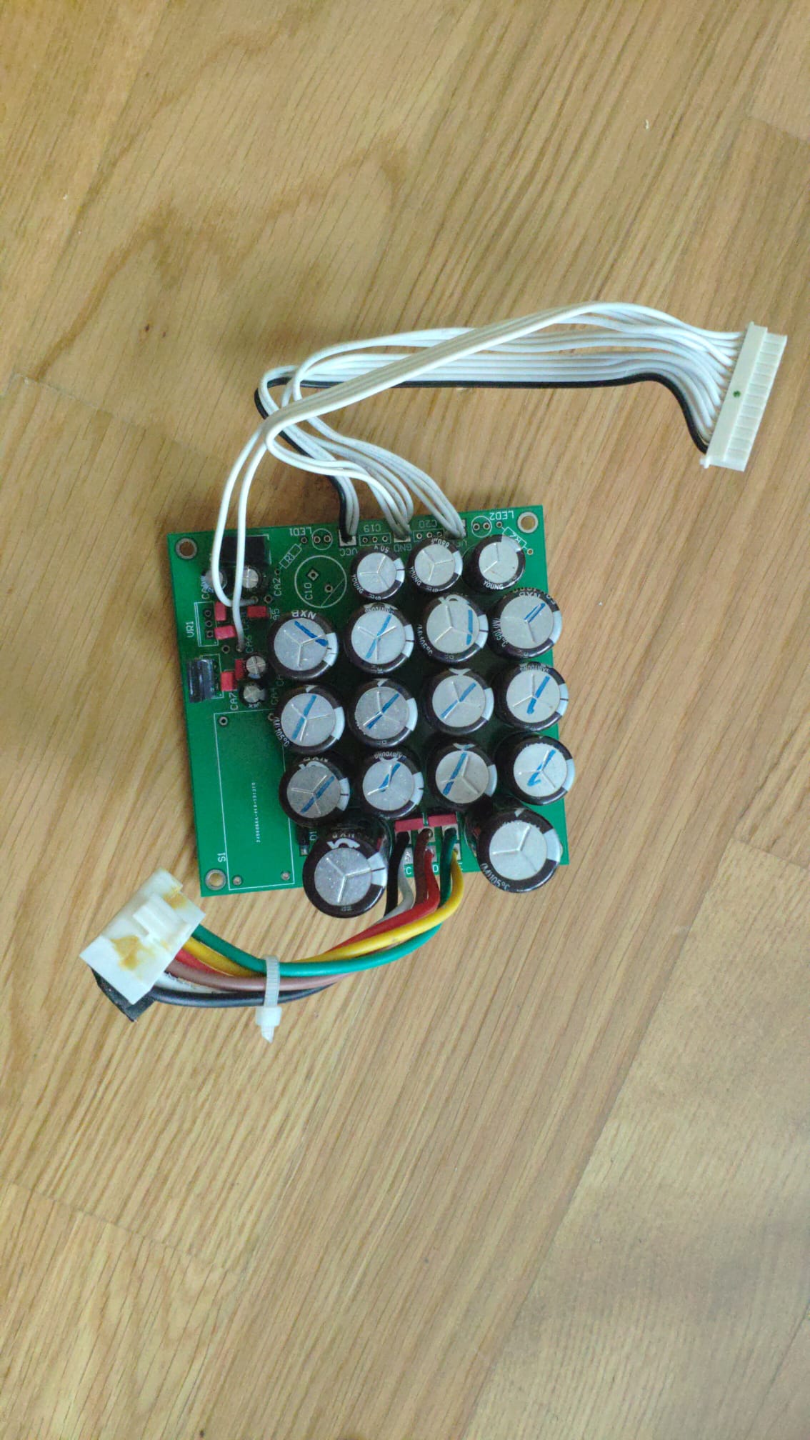

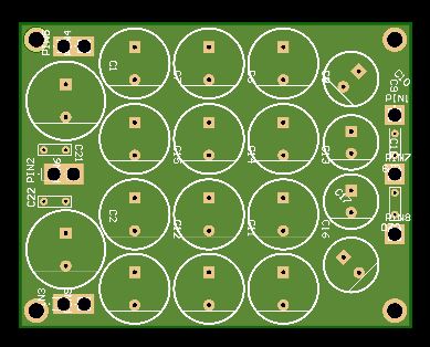

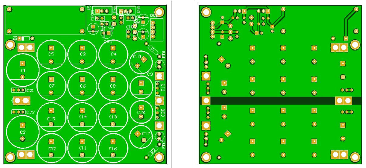

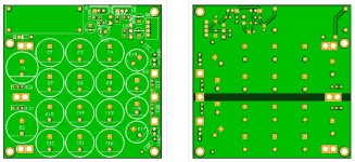

Hello
What do you think about this capacitor board?
The board will be assembled with Samyoung NXB capacitors. Two 2200uF with 12x 1000uF and 4x 680uF. This equals 9560uF per rail. On PSU and AMP are also some caps. This is only an additional board.
Will it be enought for 6 IRS2092 amplifiers?
Better than nothing^^
Sure it always helps. Just make sure your SMPS doesn’t shut down due to huge in rush from cap bank. I have had to add a cap Mx that slowly ramps up to overcome auto shutdown.

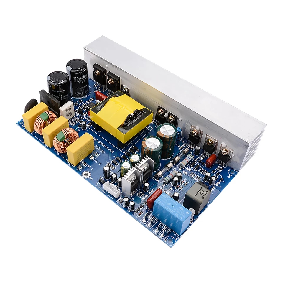

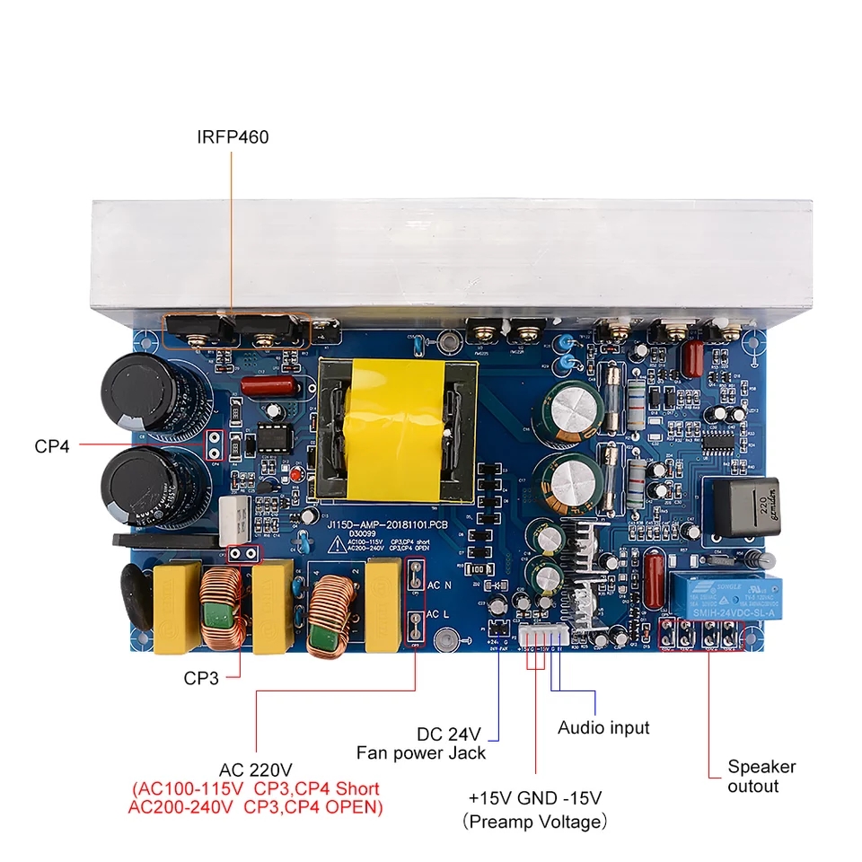

Hello everyone
I just found a new amplifier based on irs2092 with built in power supply.
US $59.52 28%OFF | AIYIMA 1000W Mono Channel Class D High Power Digital Amplifier With Switching Power Supply Integrated Audio Board For Home DIY
AliExpress
What do you think about?
AliExpress
Seems to be something really new. It comes with a schematic, so repairs are possible without starting a scientific project. This is something new, Chinese electronics with schematics...
Did you order one or a pair?
No I did not buy this amp... They have also new llc power supplys.
I did not find the schematic!?!?

That's a nice amp for $56 and if it really can hit 1000w, a steal. That's 256Vpp into 8ohms. Those are lethal speaker cables.
Edit: I see it is 500w rms or 181Vpp, still pretty high.
The seller said it comes complete with schematic. Maybe China imported an European schematics painter.
