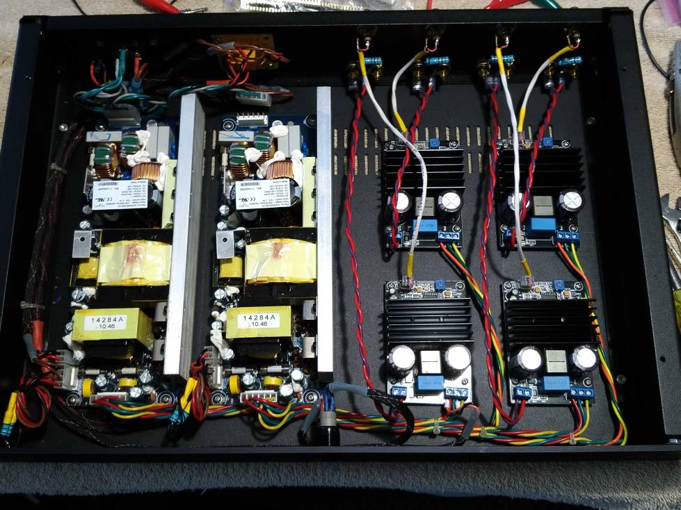

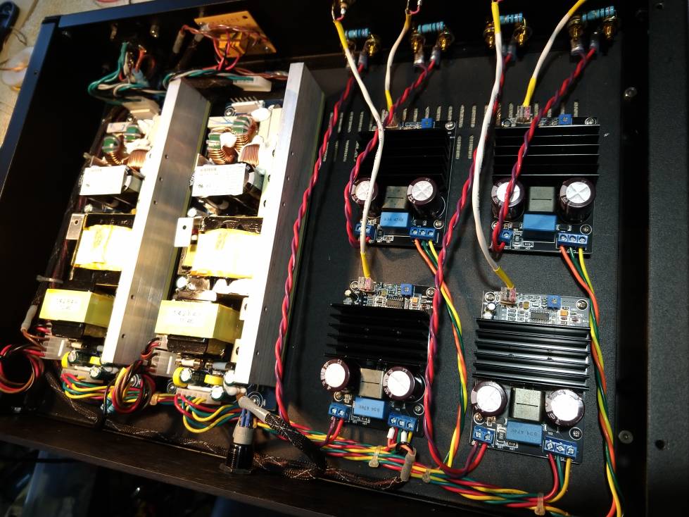

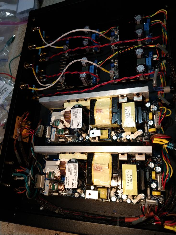

Rather than scrapping your almost completed amp
For what it's worth, you've already laid it out nicely, drilled your holes. There's space in the chassis to squeeze two stereo speaker protect boards. Perhaps you can swap out the damaged module with a new one and run it as planned, but this time with the speaker protection in place.
I ran a similar set up for a few years without fail. The same 4 amp modules, in bridged pairs to an 8 ohm load, only I ran all 4 off a single Abletec SMPS with 15,000μF per rail... I'd originally planned to use one Abletec per bridged pair but after testing all 4 boards with just one SMPS, it was already more power than my dual 6.5" woofers could handle.
Anyway just a thought.
NO JOY... Finished the amp connected it to my test speakers and let it play. It played fine for over an hour. Then POP and an increasing "saw type" sound. I ran over and turned it off.
I will NEVER trust these modules on anything other than shop speakers.
