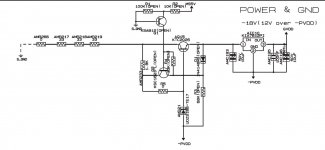

Hans, sometimes you do strange things for unclear reasons. Maybe the amp has died now, because he was happy the way it was and needed the regulator it had? Why remove a working regulator and install a problematic step down? An oscillating problem that other people would, maybe, remove out of an audio device?
There is a saying: Do not fix it if it is not brocken. This makes some sense, don´t you think?
Do you have a schematic for the amp? If yes, someone could figure out what you did and why the amp responded like it did.
If no, no one can tell you what you did. Do you have any idea?

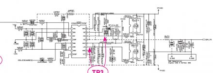

I have no response from the ICs

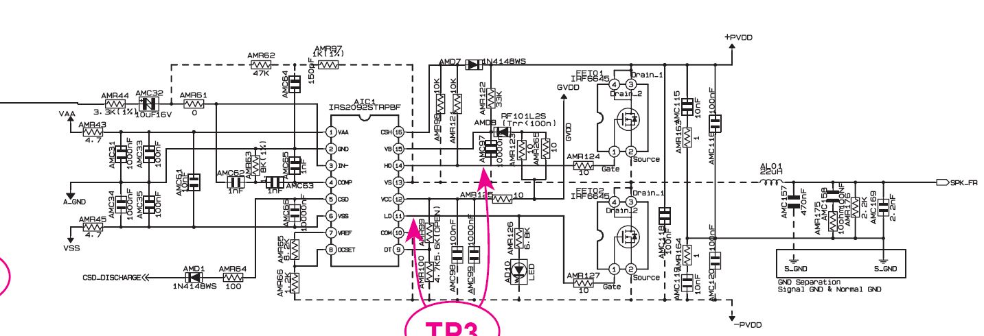

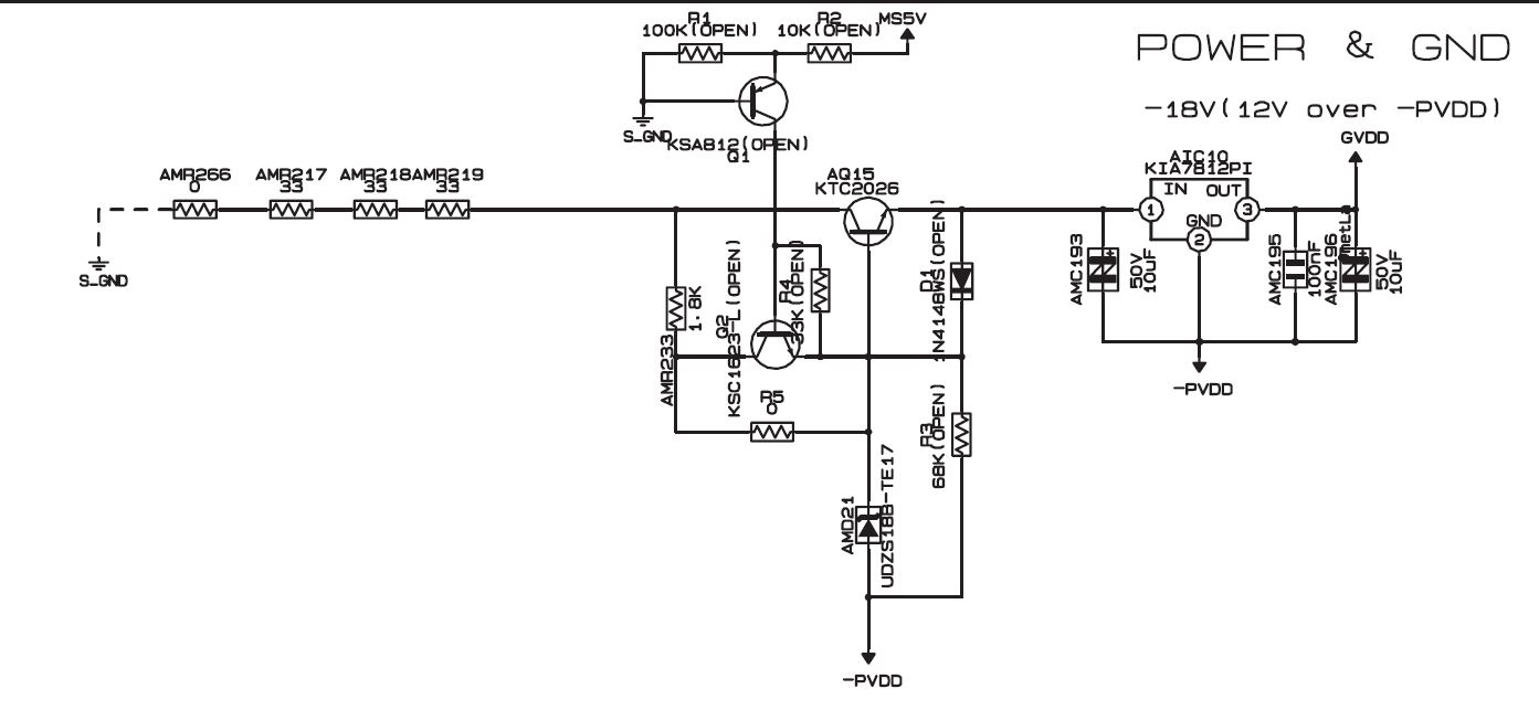

Thats the schematic and the VCC part... I think this have bruned the IC...

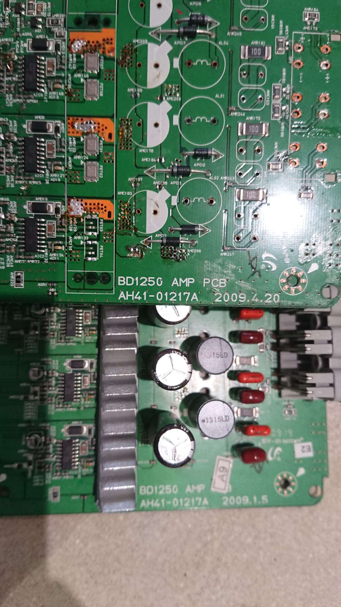

Not to be an ***, but is it possible, that you broke some of the "platings"?? (don´t know if it´s the right word for the tiny copper tubes that go from top to bottom of the pcb connecting all layers) when you removed the old capacitors??? If it´s made as a 4-layer PCB, the damage is not repairable. I 2-layer you might be lucky to find such an error. Also one of my friends found a slight reverse leak in the diode that goes to pin 15 when his version died just out of the blue. Replacing it with a MUR120 solved it.

back to my amp. I desolderd some IRF6645. The look to be burned. But amp still does not work. Shortcircuit on VCC and VEE. So more mosfet are burned... Desoldering is easy with my heatgun but how can I solder the new one easily?
What do you find at the output of the IRS IC? Pin 11+14?
As you did something unwise to the power supply, at pin´s 1+6 maybe, the IRS will be blown and the FET´s are only secondary damage. How to solder them in is your task, sorry.
I predict new FET´s will blow again, until you change IRS.

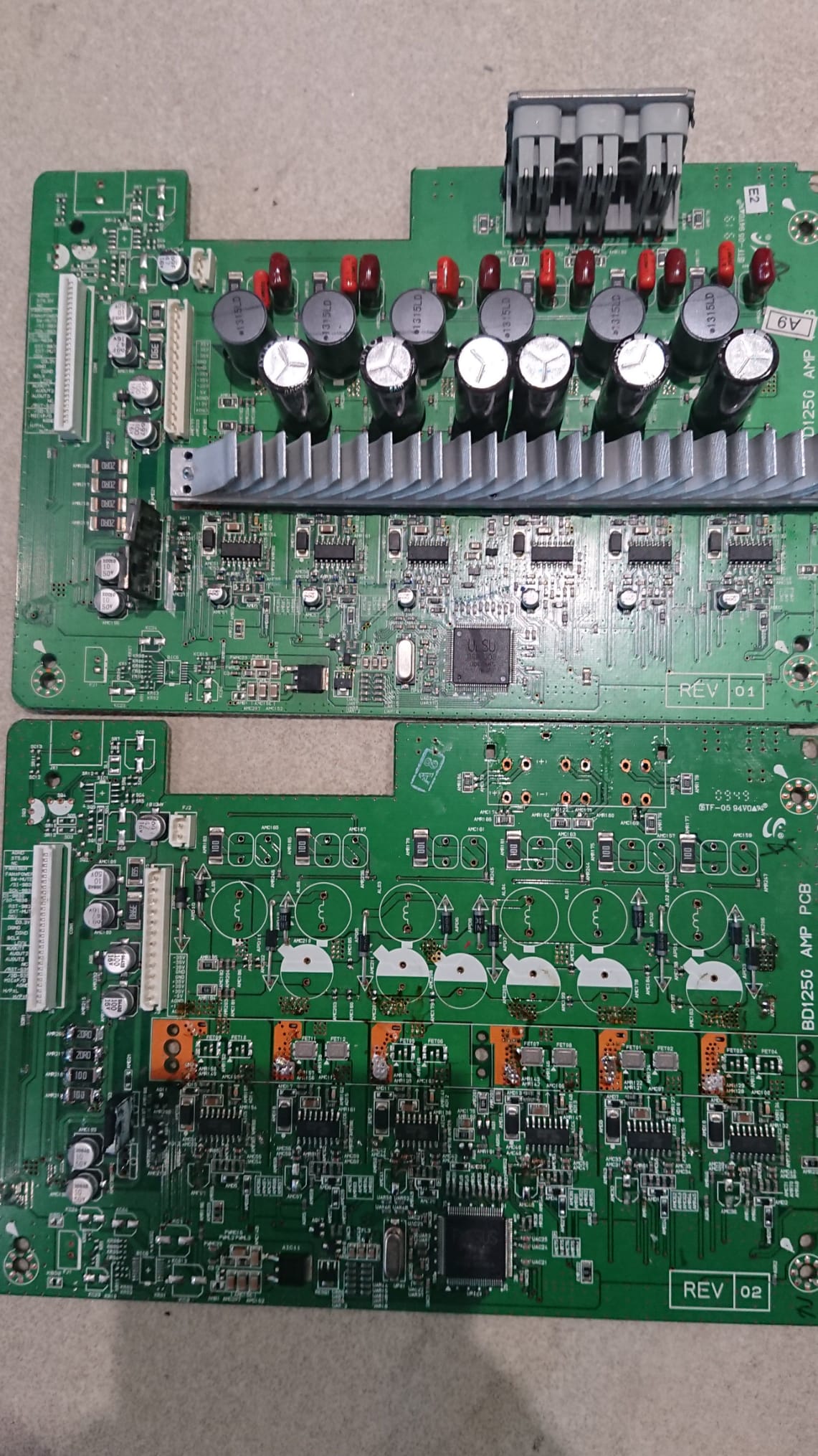

Unfortunately the revision is 1 and has no clamping diodes.
The old board had some.
I payed CHF 30.- for the hole board (Samsung receiver).

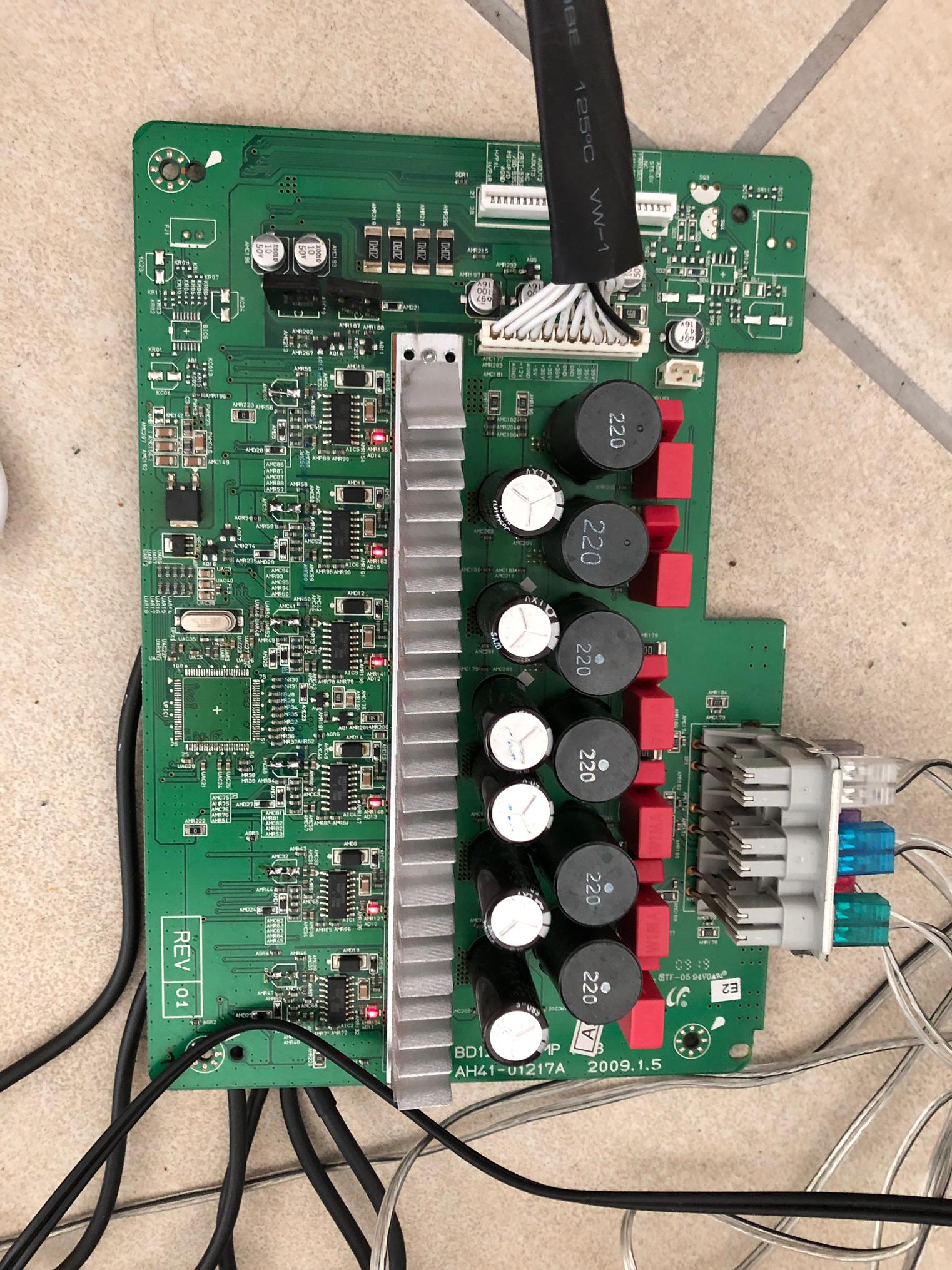

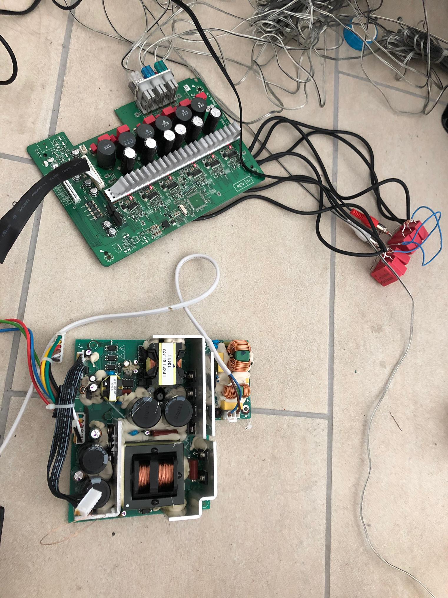

It works.
Only problem is to generate the -5V. My voltage regulators only can handle 35V. But my PSU has +-36V.
For testing I took a 5V brick and the amp works.
No load consumption is a bit hight with about 20W. It must be the active PFC.
The amp in a IRS2092 like many others. But its manufactured by Samsung in its homecinema. I saw that Sony puts IRS amps in their Shake soundsystem with the bigger IRF6775 (same as Pionneer use in his digital amp receiver) and big coils.
