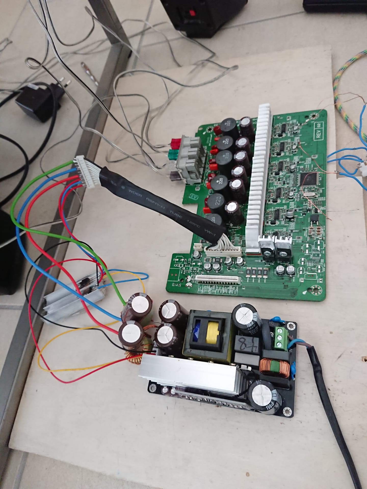

I just finished this today and would like to test it before I put it on some “good” speakers. What do you suggest for testing?
1. Test for DC on the outputs.
2. ?
3. ?
You need to put a load on the amplifier or you will get massive ringing on the output filter which might take out filter capacitor.
Sometimes the 2092 output can sit at +17 VDC with no load or otherwise it outputs PWM frequency.
May I use a 16 ohm 3 watt resistor just for testing?
That will be fine.
+/-40V rails would be a lot safer. You may still need to increase the 47K feedback resistor.
Q15 is keeping the 7812 safe from >40V, so it'll be OK.

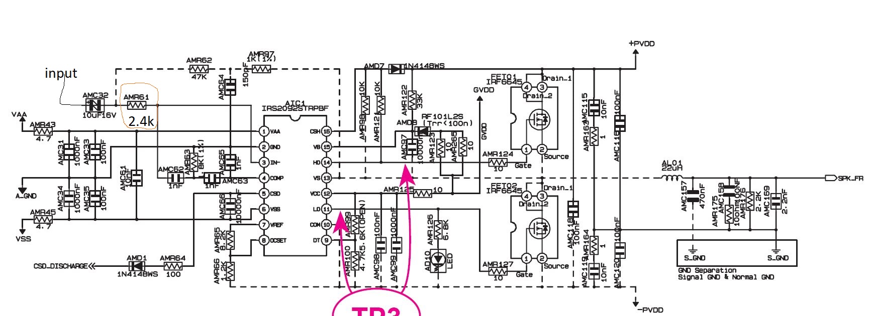

Which affect has the Dead Time? What is better 0.456 or 0.713?
The same Mosfet are used in other Samsung Receiver with 43V.
I made changement form shematik... It was more easy to put 2.4k reistor instead of 0ohm. So this could be the problem?

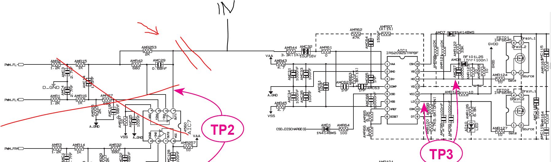

Is the position of my input resistor propably the source of my problem?

Yep. Sorry I missed the R61 change for my previous post. Bet that is the distortion source. Probably best to replace it; just break a strand or two off the nearest stranded wire and jumper it.
Keep in mind that pin 3, the IN-, is a virtual ground -- the input signal must be a current into it, not the typical voltage source. Put a 3k3 resistor in series with C32 and connect that to the signal source.

Hei guys
I founf my problem. It was the op-amp. It was still connected. So I cut it and now amp works like it should.
I have to do it for all 6 channels.

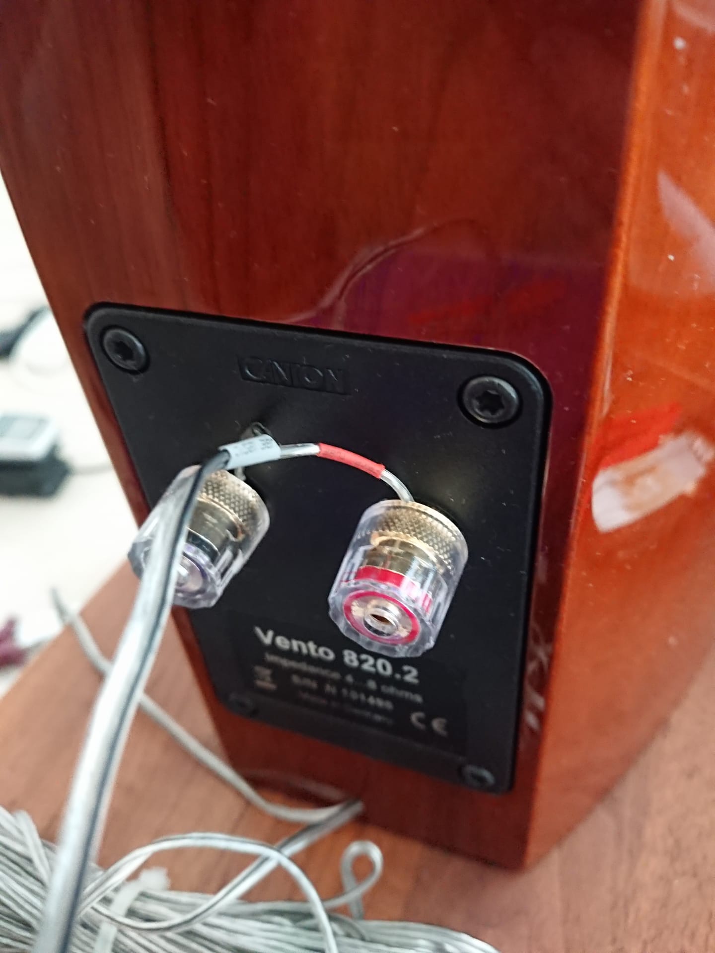

So I just tested all 6 channels. Amazing. I drive 2 Canton Karat 709 and original Samsung HC speaker. It was easyier to use them ^^
At max volume 230V socket showed about 95W :-D

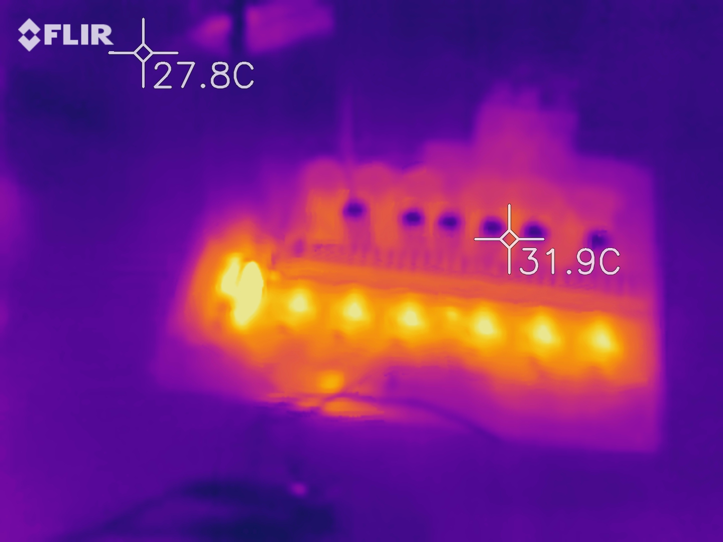

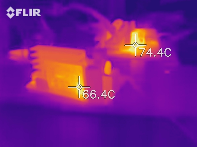

Aren't the outputs still a little toasty, though.
Bet I'm not the only one out here lusting after your Flir device. Do you happen to know if it has distributors on this side of the Atlantic?

Exactly. No no noise problem also when no input.
Flir is an american brand. You can't buy them?
Mine is from Conrad. But you find it at many more stores in EU :-D
Did you sk Flir direct?
It is really intresting to catch the thermal image when you are testing something you modded^^
When it goes to hot you can stop it. :-D

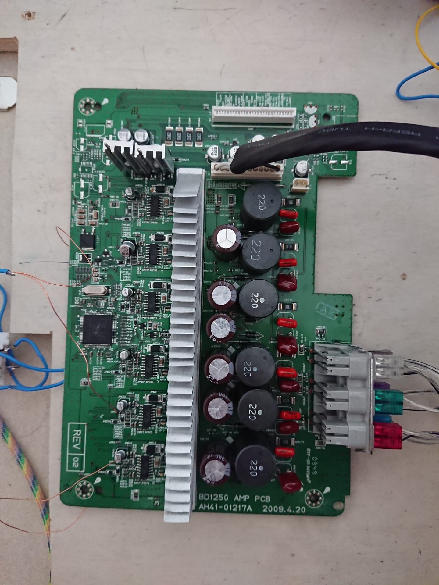

So attached finished amp (for first).
I will look for a housing and a decoder for surround.
For first I use original Samsung wire... looks strange mounted to screw terminal of my loudspeaker^^
A colour picture with all new caps and heatsink. Heatsink of transistor should be bigger. It becomes very hot.

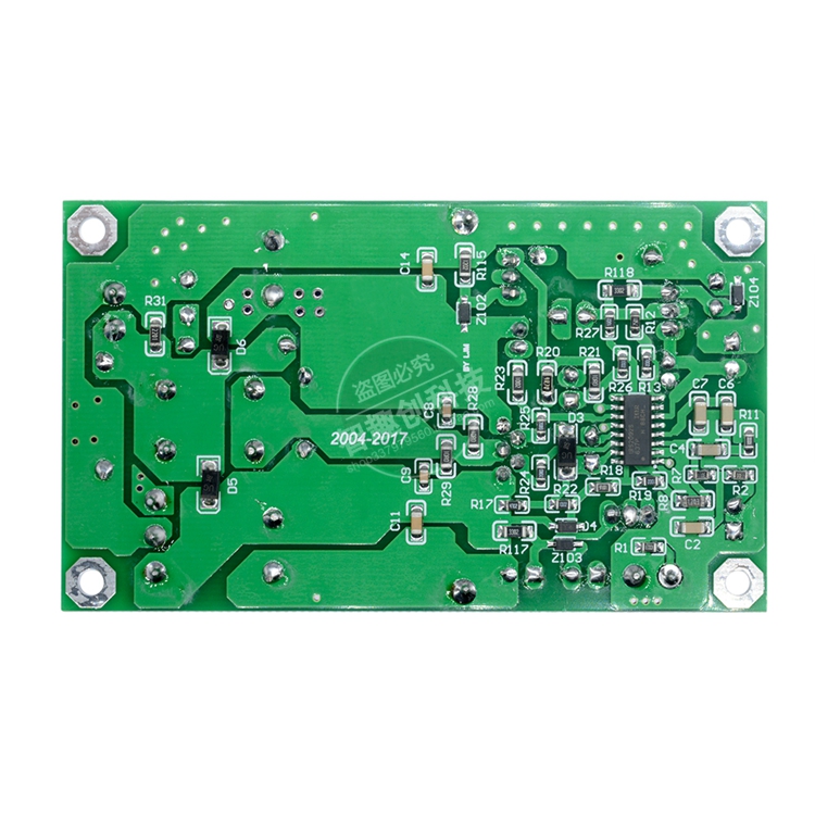

L15DSMD

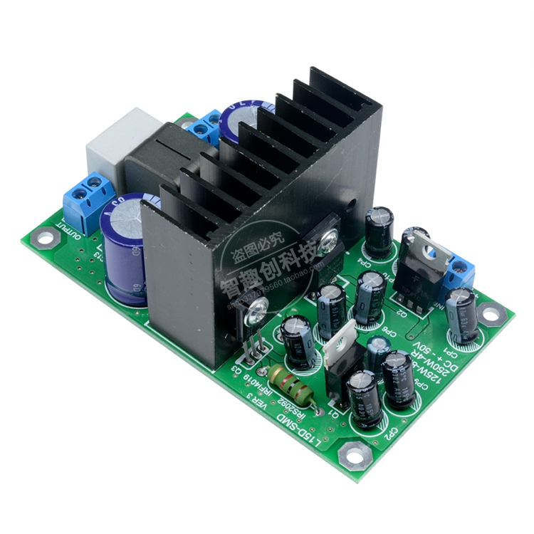

These boards are an attractive price on Taobao (75RMB, or about $11 each) so I couldn't resist. Turns out that with only a few mods they can sound really, really good.
IRS2092S ??? 250W ???D?????? ??L15DSMD-???
The mods I've made are to the power supply for the signal stage of the IRS2092, and to the grounding. The power comes from a pair of discrete T0220 transistors (TIP41C, TIP42C) each fed from a 6.2V zener at their base. That zener is in turn fed via a 33k 1206 resistor from the main bus power. I don't want to run these boards at the max supply (about 60V), rather 36V is enough juice for my needs. I therefore reduced that 33k to 6k6 (3k3 + 3k3 0805 to handle the heat) to increase the zener diode current, in stock form the dynamic impedance of that zener I reckon gets to be too high.
There are also caps, on the top side of the board, which I have increased in value with the aim of lowering the supply impedance. The stock ones are 47uF/50V - I replaced the ones in parallel with the zeners with 1800uF/6V3 and those on the outputs of the TIP transistors with 3300uF/6V3 just because I had these two values to hand. I haven't explored how critical the values are to the SQ.
I'll give details on the grounding mods in a subsequent post.

@Abraxalito Do you have an idea what is the watt output on those boards compared to how mainstream compagnies like Denon Yamaha specify power?

The watts output depends on the supply voltage applied. This board can go easily up to 50V - into an 8R load that's about 140W. Maybe it can go higher still - the supply caps are 63V. I'm content with about 70W hence I plan to run at 36V.

Here's another Aliexpress vendor with the same board : L15DSMD IRS2092S High power 250W Class D Audio Digital Power Mono Amplifier Board-in Amplifier from Consumer Electronics on Aliexpress.com | Alibaba Group
Input impedance is very low, but fairly standard for this kind of design at 3.3kohm. I have increased that because I don't need so much gain, since only running at 36V - I increased it to 6k5, this lowers the gain to 18X. I see you're quoting my mod to one of the earlier boards which had SMT tantalums for the caps. On this one the mods are more robust because the board already has through-hole 'lytics, they just need replacing with lower voltage/higher capacitance types.
