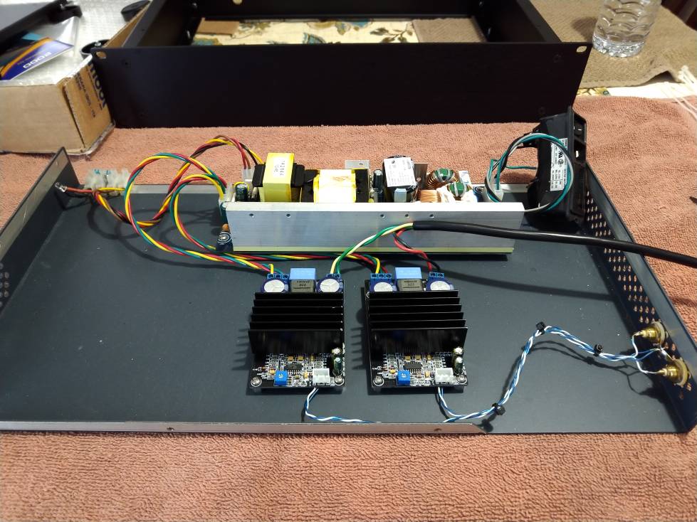

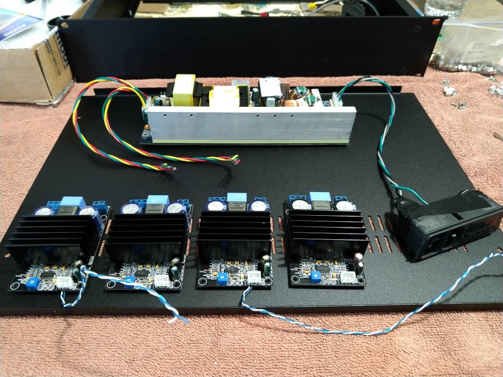

A picture is worth a thousand words so here goes.
I want to make a 4 channel amp for a low powered office system. I need ~100w on the bottom and <25w on the top of a bi-amped system.
I really think one supply would do it but of course I would like to hear from someone who has been running these a while.
Comments? Please.
Old test rig that worked great!
Proposed single supply:
Undesired layout:
Comments? Please.
Undesired layout:

I don't know what bus pumping is and I don't think I had it on the old test rig.
Now does that mean I won't have it with 4 amps on one supply? I have no idea.
What does the little pcb with opamp do?
One issue encountered in single-ended (SE) class-D amplifier designs is supply pumping. Power-supply pumping is a rise in the local supply voltage due to energy being driven back to the supply by operation of the class-D
amplifier. This phenomenon is most evident at low audio frequencies and when both channels are operating at the same frequency and phase. At low levels, power-supply pumping results in distortion in the audio output due
to fluctuations in supply voltage. At higher levels, pumping can cause the overvoltage protection to operate, which temporarily shuts down the audio output. Several things can be done to relieve power-supply pumping. The lowest impact is to operate the two inputs out of phase 180° and reverse the speaker connections. Because most audio is highly correlated, this causes the
supply pumping to be out of phase and not as severe. If this is not enough, the amount of bulk capacitance on the supply must be increased. Also, improvement is realized by hooking other supplies to this node, thereby,
sinking some of the excess current. Power-supply pumping should be tested by operating the amplifier at low frequencies and high output levels.

"Also, improvement is realized by hooking other supplies to this node, thereby,
sinking some of the excess current."
Sounds like more devices with different frequency spectrums would help.
Ill try hooking all 4 up to one supply and see how it goes.

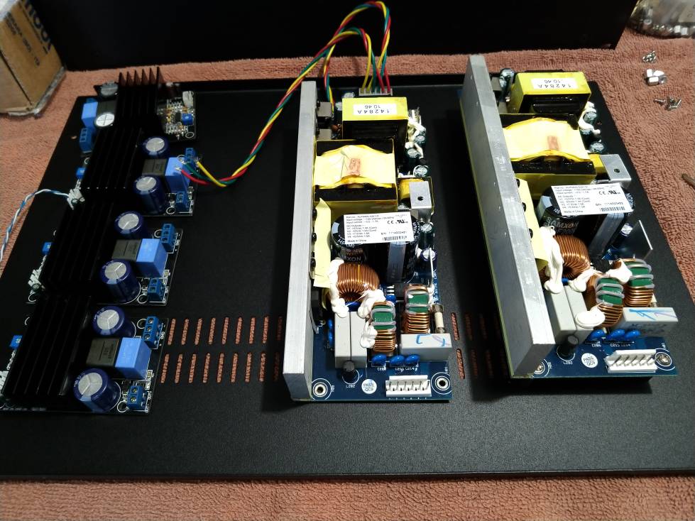

Hi I'm thinking of doing the same, 4 amps hocked up to 1 SMPS, did you do that at the end? How did go?
Well unfortunately I have been travelling for work and have not been back home for more than 24 hrs so the short answer is...
Not yet...
Not yet...

psu is Abletec?
No PSU is: About china LLC smps
500W china LLC
I made some mesurement on other thread. You can have a look.
But amps are the same
