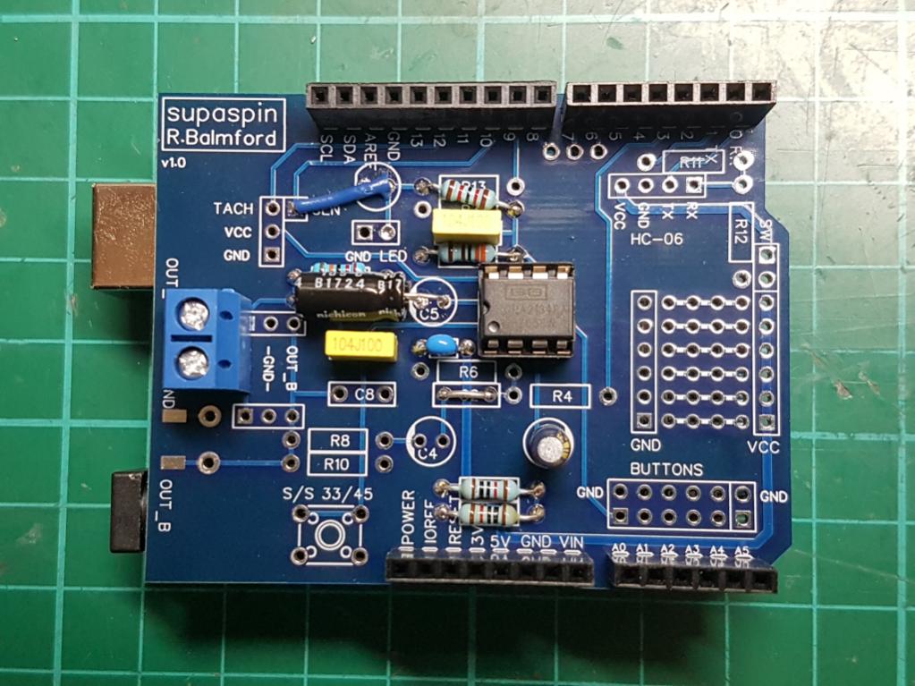

The Atmel microcontroller has (only) 2 hardware PWM output for each timer/counter, hence it was straightforward to generate 2 phases with a fixed relationship. Going to 3 phases would require using a second timer/counter, which should be possible if the additional calculations can be squeezed into the time available for the interrupt service routine. I'd probably have to ditch the tachometer test tone generator to liberate its timer. Hardware wise, I'm sure a second board could be stacked and connected to run from an alternative output pin. The extra hardware solution shown above is an option, but I think it would be nice to do it in the processor if possible. I have some other projects on the go (and a job unfortunately!), but you never know what may happen on a rainy day.......
Thanks richb and thanks to ralphfcooke.
It would indeed be interesting to integrate the third phase into the project, if possible, rather than adding a board. So we will wait for a rainy day...

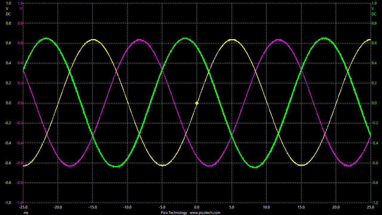

OK so despite it not raining at the moment I got curious......
I had to save one of the traces as I only have a 2ch 'scope, but this is all 3 phases running simultaneously.
I have some work to do on storing the values to EEPROM and updating the control interface, but this is proof of concept at least 🙂

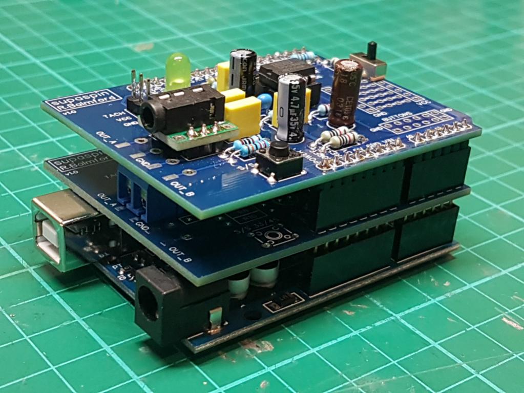

Here's the 3-phase 'stack'!Nice project !
The board is designed to work with 2 phase synchronous motors only. Is it possible to stack two pcb to drive a 3 phase BLDC motor (with the MA-3D board) ?
More by luck than judgement, it has worked out very straightforward to add a second board for the third phase - only the 'upper' channel is populated, with its input connected across to the re-purposed GEN output on pin10, and using low-profile or horizontally-mounted capacitors for clearance to the top board. The unused channel of the OPA2134 is connected with unity feedback to prevent any switching due to noise. The top board is the completely standard build as for a 2 phase generator.
It works as per the previously posted 3-phase output. I will produce a unified firmware that works for both 2 and 3 phase outputs and post here when available.

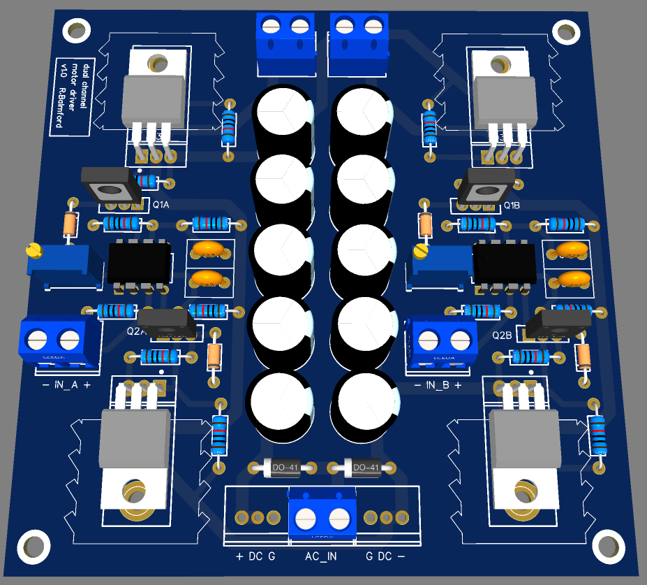

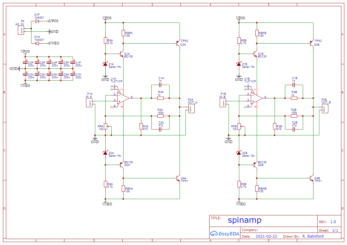

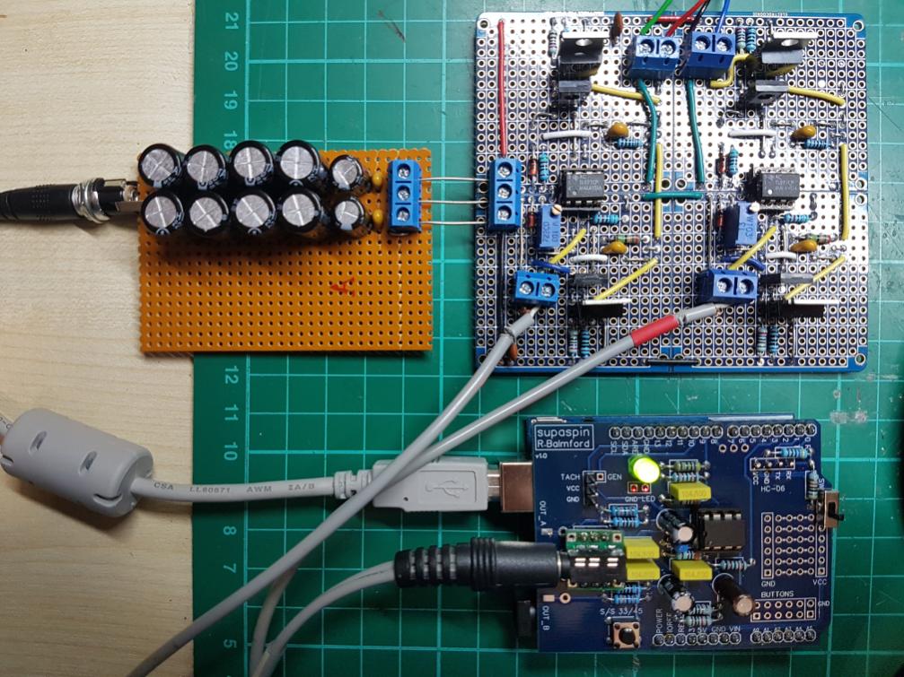

I've put together an easy to build amplifier suitable for driving my 24v Rega motor from the sinewave generator, and it works very nicely. Shown here is a 2 channel prototype, powered from the standard Rega AC adapter.
There are of course many options for this, but if it's of any interest then details are in this thread.
I am interested in one of the PCB. Would be nice to get everything inside one box. I would prefer an smps supply. Will the rega wall wart for 24v motor work for the box?
I've put together a PCB for this and will get it made alongside some other boards, two channels plus power supply section on a 100x100mm board, with the option to power by single AC or split DC supplies (and feed DC power out when using AC in)/QUOTE]

Yes, the prototype shown above was running from the Rega AC adapter. Should also be able to power the sinewave generator from the DC out from the amplifier using a step-down converter, I'll try this out.I am interested in one of the PCB. Would be nice to get everything inside one box. I would prefer an smps supply. Will the rega wall wart for 24v motor work for the box?
That's great you're up and running! No problem.Hi Richard.
I have built the sign wave generator with great success, thank you for sharing a fantastic project.
I would appreciate if you could supply the amplifier pcb to complete the project.
Once I get the PCBs and get one made up and tested, all being well I can share the spares and Gerbers.
