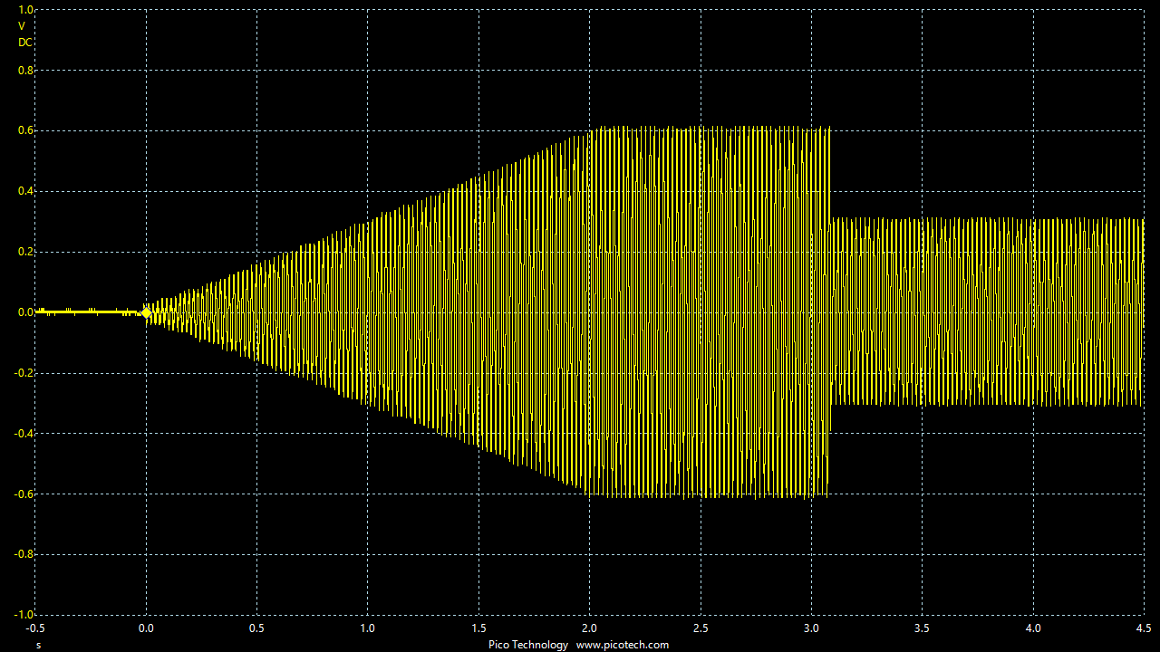

Talking of which, having fielded various requests from a couple of members, there are a few more features now included:
- Selectable amplitude reduction after a chosen delay. This has been added to better support 3-phase BLDC motors (in this particular case using the same amplifier board as suggested on the SG4 thread). Example waveform (with Soft-Start enabled) below. The supported final amplitudes are from 95% to 75% full-scale in 5% increments.
