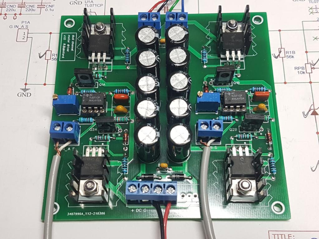

The PCB for the 2-channel amplifier has gone together fine, so here are the latest schematic and gerbers.
I have some amp PCBs that I can send out too, £1.50 each + postage.
I also have another batch of sinewave PCBs available (a tweaked version with easier R3 placement for the 3rd phase).

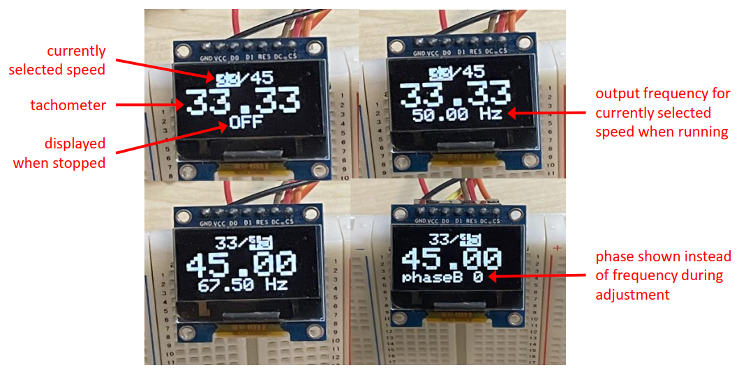

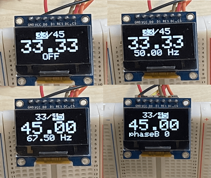

It can now support an SSD1306 based 128x64 OLED display as an alternative to the Bluetooth/RemoteXY interface:

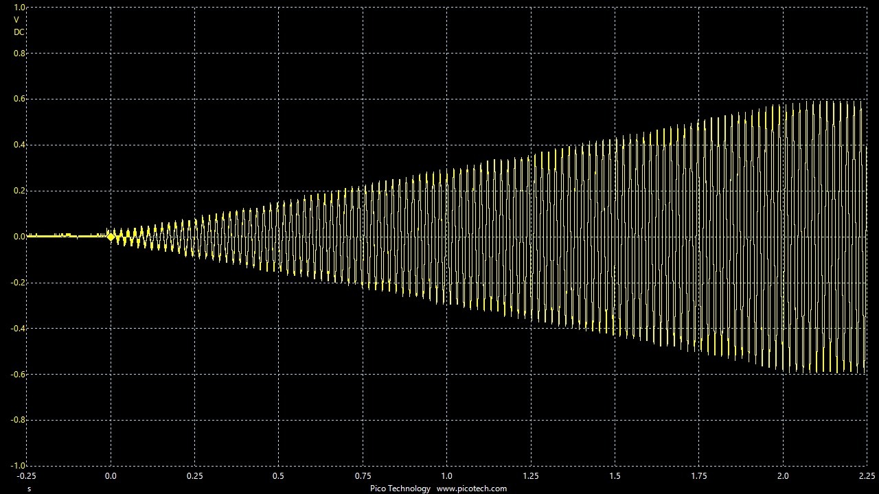

A new 'soft-start' feature which ramps the amplitude up over ~2s:

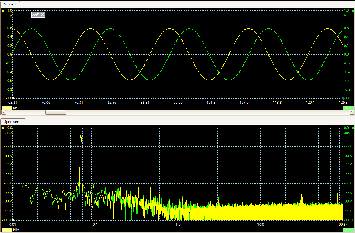

Although I've reduced the computational load of the sinewave generation to ensure the buttons and display remain nice and responsive, spectral purity of the full-amplitude sinewave is still good:

New display:

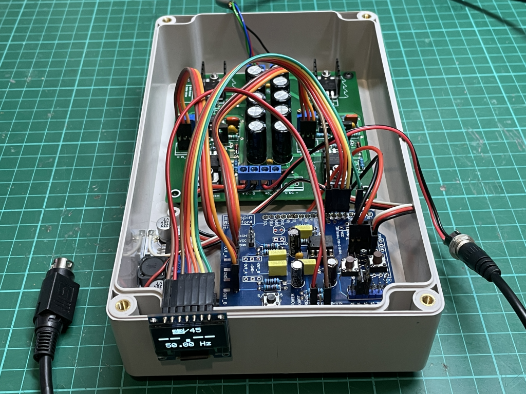

Included in my testbed (this is set up to drive a Rega 24v motor directly from the original Rega PSU, using the amplifier board posted earlier in this thread):

An interesting feature is that the display shows speed and frequency simultaneously.
About the 2 channel amplifier, do you plan to post a BOM ?
