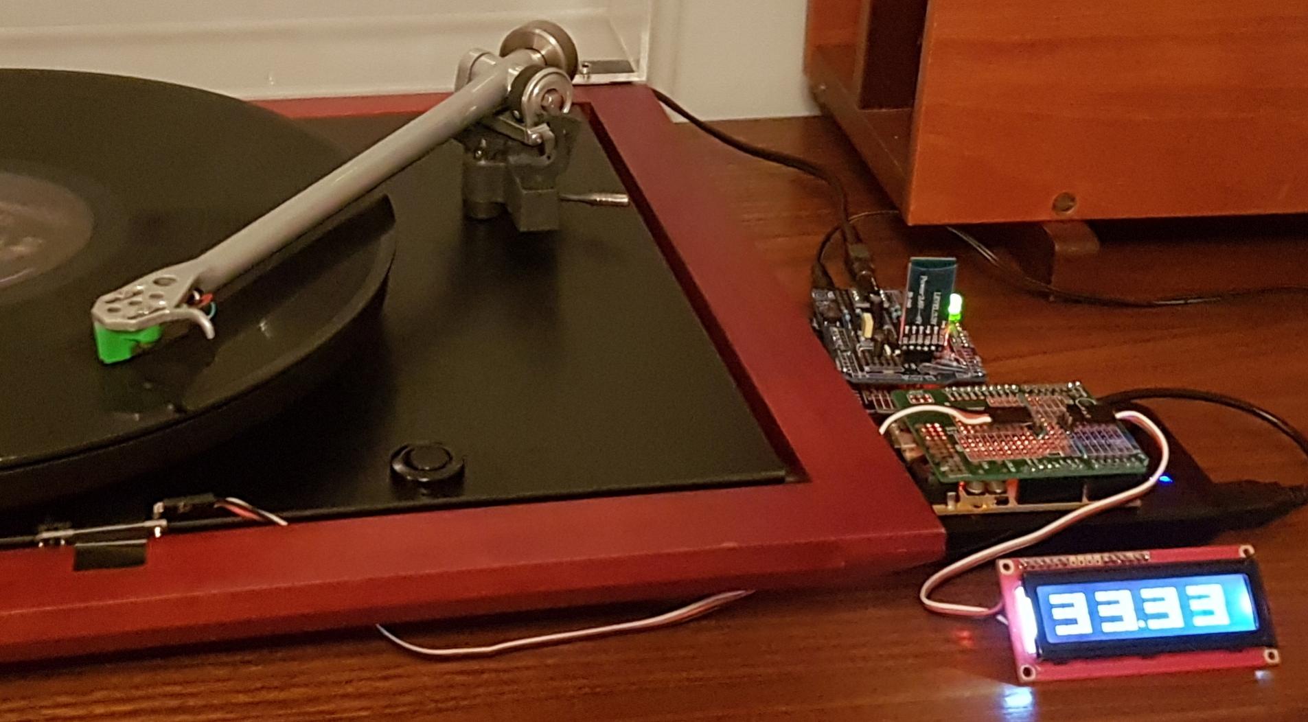

Yes definitely possible. I try to use Timer2 or Timer1 in preference to Timer0 as the latter is used for the millis() and delay() functions which can be handy.I've been trying a couple options until receiving the parts for the filter. I have been trying to include a sketch developed here on DIYAudio for an Arduino based turntable tachometer. But both sketches use Timer2. Would it be difficult to change this sketch to use one of the other timers? If so, some guidance would be appreciated.
I've just had a look at the ATmega328P datasheet and Timer1 does have an 8-bit phase corect PWM mode, so I'll do the experiment and let you know the changes required. The output pins would move from 3,11 to 9,10, so worth deciding before finalising the hardware.
I've also developed a tachometer running on a separate Arduino (see picture for both in operation), and use Timer1 for that as it is 16-bit and hence easier for measuring the longish intervals of a turntable platter. So another option would be to use Timer1 for the tachometer.
I was thinking of ultimately linking up them both to allow closed-loop speed control, I haven't experimentd with integrating both functions into a single Arduino, although that would potentially make this more convenient.

I think it will be a problem to use 2 separate timers to do the tach and DDS generation. The ATMega328 has only one interrupt priority, so when it services one interrupt, all others are blocked until it is done. This can seriously impact the timing of either operation. On the tach sketch that I wrote, I disabled Timer0 and Timer1 to prevent them from interfering with timer2 counts for the tach.
Since the DDS interrupt is running at 31,372.55 Hz, it could also be used to process the tach count, as long as you can complete both tasks within 510 instruction cycles. The constant CALIBRATE will need to be adjusted to 60*clock or 1,882,353 instead of 1.875M.
Yeah my initial thought too was that interrupt priorities could be an issue, as the tachometer would typically use a pin change interrupt to monitor the platter sensor.
I just had a look, the PWM Interrupt Service Routine (ISR) takes ~20us of the ~32us cycle time, so not a lot left for the tachometer filtering and display processing, plus the simple control loop when integrating the two systems, although this shouldn't be a problem at the very low update rate required.
Communicating between two stand-alone Arduino's shouldn't be a problem either, so I may well still go down this route someday, then I'd have a fully modular/flexible system.
I've found using the other timers in the tachometer was not a problem though, I use one of the other timers to generate a pulse which can be looped into the sensor input for testing, and the third (via the millis() function) for a watchdog timer to determine when the platter had stopped.
The tach sketch I did a couple years ago did not use an external pin interrupt, just timer2 running at 32.000µS. It looked at the external pin for a negative edge, and captured a 32 bit count when that happened and cleared the counter for the next trigger.
Your DDS interrupt is running at 31.875µS, so it should work (just have to change the constant CALIBRATE) as long as you can get everything done in under 32 µS.

I've managed to add the tachometer function running on the PWM interrupt as described by Pyramid, seems to work well. I've had to ditch the LCD display I was using for the tacho, so will add it into the Bluetooth/App interface. Once done and tidied up I'll post some new code for you to try 🙂
