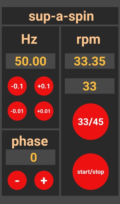

Update with tachometer function included
This now accepts input from a sensor to measure and display current speed in rpm, along with a pulse generator for 30rpm which can be looped in for testing. The default pins for these are:
#define PIN_TACH 12
#define PIN_GEN 10
There are a couple of user configurable items for the tachometer:
#define CP_REV 2
- the number of pulses per rev
#define NR_AVG 4
- the number of pulses over which to perform a weighted average
The Bluetooth interface has been updated to show measured speed above the selected speed, see picture of unit in operation.

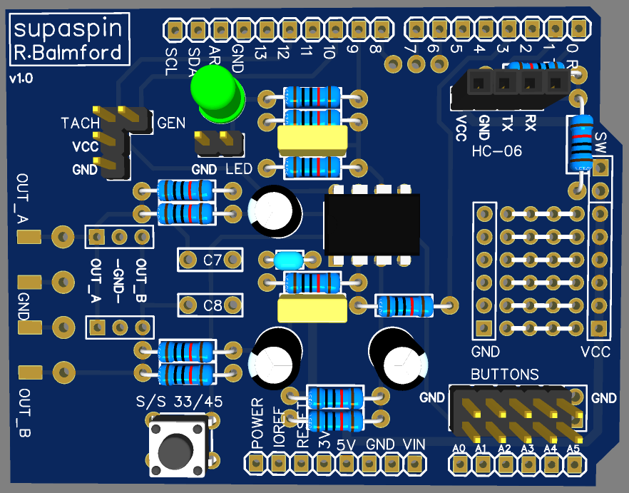

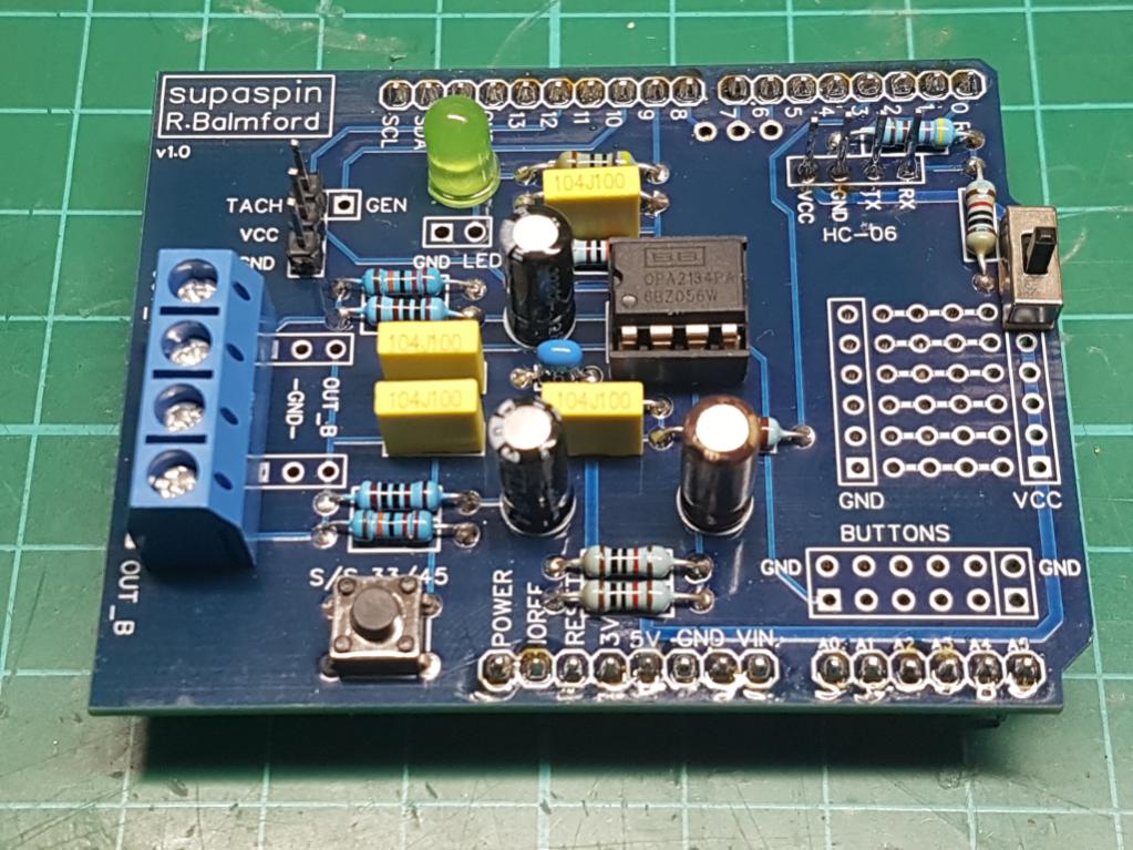

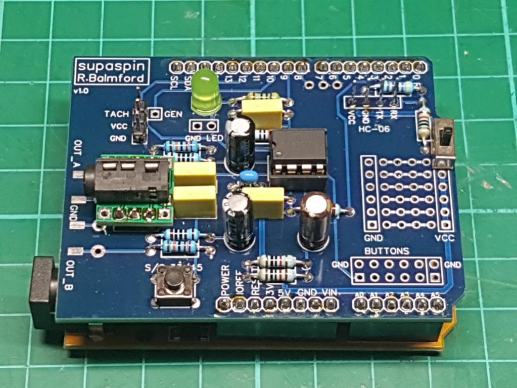

I have dived into EasyEDA to produce a more complete schematic, included below, and also have an Arduino shield PCB design on the way. There are provisions for conecting the output via 3.5mm jack, screw terminal block, or solder pads, and the HC-06 module can be socketed as shown, or permanently mounted underneath the board with power switch to allow programming. Any comments welcome

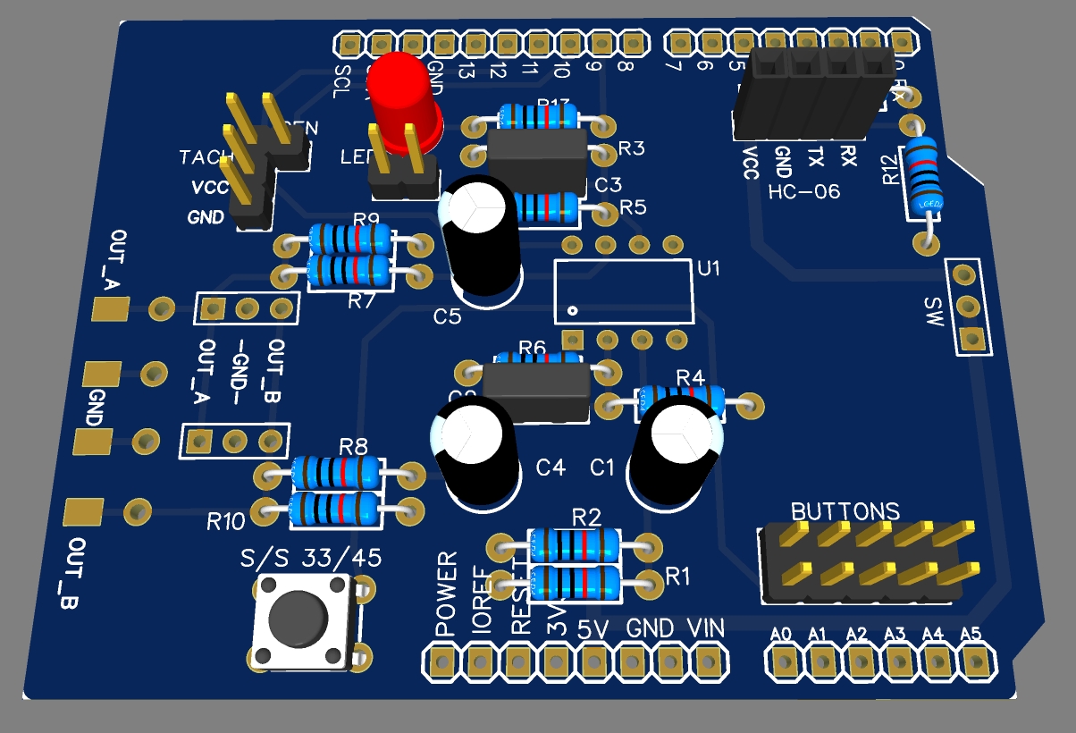

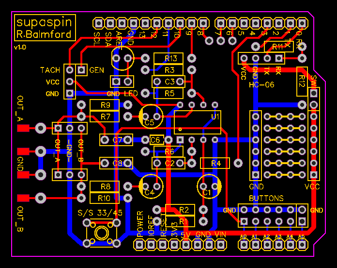

Here's the updated PCB with an option for extra output filtering and a prototype area for mods if required.

boards ready!

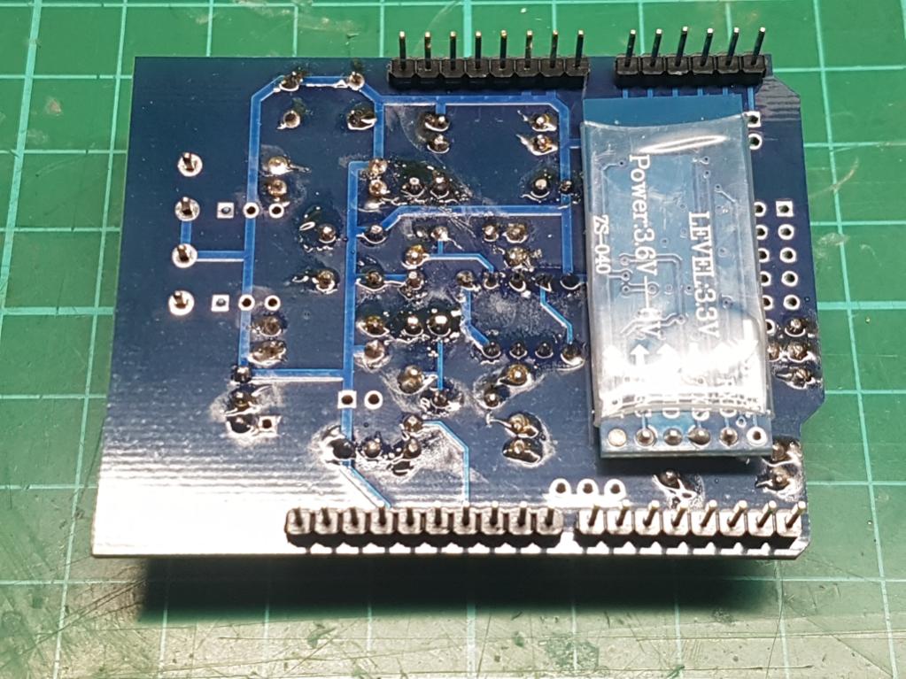

Received the boards and made one up, the photos below show a version with screw terminal outputs, another with a 3.5mm stereo socket (mounted on the Arduino), plus an underside view with the Bluetooth module mounted.

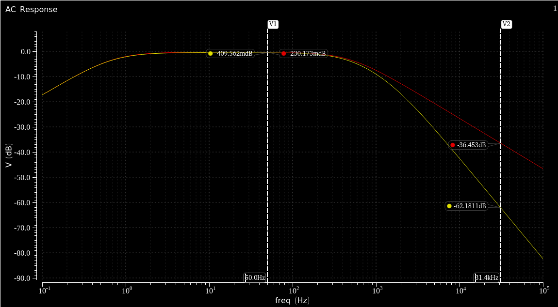

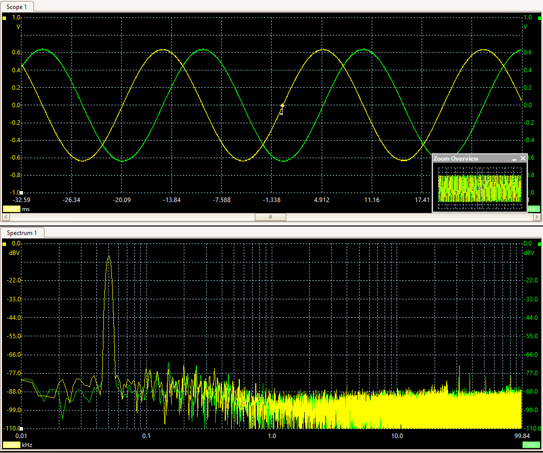

The additional filtering on the output gives good attenuation of the PWM harmonics, with only a tiny additional attenuation in the pass-band, with the simulated AC response with and without the additional filter shown below. The sinewave outputs and spectrum are shown in the next picture.
Also included here are the updated schematic and Arduino code, please see the first post for details of uploading and runnin for the first time.
If anyone wants to make one up, I have some spare boards that I'm happy to send out at cost ($1.50) + postage, or the Gerbers are attached here also.

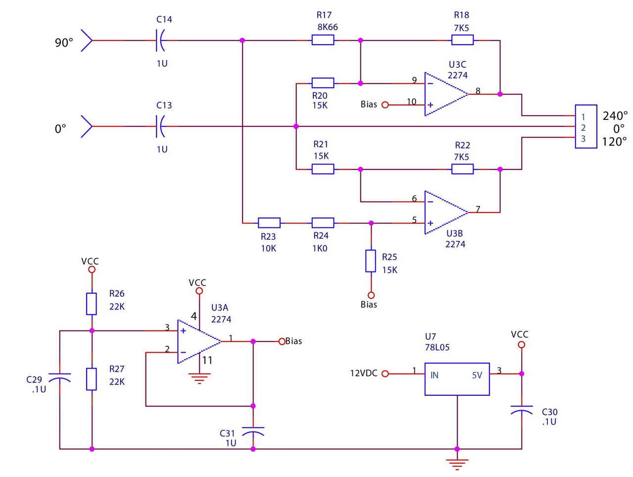

It would be quite straightforward to take the two anti-phase outputs and feed them through a phase splitter to create a 3 phase output that could then be fed into the MA3D.
This was discussed a few years ago, before Bill (Phoenix) brought out the SG4.
Here's an example of the 2 to 3 phase splitter

The board is designed to work with 2 phase synchronous motors only. Is it possible to stack two pcb to drive a 3 phase BLDC motor (with the MA-3D board) ?
I had the same question: what would be involved to make a 3 phase version?
'Interesting' question!
The Atmel microcontroller has (only) 2 hardware PWM output for each timer/counter, hence it was straightforward to generate 2 phases with a fixed relationship. Going to 3 phases would require using a second timer/counter, which should be possible if the additional calculations can be squeezed into the time available for the interrupt service routine. I'd probably have to ditch the tachometer test tone generator to liberate its timer. Hardware wise, I'm sure a second board could be stacked and connected to run from an alternative output pin. The extra hardware solution shown above is an option, but I think it would be nice to do it in the processor if possible. I have some other projects on the go (and a job unfortunately!), but you never know what may happen on a rainy day.......
