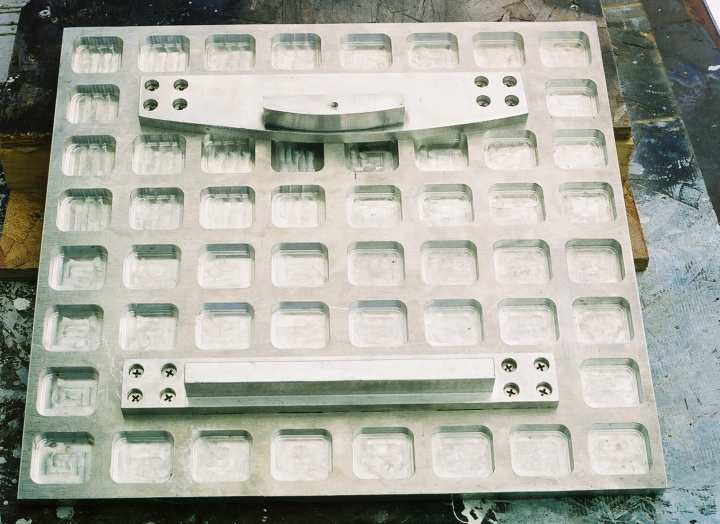

I did get my DIY first surface mirror about done except for the final polishing. Here is a picture of the back of the mirror. It is machined out to lighten it and keep it from warping. The mirror will mount with a hinge on the straight mounting tab at each end. One hole will be a slotted curve so the mirror can be adjusted side to side to get the exact angle dialed in. The other end of the mirror will be held and adjusted with a single bolt that will adjust the up and down angular motion.
Hezz
A few updates.
Sorry for taking so long to post but my work on the projector has been slow over the summer. I have not been working so I have had lots of time but no money. Been spending most of my time cycling.

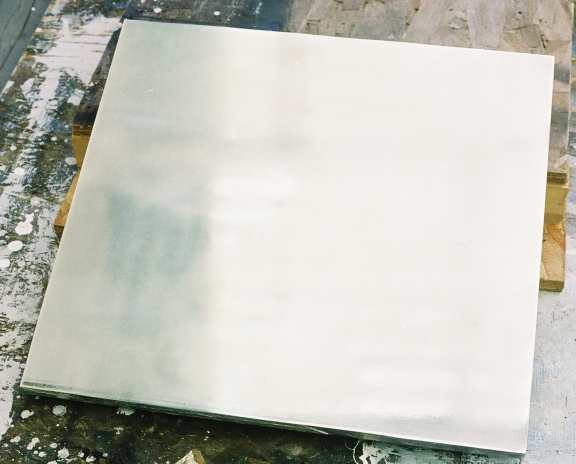

Here is the front surface of the mirror. At this point I have not put anything on it but a quick polish and I am thinking of trying it without a really high grade polish. My theory is that I will lose some light output but the slight diffussiveness of the mirror will help the LCD to have a more even lighting on it. IF this doesn't prove to be enough light I can always hand polish the mirror to as high a quality as I like.
At this point I can see a blurry reflection of myself in the mirror. Putting a near perfect polish on it will probably increase it's light output by only 3-5%.
Hezz
Hezz
Nads,
Machining was free because I did it myself at school. Having it done by a machne shop would put the cost up to where it would be unrealistic to have done. The size is about 13.5 x 15.5 inches. The Aluminum cost about 35 USD at remnant price. You could make this without machining the back out and it would probably be fine. In fact you could make one with nothing but a drill press to drill and tap straight holes. You could screw square or rectangular bar stock to the back for mounting and bracing to keep it flat.
Hezz
Hezz
experiment!
It will be interesting to see how it compares to a $2 mirror tile from Home Depot. I don't think it will make much difference on the lamp side of the LCD.
On the image side of the LCD, using a good first surface mirror makes a tremendous difference: I've tried both, and even a very thin second surface mirror gave me visible ghosting in the screen image. With the first surface mirror, I can see individual pixels at 1024 by 768 resolution.
Hmmm.. I think that this is beyond my limited tool availability, but if I take up your idea of using stock sheet metal and square backers to make one to mount a FS mirror on it with the adjusters you describe would be a lot easier for me and it would make sure that the mirror was as flat as it could be.

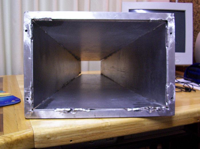

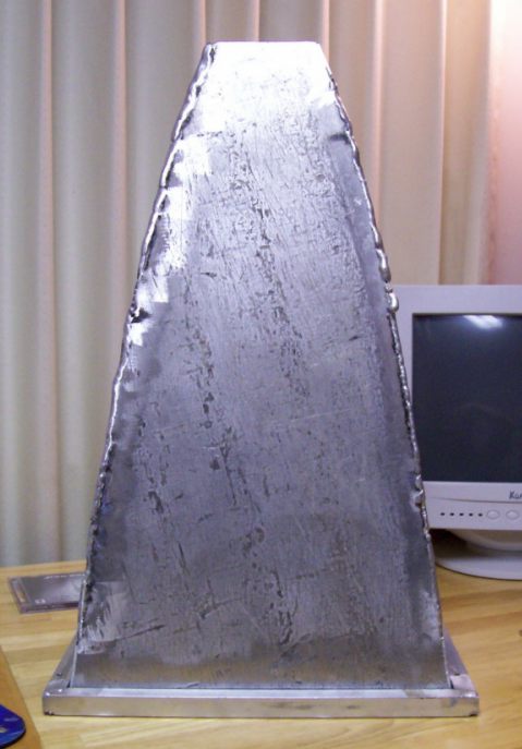

Here is a picture of my partially completed deep parabolic reflector. The TIG welding leaves a lot to be desired but the aluminum was surplus used metal that I got free and I had trouble getting all of the impurities out of the joint. This combined with the fact that I'm just learning how to TIG aluminum.
The picture is not the best but you can see the parabolic shape in the profile of the reflector. Also you can see the pits and dents in the aluminum plate.
The inside is the better side and has been sanded and cleaned up to a large degree. It will still require a lot of hand finishing and polishing to get the inside up to a more reflective surface.
I have yet to weld a flange onto the narrow end of the reflector to mount the bulb reflector/heatsink casing.
Here is a shot showing the inside of the larger end of the reflector. You can see the inside is a somewhat better finish than the outside.
I still have some joints to run a bead on to seal all of the light in. Also I am leaning on using a large piece of lexan at the wide end to act as an IR filter. I will have it in contact with the aluminum frame of the reflector so the whole thing can act like a heatsink. I'm hoping for fanless operation if possible.
There is a kind of polycarbonate from GE called Lexan solar control. It filters out most of the UV and IR but it only lets about 70 percent or so of the visible light through.
This would seem to be a good IR filter choice except that it is not very efficient and I am having trouble finding anyone who carries it. It is used as a plastic roofing material for sun rooms and skylights and other buildings.

LOL
i can tell you are new to welding. I'm a machinist in training myself and man, you make me look like a master.... LOL
tig welding is hard to learn, but once you learn it you can really make the cleanest and best welds with the finest heat control.
you can MIG weld aluminum so i think you should of done that for this project, a beginner can lay pretty nice mig lines..
