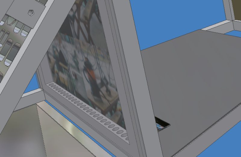

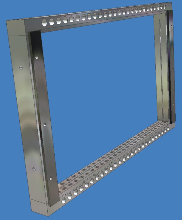

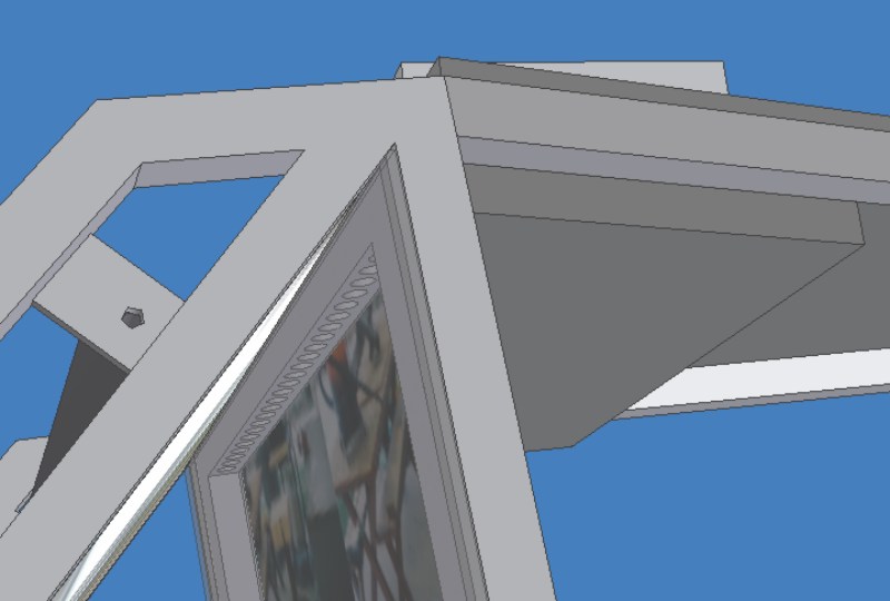

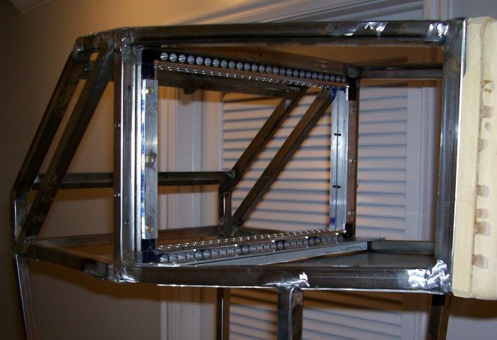

Here are some closer up pictures of the design model. On the top of the frame there is a plastic air dam and fan mount that acts to suck air out of several holes in the top of the LCD mounting frame. My goal is to get an airtight seal here so that the air will be forced to be drawn from the lower holes in the bottom of the LCD mounting frame.

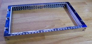

And another one showing the bottom air hole inlets from another angle.

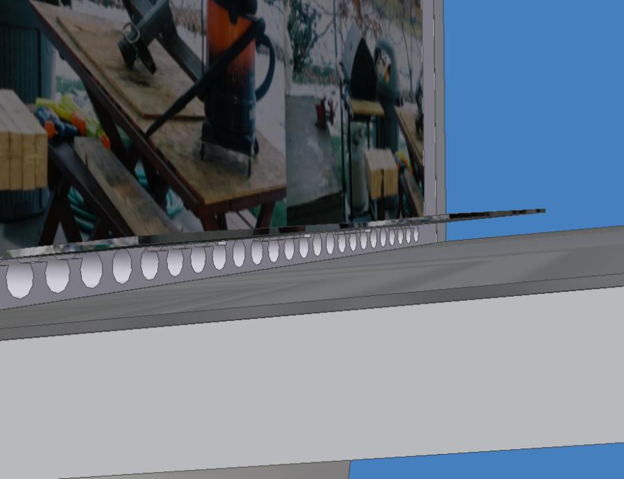

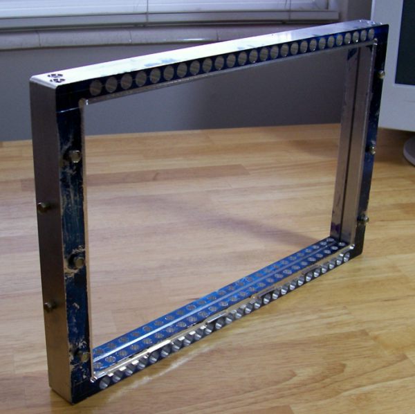

The inlet holes are ninty degree passages which are essentially holes drilled from two sides of the LCD mount. The cool air will come in under the LCD driver circuits and have some cooling effect for them also.

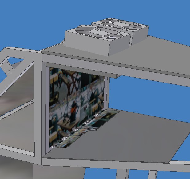

bvlad,
Actually I'm glad that I got some feedback regarding heat issues. It has forced me to come up with a better design.
I have now got the bulb housing and reflector roughed in and I am working on the LCD mount. In the end I have come up with a better design than my first solid model which should have better cooling abilities.
I am going to see how hot things get with nothing but a passive cooling initially because I would rather have no sound or noise generated if it is possible to do so.
Here is a model of my LCD mount mechanism that I am building. The way this thing works is that it is comprized of four parts that bolt together. There is a slot in the middle of the frame which runs the inner circumfrence and is for capturing and holding the fresnel lens straight and in place. It also holds the fresnel about a half an inch away from the LCD so that the ridges in the fresnel are out of focus.
The LCD mounts in a shallow recess and has cutouts for the logic ribbons. Two thin aluminum plates hold the LCD in place so it can't fall out of the mount.
The frame is designed so that a lot of holes allow air to circulate and vent up and out. Either through natural convection or forced air.
Thus the LCD will have both a lexan and IR film isolator and the fresnel will also act as an heat isolator which is cooled on both sides. The air flow will also cool the thin plastic IR film which will be able to conduct heat out of the lexan shield into an aluminum heat sink block.
THe frame is made from aluminum which also allows heat build up on the LCD and fresnel to bleed off into the aluminum and then the steel frame.

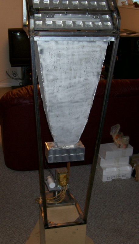

Here is a digital photo of the projector in it's current state. I have bolted the bulb housing and reflector to the main parabolic reflector.
I have yet to install the bulb and wire it up as I am waiting to finish the LCD mount. Actually, the outer glass housing on my bulb was broken at some time during my building process. The glass is still generally in place though and I'm hoping that the bulb will still fire up and the light will work. None of the element or the leads were damaged.
I sand blasted the outside of the big parabolic reflector to clean it up a little but the sandblaster was low on sand so it didn't do the best job. No matter though as the outside of the main reflector will be painted black.
Frankly, there is a lot of hand work to do to get the insides of the reflectors really smooth and shiny. But I think that I will be able to tell if it is going to work when I fire it up even though the light output will be a little reduced.
My big hope at this point is that the LCD will remain cool enough without fans to help in the cooling process.

Today I installed the bulb into the bulb/reflector housing and rigged up an extension cord and lite the light.
It seemed to flicker a little but then slowly came up to full brightness.
Everything seems to be working and I left the light on for about twenty minutes (which was all of the time I had) to try and let the reflector housing get up to a stable temp.
The area next to the first surface mirror got quite warm but the hot air was chimneying right out of the top and the lexan heat shield was not even getting hot. I would say it was around 110 F.
However, my guess is that when I make the reflector more reflective it will transmit more of the IR.
THe bulb housing eventually got about 150 degrees and no hotter. IT was good and warm but not so hot that I couldn't put my whole hand around it and leave it there. I did not actually record an accurate temp. but I think it was around 150 degrees F.
When I have more time I will leave it on longer and record an accurate temp. at several locations.
But I think that it was pretty stabalized and right now it is looking pretty positive to be an all passively cooled design with no fans. I will be very happy if I can keep it dead quite.

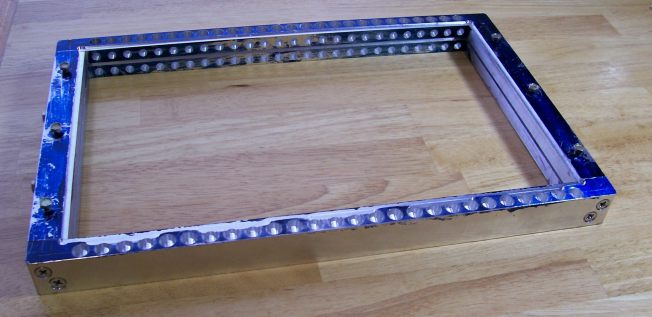

Finally I got a warm day today to work outside,
I spend several hours working on the LCD mounting frame and getting it into the projector frame. I had to do quite a bit of weld grinding to get the LCD mounting frame into the less than perfectly square main frame.
I also build be LCD panel circuit board mount and the controller card will mount on the under side of the frame on a aluminum panel.
Here is a snap shot. Now I think what I have got to do next is cut down the fresnel and put it inside the LCD mount. I am still trying to think of a good way to cut it up without scratching it or cracking it.
