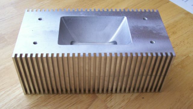

After looking back through the entire thread I realize that I have failed to post pictures of the bulb housing/reflector assembly.
I had gotten tired of running over to the store to get a roll of 35 mm film every time I needed a couple of pictures. Then I would have to get them developed on CD ROM.

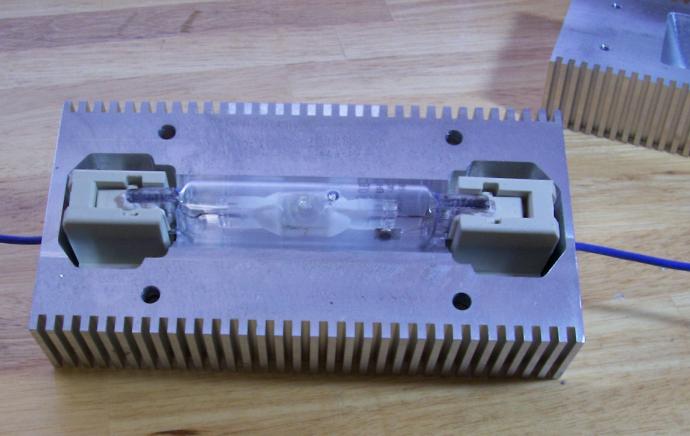

Here are some pictures of the bulb reflector housing. It's design does not leave much room for ventilation but I suppose some cut-outs could be made at certain places if necessary.
It is a two piece affair where the bulb is captures between the two halves. I will need to do some hand work to get the surfaces up to the shininess that I would like.

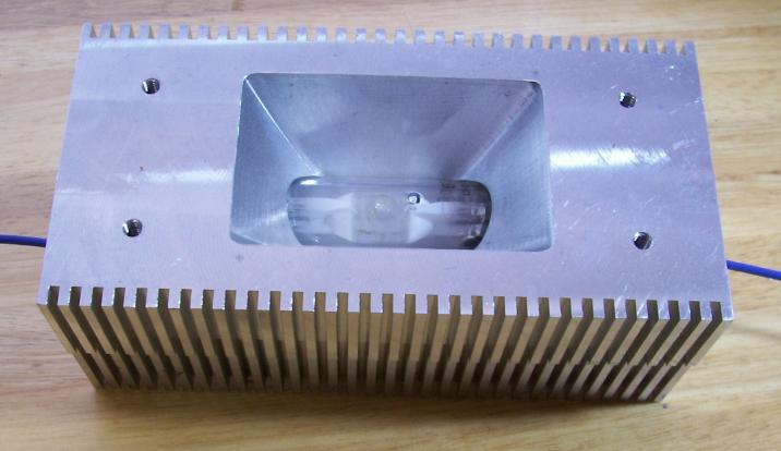

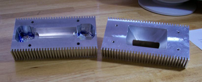

Here is a shot showing the two halves. The unit uses a double ended 250 watt HID bulb. The recess for the bulb cylinder is not round shaped like the outer surface of the bulb but is parabolic in shape in an effort to reflect more of the light out straight.
The focal point for the small parabolic reflector behind the bulb is nearer the rear of the light element and the focal point for the main front reflector is based on the front of the bulb element nearer the LCD.

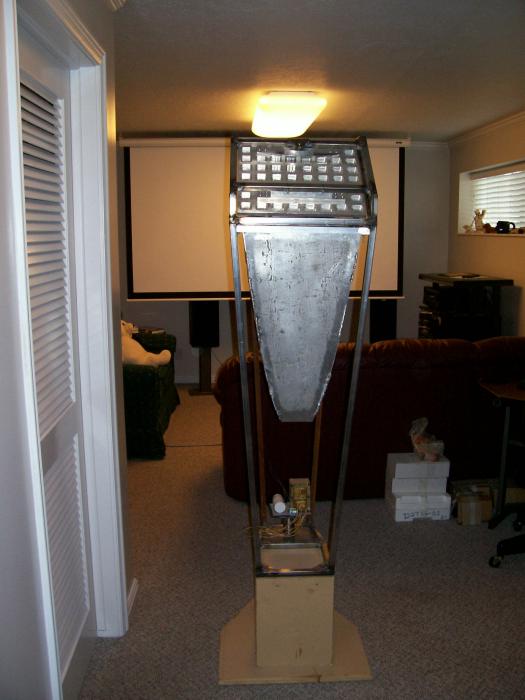

And here is the final shot with the whole thing together. This assembly will bolt to a flange welded onto the main deep parabolic reflecter.
There is little or no room for air circulation and my hope is that much of the heat will be absorbed and radiated into the heatsink.

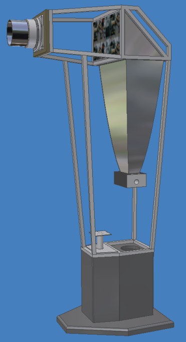

Here is a picture again of the design if you haven't been through the whole thread. I'm expecting to keep the lower part of the frame open to free air. I think my biggest concern is going to be keeping the interior of the reflector from getting too hot.
Anyway, I have an idea for some fan cooling if heat is going to be an issue.

hot design!
It depends on convection to remove heat from the reflector.
Unfortunately, I think it will work as a very efficient convection oven on the inside. All of the selective plastic films depend on some cool airflow to keep them from melting, but all they would see is a steady flow of super-heated air rising from the lamp area.
I think it will work a lot better if you have cool air flowing in at the top of the reflector (between the reflector & filters), and then pulled out around the sockets at the bottom. That would reverse the airflow, so you would have much less heat transfer up toward the filters.
Black anodize or lightly black paint the outside for more heat transfer into the air.

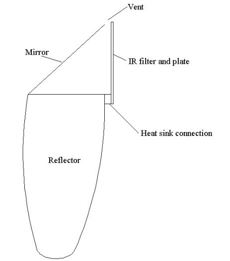

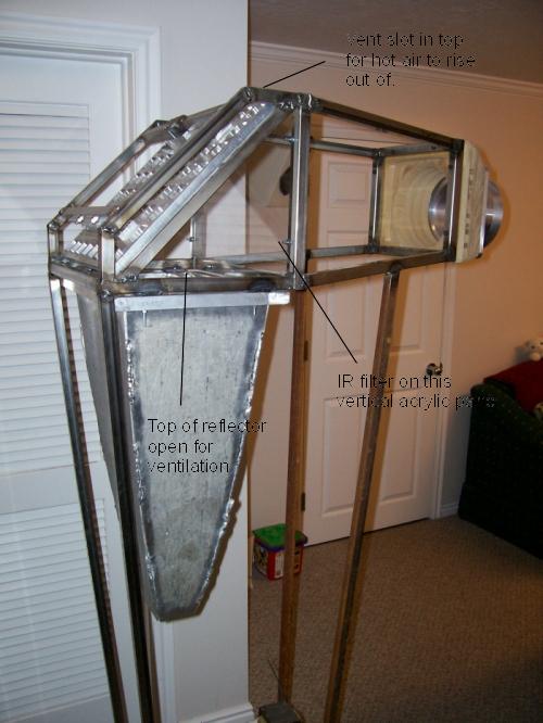

This is my latest idea in an attempt to stay totally passive with no noise generated by the projector.
THe picture shows the large parabolic reflector bolted to the frame. My idea is to leave the large end of the reflector totally open and have a large slotted vent right at the top of the housing for the hot air to escape.
There is a slot about .75 wide and 13 inches wide that is not visible in the picture. Then I will make side sheilds out of very dark plastic to absorb stray light.
The IR film will be on a vertical acrylic or polycarbonate pane which acts as a barrier to keep hot air away from the LCD.

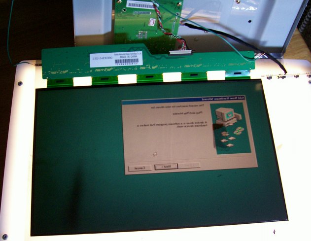

OK, I stripped my proview LCD monitor today and here are some pictures.
I rigged the LCD up on a small light box so I could see it's image orientation in relation to the connectors and logic circuits. You may be able to make out two green wires that are connected from copper ears on each side of the driver board to the metal controller board housing.
These are ground planes that must be grounded for the thing to work.

Thanks for the input, you are correct in saying that highly polished aluminum reflects most IR. For that reason I have decided to use an IR film and keep the reflector housing open instead of sealed.
My goal will be to ancor the IR filter and it's plastic heat sink to the aluminum reflector on one edge so that heat can conduct from the IR filter and plastic shield into the aluminum.
I expect that the heatsink reflector will get pretty hot not from IR radiation but from slow convection. I may have to come up with a way to use forced air through the bulb housing and I have some ideas in that regard.
I will post a sketch of what I have in mind so that you can see what I mean.

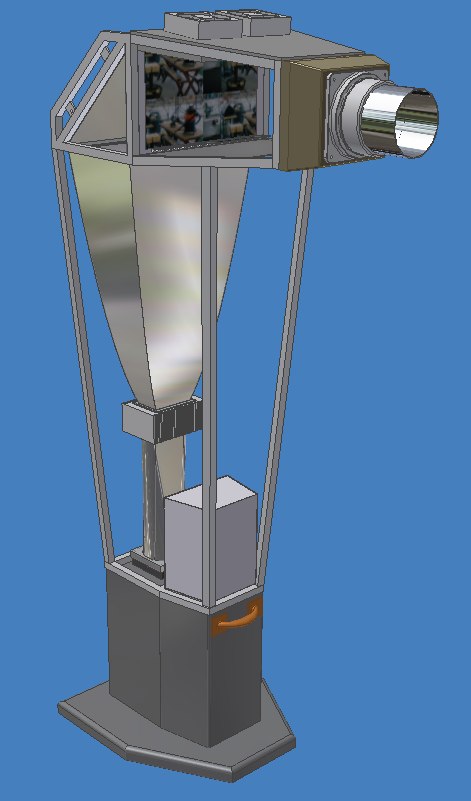

Today I have been mulling over some new design concepts for cooling. I would have liked to have kept this projector a totally passive design but I am unsure if that is practical or not. Especially for the cooling of the LCD.
In order for the LCD to be reliable in the long term it needs to stay below 100 degrees F.
After thinking about some cooling methods for the LCD I could not come up with any ideas that I thought were adequate within the frame that I had made.
Then I spent a couple of hours modeling on the computer and this is what I have come up with.
The new design involves the use of two quiet slow turning fans to draw cool air in between an air space between the plastic heat shield and IR film and the fresnel and LCD. In order to keep this thing quiet I may opt for two 120 mm quiet computer fans turning at around 400 - 500 RPM.
The design also includes a fan duct that blows a small amount of cool air into the bottom of the bulb housing through two 1 inch diameter holes. There is a certain amount of restriction so not a lot of air will being moving across the bulb but it should be enough to keep things cooler than without.
