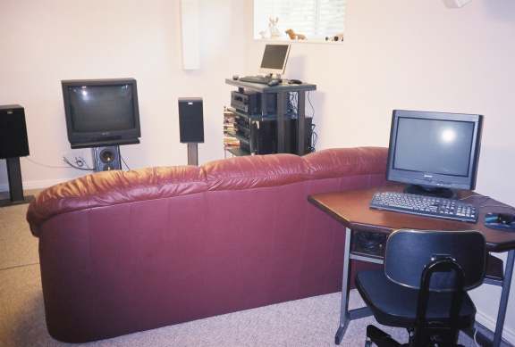

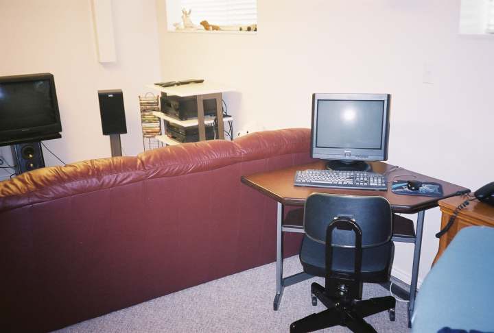

Here are a couple of pictures on my projector project. It is moving kind of slow because I had to build a computer table to go in the corner and also new A/V rack. The rack is almost done and will replace the old one that is shown in the picture. It is designed to house a large case tower computer for the HTPC to drive the projector.
Also shown in the picture is the new backup internet computer on the corner computer table. I wish I had a picture of the A/V rack as it is looking pretty good.

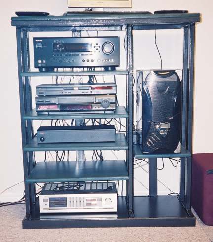

Things have been a little slow on my projector project as of late but I did finish my new A/V rack and I have my HTPC up and running again with one less HD which overheated. I do not particularly like this HTPC case but it was a good deal and has very good cooling properties even though it is a little to deep for the rack. I have a custom water cooled design that I might build in the future.
Here is a photo of the new A/V rack.

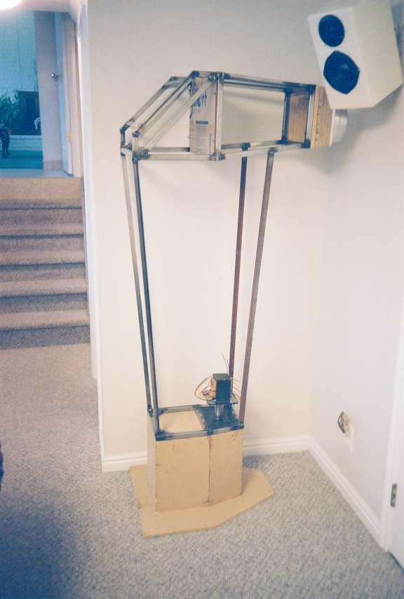

Here is another of the A/V rack from another angle.
I have also been working on the light engine and have the lower bulb mount roughed out of aluminum. I will post pictures on that soon. I have got the patterns printed for the deep parabolic reflector and now I need to cut out and polish the aluminum sheet.
