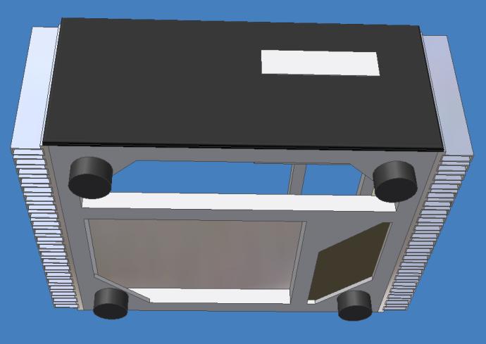

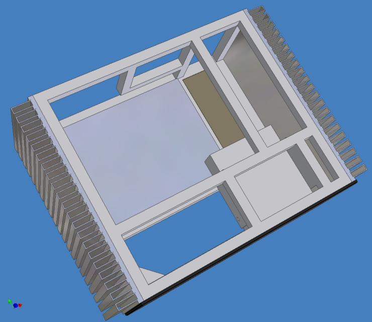

HTPC meltdown,
Well it actually happened. I had a heat meltdown of my HTPC. I suspected this would happen when I first bought the Antec Overture case.
Note: I do not recommend this case for a HTPC if you are going to do games or run dscaler.
This is a good looking sleek and quiet case. When I first bought it I needed a quick and resonably priced case for my HTPC that would kind of blend in with the HT equipment. When I opened up the case for the first time I noticed that it was going to have some heat issues under heavy loads but I liked it's quietude so much that I kept building and experimenting.
This case is unusual in that the PS is up front and sucks air in. It seems to work from a low noise perspective but the case fills with warm air from the PS unit. There were to other quiet venting fans so I thought that all would be Ok.
The HD's are mounted near the back exit fan supposedly to cool them. The only problem is that they are being cooled by really hot air from the PS and the CPU which is right next to it. IT's a bad design for cooling issues without some modifications.
After running dscaler for about half an hour the HTPC started spontainiously rebooting. I then think the HD data became corrupted as the OS won't boot at all. I'm hoping there is no hardware damage.
I have decided that I need to take a more industrial approach an build the ultimate long term HTPC case. There is only one case that I would consider and even most 250 USD cases are not adequate in my book.
So I am going to embark on a high end home made design which is a hybrid approach of heat pipe technology and slow turning fans.
Here are models of my work so far. The heatsinks are large homemade units made from machines flat plate and rectangular .5 x 1.5 inch extrusions. There is no HD mount as of yet as I am thinking about how I am going to do that.
Hezz

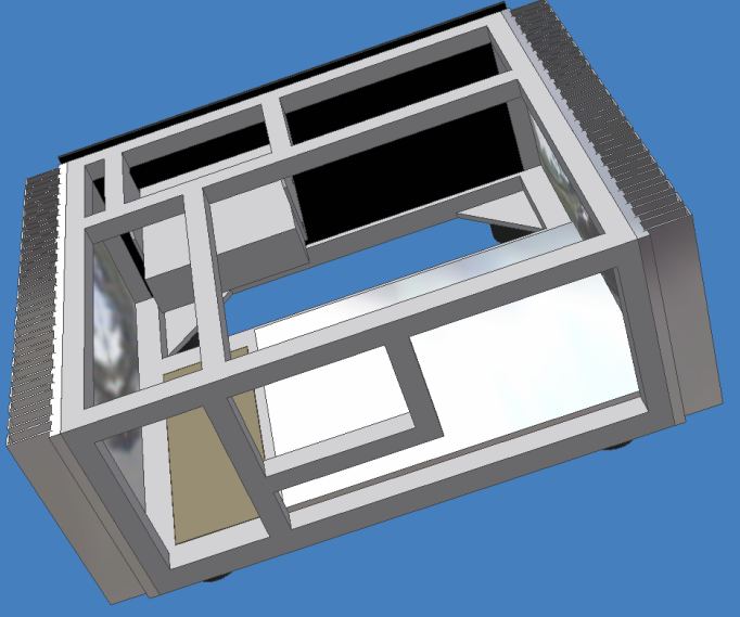

I bought a Antec CS300 at compUSA to serve as a donor case for the rear panel assembly and to get precise measurements. It is an upright tower case which is cheap but well designed and has no PS for 24 USD.
The case will use heatpipes to carry heat to the large homemade heatsinks on the sides of the case. One for the CPU and one for the GPU. The case will have a normal ATX silent as possible PS and one quiet 90 mm fan turning at around 600 - 900 rpm.
The case is completely sealed except for a large open area at the bottom front of the case which draws cool air in and to the back. In my opinion even though the CPU and GPU will need no fan cooling the rest of the system needs a little air movement to keep things long term reliable. Memory and chipset heatsinks work best if there is a little airflow in the case.
Another pic. Frame is from welded .75 and 1 inch tubular steel.
Hezz
Hezz

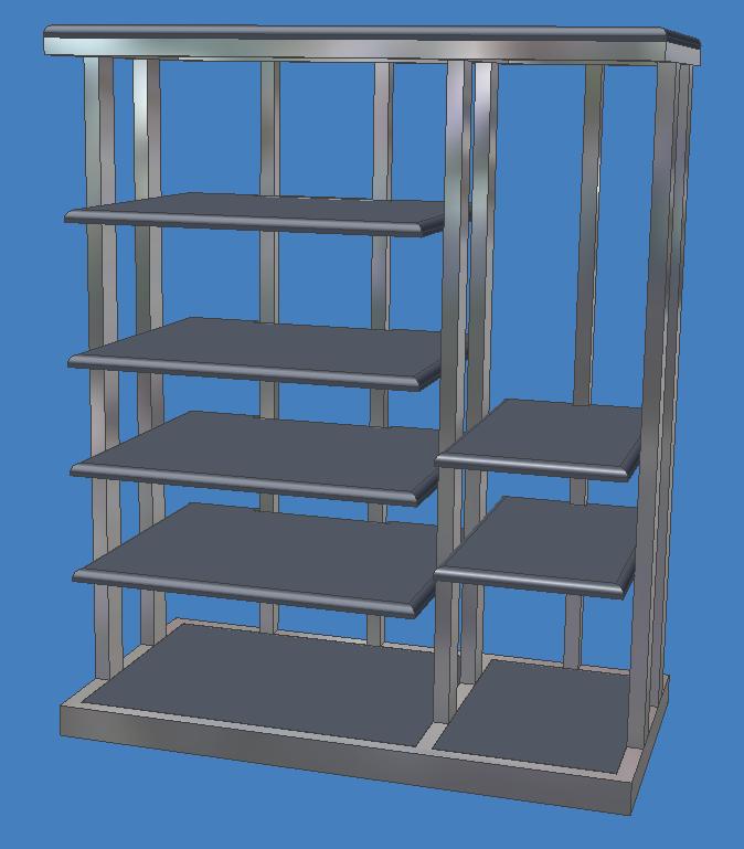

Guys,
These last few posts have been a little off topic but I view this projector building project as a total home theater experience with everything that goes with it. Hence the HTPC design models.
Now as with everything else I have changed my mind about what I am going to do with the HTPC. In the past I have always had better luck cooling and quieting hot CPU's with a tower case. While the tower HTPC case will not fit into most equipment racks I have designed what I think for me is a better solution.
There are a lot more choices available for a case with an upright tower case and I like this idea because tower cases will be the dominant platform for well into the future. Therefore, there will always be more and cheaper choices. Using a modded tower case will make it easier for me to get my HTPC back together sooner and for less money.
I have therefore decided to redesign my AV equipment rack to take advantage of the flexibility that a tower case has. The new rack will only be slightly wider than the old one and a little taller. Plus the top surface will be free of any piece of equipment so that I can use the space for the keyboard and mouse and remotes.
Here is the design solid model. I had already purchased some of the metal for the first HTPC heatsinks and frame but I guess I can use that for something else. This will be easier to build. With this rack I have enough space for the tower HTPC and it's UPS. Then on the receiver side I have the A/V receiver, the DVD and VCR and the AC line conditioner and the external subwoofer amplifier. I will then have one bottom shelf left over so that in the future I can use an outboard two or three channel amp for the front speakers.
The design is similar to the old one in that the shelves are mounted with hidden mounting bars that give the illusion of floating shelves and make for a less metal heavy appearance.
