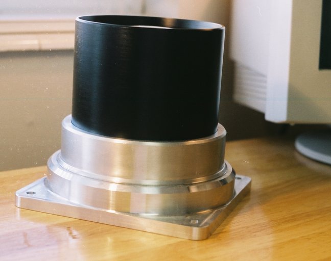

But I just put together a lens mounting for the 571 mm fl 142mm diameter positive meniscus lens I got yesterday, and I am getting three-color-stripe screendoor all the way across the screen.

Guy, I don't understand what you mean.But I just put together a lens mounting for the 571 mm fl 142mm diameter positive meniscus lens I got yesterday, and I am getting three-color-stripe screendoor all the way across the screen.

It focusses so well, that I can see the individual columns of red, green, and blue sub-pixels when I get a couple of feet from the screen, and it does that in the middle and all the way to the edges of the image.
In other words: It works pretty well!
Actually, now that I have fiddled with it a bit, I can see that the middle and the edges don't focus at exactly the same place. I can get either one really sharp, but it looks best in the compromise position with middle and edges not quite perfect. Masking out the extreme sides of the projection lens made it a lot clearer. (This discards the rays coming from the ends of the lamp arc.)
I am also seeing some "fogging" at the bottom of the screen: White letters light up a black background. I think that is probably because I am using a normal second surface mirror in the image path. (But I have no idea why I only see it at the bottom of the image!) I put it in there so I could see how big a first surface mirror to buy. Maybe I am seeing a light leak. I'll try adding some black cardboard around the condensor lens to see if that is the cause.

I think you might be correct in assuming it to be the mirror. The greater the angle of incidence the more the light will be reflected from the glass surface instead of the mirrored surface. So the bottom of your screen would appear to have two light sources, one from the glass and one from the mirror, more so than the top.
Good to here you are getting things to work. Are you using a single meniscus?.
DJ
Guy,
If your miniscus is a singlet lens the color bans are probably the
result of color abberation. Single lenses are not color corrected unless they have a complex aspherical surface. The different colors focus at a slightly different place because they each have a different degree of refraction.
This is the problem that multi element lenses seek to avoid.
If your miniscus is a cemented triplet then I would say the problem lies elsewhere.

great results now
Turns out, my fogging problem was spherical aberration from the condensor lens! I started playing with it's position to see if I could get rid of the unlit corners, and I could not get it close enough to the lamp arc. (I have a 15/8" diameter bulb and a hot mirror filter before the condensor lens location.) So I tried replacing the 165 mm fl condensor with a 200 mm fl lens, and then a 220 mm fl lens. Still not wide enough to fully light the corners. I gave up for now on using a condensor lens, and readjusted the location of my fresnels to focus on the lamp arc without it.
This is a bit dimmer (with a 15" LCD, condensor doesn't collect all that much more light), but it became much sharper. All the fog is gone. I do see second surface reflections on white letters against a black background. They appear as ghosts just on the top edge of the letters: exactly as I expected.
The three color stripes I can see when it is sharply focussed are not chromatic aberration, because I can see it right in the center of the screen! It is the fine structure of the LCD pixels: Red, green, and blue columns. It looks just the same at the center, and all the way to the top, bottom, and sides of the image. of course, this is a 1024 by 768 LCD, so I have to be just a foot away to see the subpixel columns.
So this tells me my hypothesis about lenses is correct: You don't see many triplets above 500 mm fl, because nobody needs a triplet with that low a magnification. For a 571 mm fl lens with a 15" LCD, a 100 mm diameter positive meniscus works just fine, because the field angles are so low. I also tried the ~525 mm fl symmetrical duplet I made for $20, and it works very well, too.

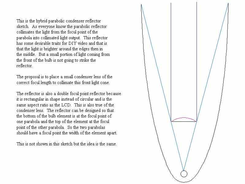

Guy,
good to hear of your experiences. It seems from other other
builders experiences that I have read over the last couple of years that the light engine is the hardest part to get dialed in.
If you have to get within one foot of the screen to see the screen door or the individual pixels that sounds like pretty good performance. From many of the sub 2000 dollar front projectors you can see the screen door from as far away as ten feet.
I am posting my lastest light engine idea but the second part of the light recycler will have to wait because I had the TurboCad sketch nearly completed and I forgot to save it when my computer suddenly and mysteriously rebooted. Must have been some hardware thing. I lost about a 3/4 an hours work and I am too lazy to go and redo it right now.

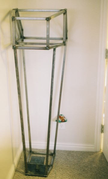

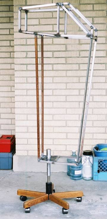

Here is a picture of the frame during construction.
not a lot is happening at the moment on the projector as the wether is bad and I have to work outside. I did start working on the DIY first surface mirror. The piece of aluminum cost me 30 USD so it will be a little bit more expensive than buying one but there are some advantages. First the mirror is exactly the size that I need and since this projector frame can accept 17 inch widescreen LCD and 15 inch 4:3 and widescreen I will have a mirror that will work with any LCD size that fits the frame.
Since it is going to cost about 700 - 800 USD to get the high resolution 1920 x 1200 LCD in 16:10 aspect ratio. I am thinking about getting a cheaper used 4:3 15 inch LCD to get started. Then I can upgrade. I will built an anamorphic lens to squeeze the 4:3 picture into 16:9 and 2.35:1.

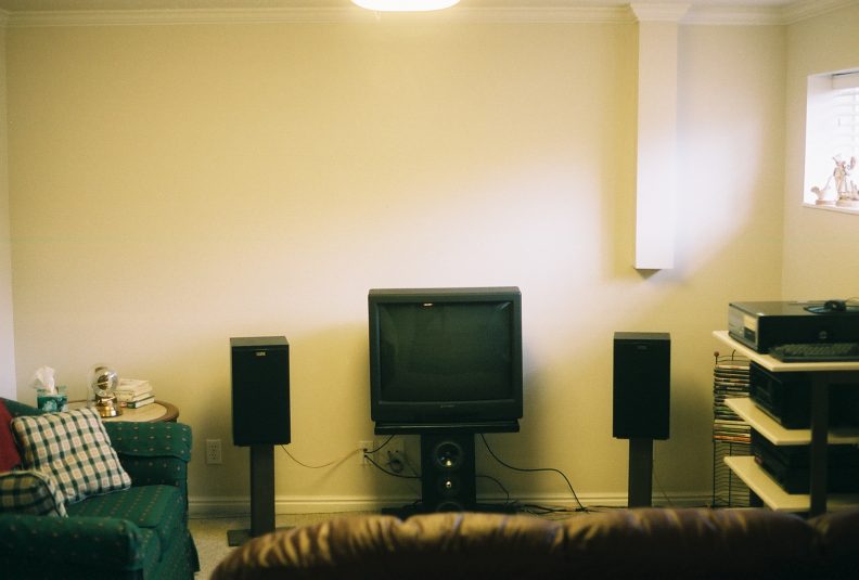

I have had to do some major reorganization for this projector project. First I put the prior TV stand and equipment rack over agains't the right hand wall because it was too high to allow for an image to be projected on the wall. The rack was a custom made one the I built and now it works pretty good with the HTPC on top instead of the TV.
In this picture you can see the HT layout that I am trying to achieve. I rebuilt my Madisound center channel speaker into a custom TV stand/center speaker and it works really well except that I think I still need to lower the TV about four more inches.
Here is a picture of the HT layout as of this date. I have some customed designed speakers that I am going to build in the planning stages and I have designed a two way center channel stand that will drop the TV down about four more inches.
Hezz
Hezz
