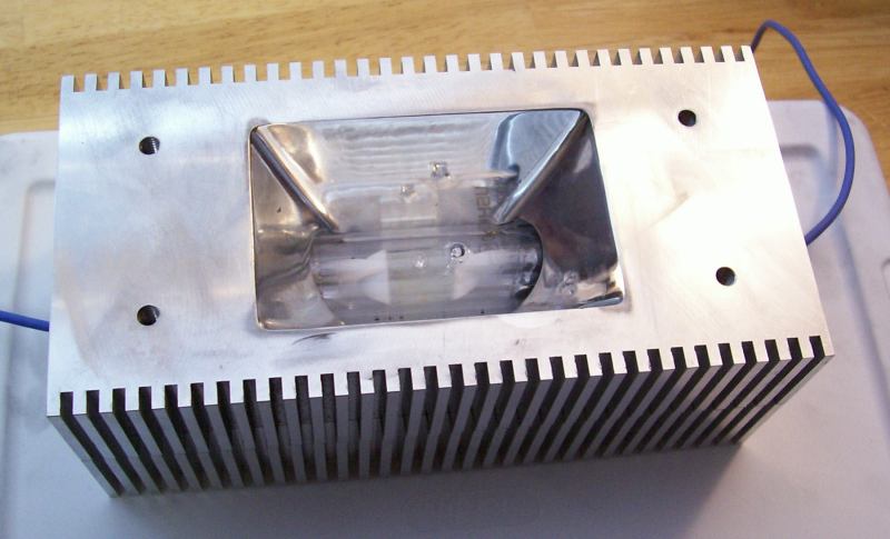

I have been working at the lower bulb housing reflector and have the uppermost part polished. It is much more reflective and shiney than before.
Here is a picture of the reflector. Though the surface is quite reflective I don't believe that I will realistically be able to get this curved surface really true. You can see a bit of the blurriness in the reflectied image of the bulb.
I am quite certain that I can eventually get the large parabolic reflector about this quality. I hope that it is enough to allow for the projection of an image.
Nice lampholder. If it gets too hot, I am sure you can manfacture a larger add on heatsink to dissapate some more heat and not have to go down the route of forced cooling and stay passive. If it gets too hot then you might want to put a heat guard on it!

I think that it will be OK because it still is not too hot to burn. If you were to hold your hand around it it would scald you but a momentary touch will not cause a serious burn. I estimate that it is around 180 degrees F.
I've also done some more polishing of the main mirror and it is showing a much better reflected image than before.
It turns out the parabolic reflector will be too difficult to polish because of the surplus metal I made it from. So I have ordered some 98 percent reflective mylar to line the parabolic reflector for the next test.
This should give me enough of a quality reflective surface to proof out the design and see if it is a feasable solution.

Update,
I have done some more testing on this projector design and it now appears that the light engine design has some flaws that will render it unuseable for a projector.
There is some good news however. I have been able to keep the projector cooled with totally passive means. Although the bulb housing gets hot the LCD and other important things stay quite cool.
I have polished the first surface mirror to a higher degree and also the bulb housing reflector assembly.
Because I had made the big parabolic reflector with surplus aluminum to cut down on it's cost (I wasn't sure if I could even build it) it would have required too much time to hand finish to a high degree of shine. So I ordered some 98% reflective mylar film and lined the reflector with this. It was pretty much impossible to get the mylar glued down perfectly flat with the adheasive that I used. A high temperture silicone gasket material.
I wanted the glue to be able to take any heat that was generated in the parabolic reflector.
In any case, the parabolic reflector with the mylar was much more reflective than without but is far from what it should be in terms of surface uniformity due to some air bubbles and wrinkles that I could not get out.
I know that the reflectors performance would be impaired but I figured it would be enough to see if the reflector is working. Unfortunately the reflector does not properly collimate the light and I now have a couple of theories as to why it is not working.
The first has to due with the rectangular cross section of the reflector. This reflector was designed this way for two reasons. One, because I wanted a light output that was roughly the same shape as the LCD monitor. Second, it made it possible to make.
Typically most parabolic mirrors are of a circular cross section. This would have been too large to deal with for the size I was making. Also it would have been very expensive to make.
The jest of why I think that my parabolic reflector is not collimating enough light has to due with light from the bulb element that strikes the interior reflector walls at oblique angles which is most of the light.
With a parabolic mirror with circular cross section more of the oblique light rays are bent in towards the middle of the reflector so a lot of light stays in a straighter line. The problem I seem to be having is that too much of the light is being sent out in a wide pattern at the mouth of the reflector. I can only surmise that this is because that oblique light rays from the bulb are seeing a straight wall and so are not bent in towards the center of the reflector.
In any case, the light output is too dim to be useful which is unfortunate as the projector is totally silent except for the ballest hum which can be rectified with a better electronic ballast.
As such this frame design is gong to be scraped and I will use the lens and LCd mount and LCD to build a more conventional design. Now that I have my HTPC back up and running I would like to at least get someting projected on the wall.

Update,
With the room as dark as I could get it the projected image is watchable but significantly too dark to see details. However, with the room darkened I have been able to pinpoint a lot of stray light problems that have been reflecting out onto the image.
I have taped them over with duct tape as a temporary fix but the room is still not totally black because of all the stray light leaks from the open frame.
At least I was able to watch Star Wars. I have the screen at only about 90 inches to conserve light from the intended 106.
It also seems that I was wrong about this lens. It seems to be working better than I had thought. Once I had the room darker and put on my glasses I was able to focus the lens a lot better. Down to where I can see the spaces between the pixels. Even out to the corners of this 15.4 in widescreen LCD the focus is adequate for watching movies. There is still some less than razor sharp imaging going on but it is adequate to read the icon writing on the Windows XP icons. It would probably become irritating for internet cruising.
When watching with the original widescreen aspect ratio in PowerDVD the blank bars at the top and bottom of the screen keep the image in most of the len's acceptable field of view.
It looks like the real weakness is the light engine which is not bright enough. After two hours of running a movie the bulb housing got about 200 degrees F but everything else seems to be OK. Also, since I have taped up so many of the stray light leaks the projector does not cool quite as well as it did before when it had so many light and air leaks. But it still seems respectable and is running without a heat problem.
I may try a reflective polarizing film if I can get some cheap to see if I can gain any brightness. Other than that I think that I will start saving to buy parts for the next projector project.

nothing wrong with your LCD
If I were you, I wouldn't give up on the 15.4" LCD. It already has the resolution you need for 720P HDTV, and it works with your lens. All you need to do is to fix the light engine problem.
That problem is that the lamp is too far from the condensor fresnel. Without the reflected light, the inverse square law applies. The 790 mm long fresnel puts the lamp so far away that not much of the light is falling on the fresnel.
I would get a 200-220 mm fl fresnel and move the lamp arc up to that distance from the fresnel. You should get 790/200 squared more light: 15 times brighter!
Hey Guy,
Thanks for the feedback. I actually have a 220mm fresnel that I could use but the frame would require a redesign. However than is certainly possible.
Also, in spite of the fact that the light engine is a hybrid design other than the low light problems there seem to be some pluses which lead me to think that it might be wise to continue using this topology for further experimentation.
I have also come up with a light recycling idea that is rather simple to initiate.
Some pluses of the hybrid design are that the lighting is very even all across the LCD.
I will posts some sketches of the ideas that I am having. Actually I think that I could put in a condenser fresnel with a nine inch focul length and put the bulb at about ten inches away without any redesign of the projector frame.
The light recycling method would only require a piece of reflective polarizing film and one quarter wave retarder film and one piece of quarter inch think acrylic sheet.
