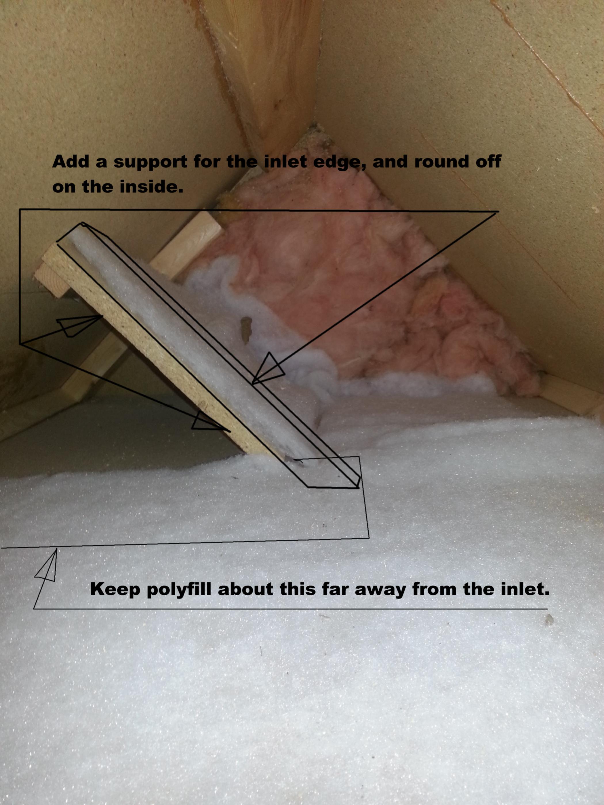

Hi Bach On,
Keep the pictures coming.
I have one suggestion for the port/vent/duct inlet, that is to support the edge that is now just a board, and round of the inside inlet edge before you finish glueing all this together. The exit looks good. Keep the polyfill away from the inlet, while it is probably not affecting anything, you just don't want any fill/stuffing between the driver and the port (or, at this time, in the port).
Hi Bach On,
Hmm. Getting that support in there firmly is going to be tough. My body is a bit large for that narrow triangular box. But I'll see what I can do. Removing the batting adjacent to the port is much easier.

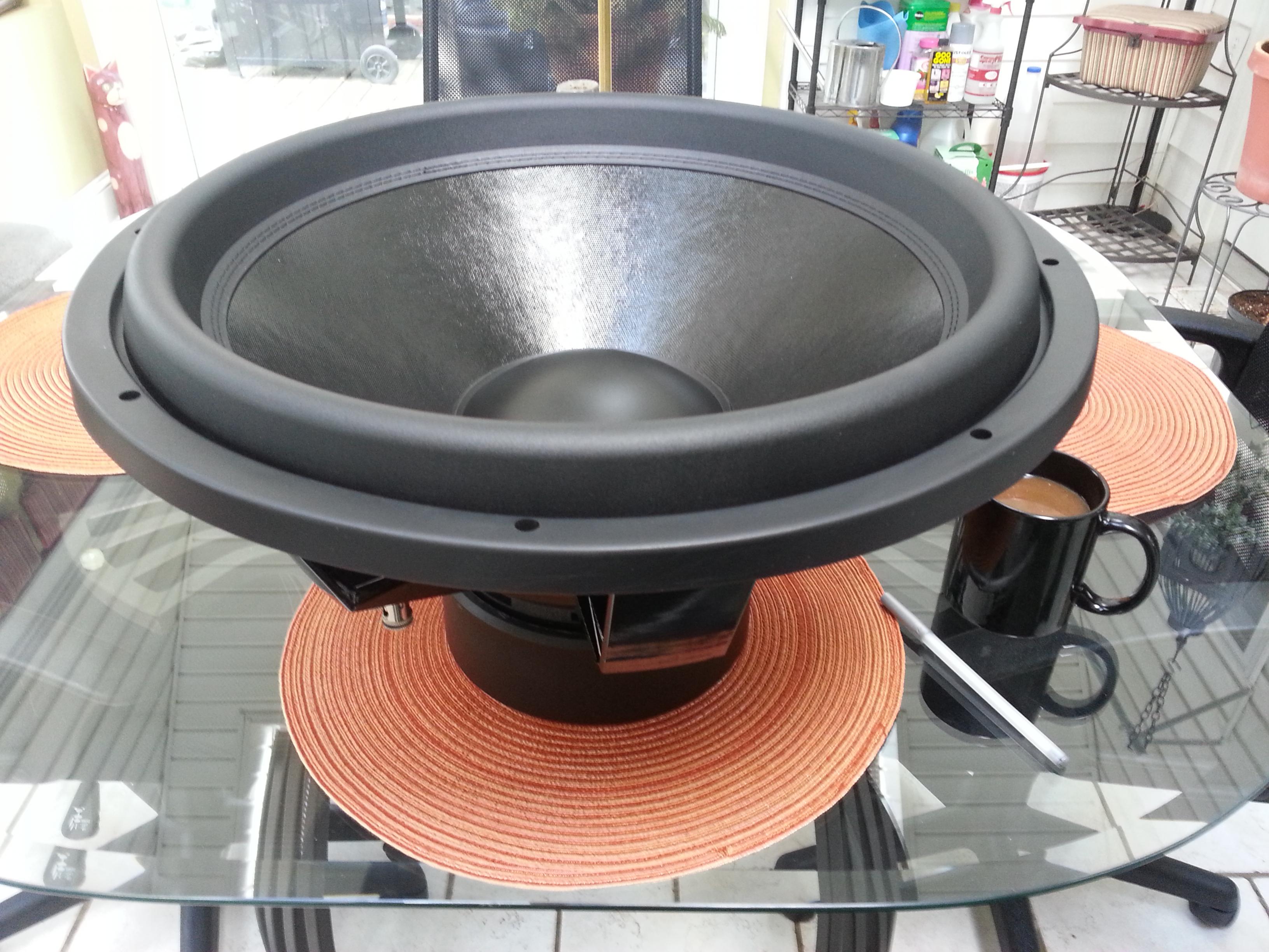

Finally got the new driver from Stereo Integrity today. This one is the HT18. I updated my order to the version with dual 2 ohm voice coils. The dual 4 ohm version won't ship until sometime in July. The coffee cup and pen are there to give it perspective. This thing weighs in at 37 pounds. It has a 21 mm Xmax and is rated at 600 watts RMS. The cost was $174 - which seems to be a very good deal.

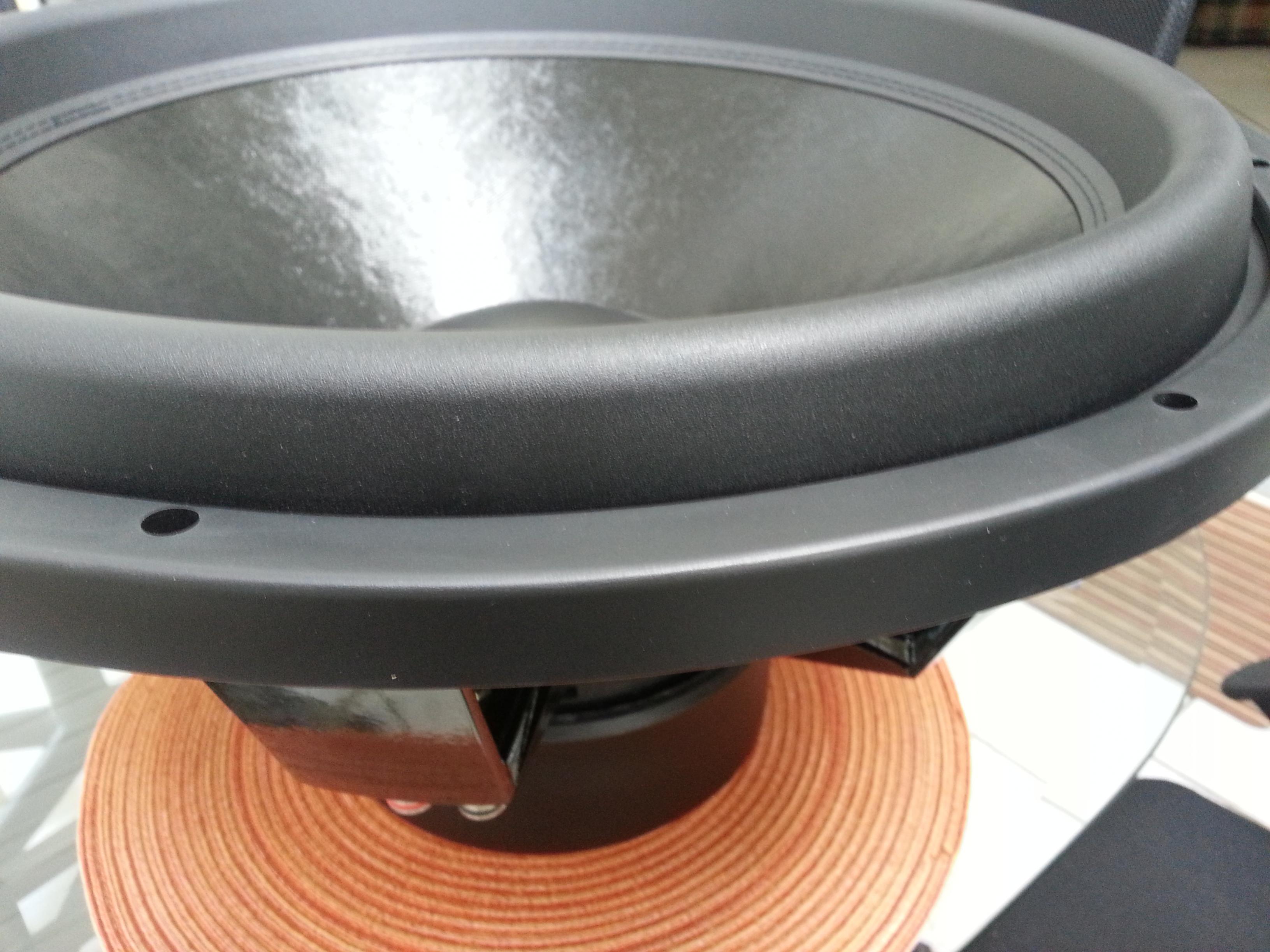

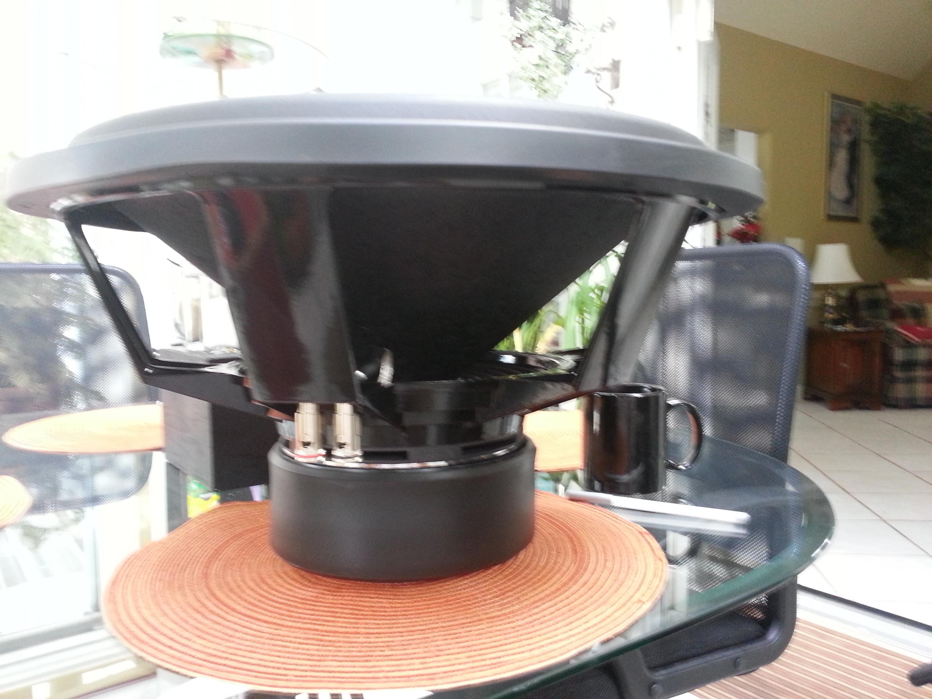

Here's a picture of the side of the thing. Notice the speaker surround is raised almost an inch and a half above the frame. And the distance to the rear of the motor is nine and a half inches.

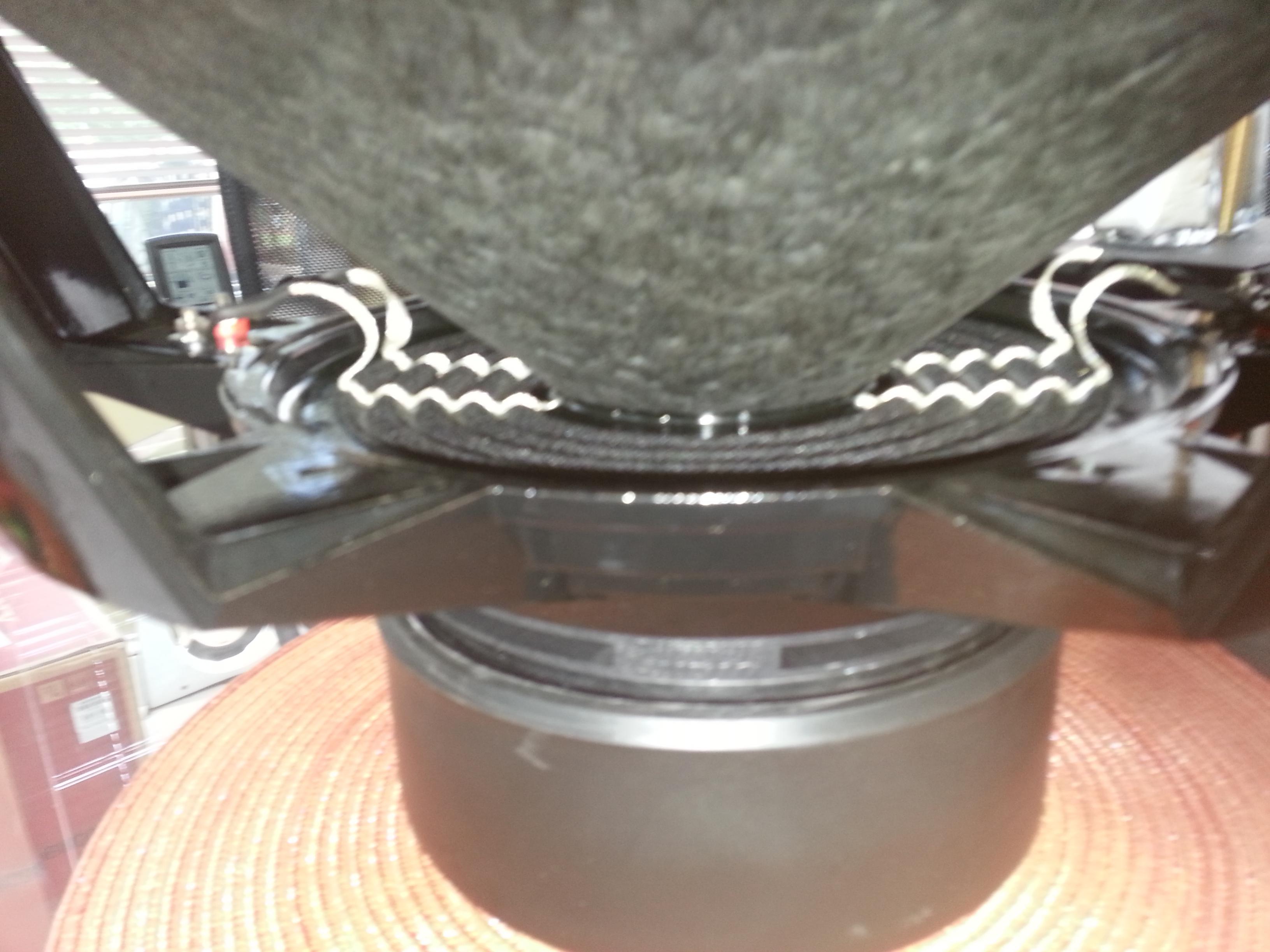

The electrical connections look pretty serious to me. You could even fit those Monster cables in the connectors.

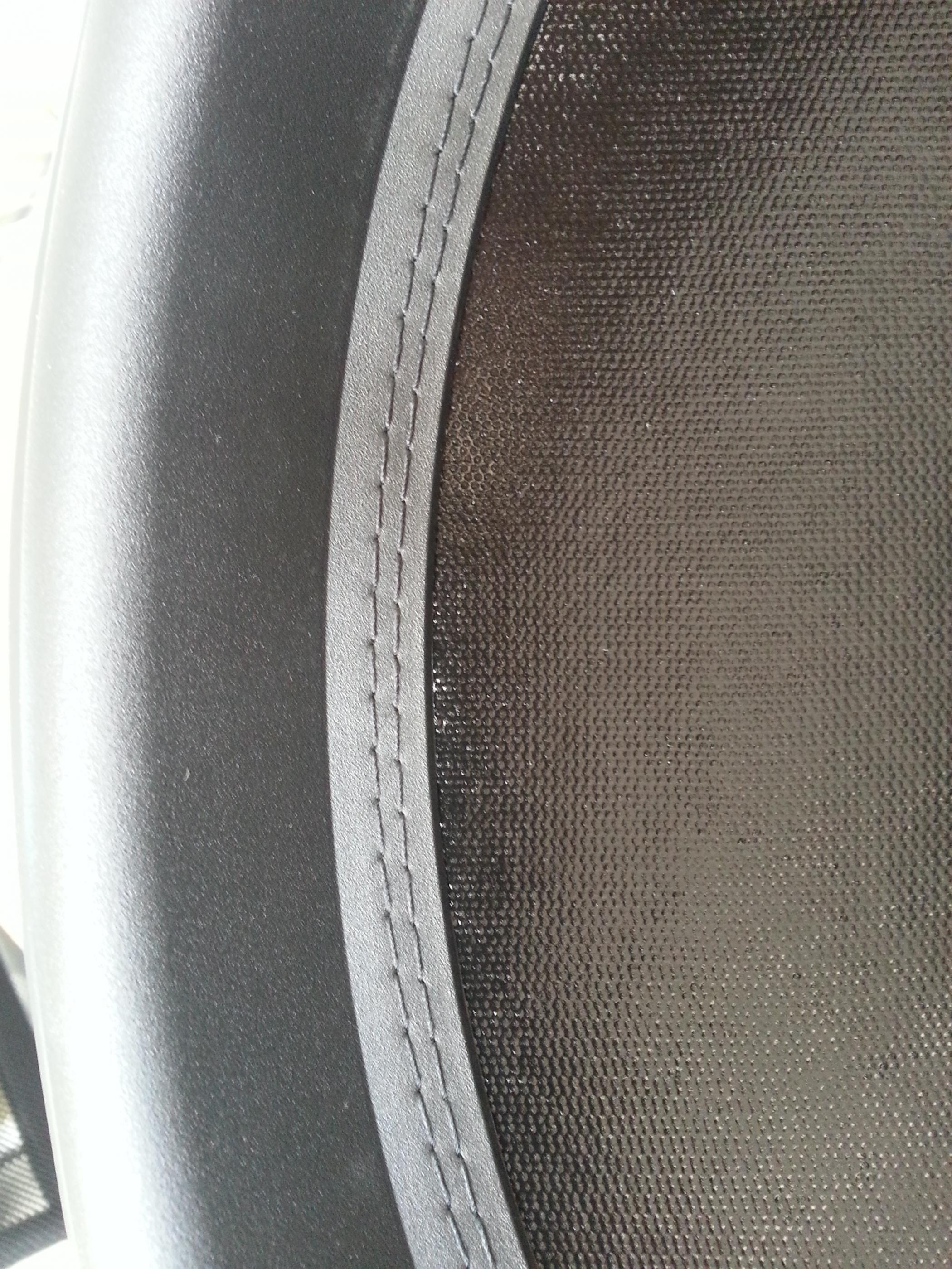

The rubber surround is actually double stitched to the cone.

Nice pictures. You'll need some help mounting this one, and you'll need some protection for that protruding surround.
