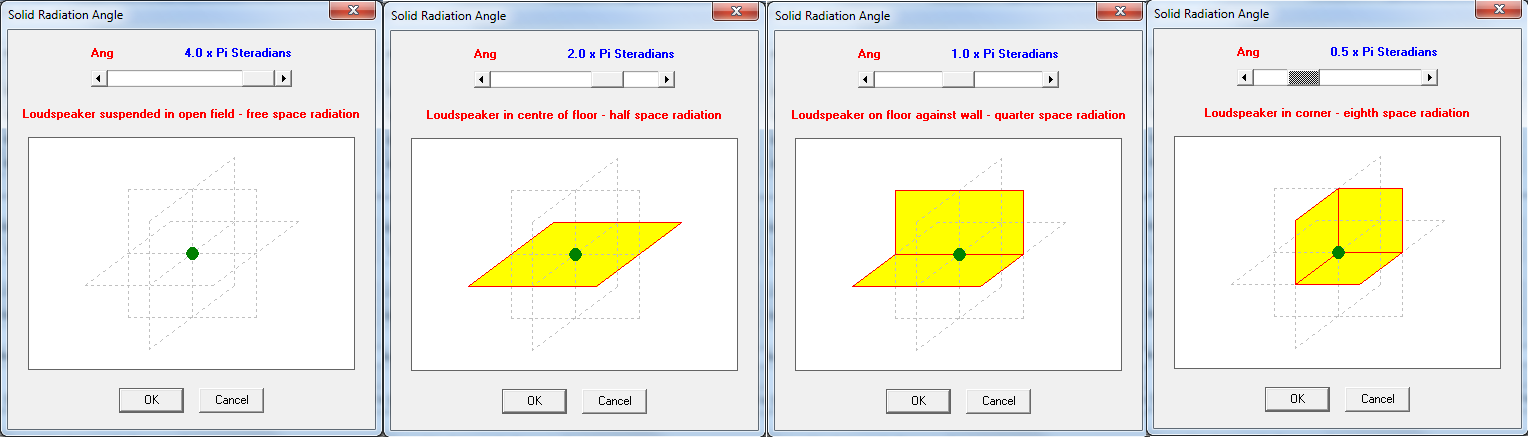

It seriously depends on the construction of the walls of the building and how far away they are.
The organ loft will close to a wall. If it is of conventional stick framing and sheathing it is essentially invisible below 30 hertz. If there is brick we are much better shape. Stone likewise. You need mass to reflect the sound waves.
Definitely inside this building we are 2 Pi at the worst. And that type of loading will increase to 1 and even .5 as the frequency drops.
You need an architectural acoustics simulator to really get you in the correct ballpark.

Now for some pi:
MMM. Pie...
The yellow parts are the reflective surfaces. None for 4Pi. One reflective surface like the ground for 2Pi. Two reflective surfaces for 1Pi. And three for 0.5Pi.

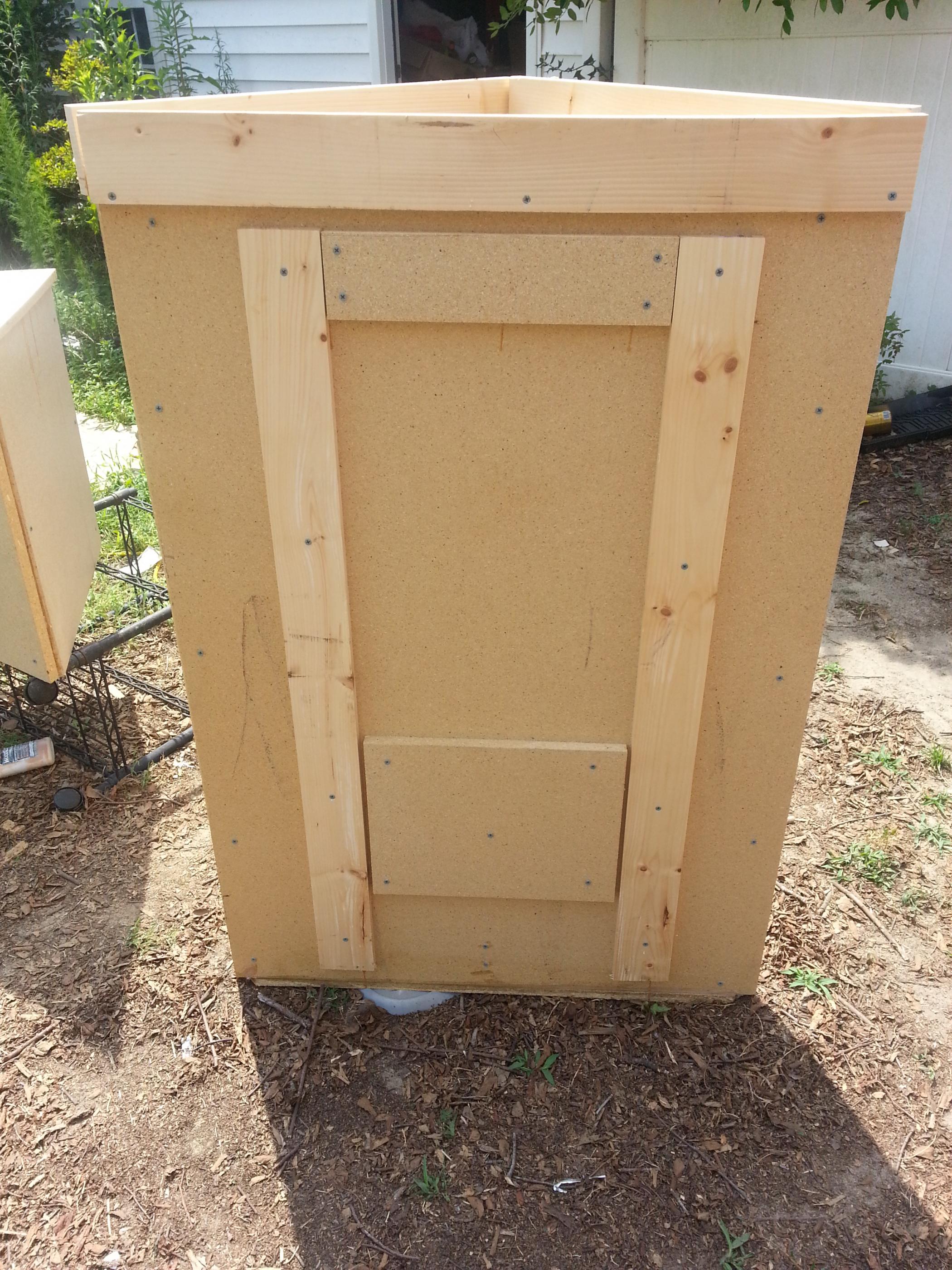

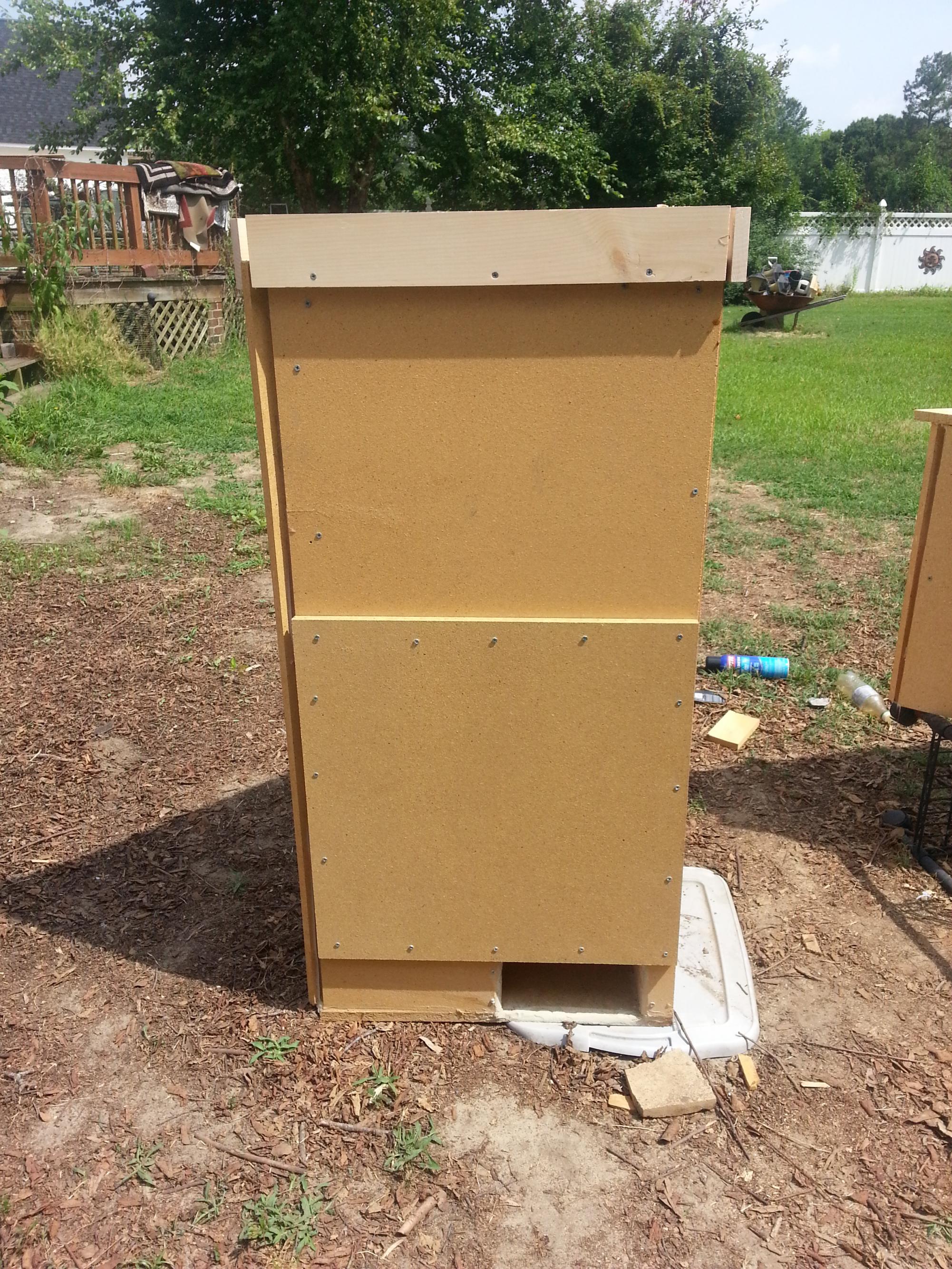

Here's the front view of the lower portion. The height is a nominal 49 inches, counting the bottom. You'll notice the front face has a second layer of board where the speaker will be positioned. This is partly to re-enforce the face. It also serves to bring the driver forward a bit so the motor doesn't come in contact with what I've called the hypotenuse board.

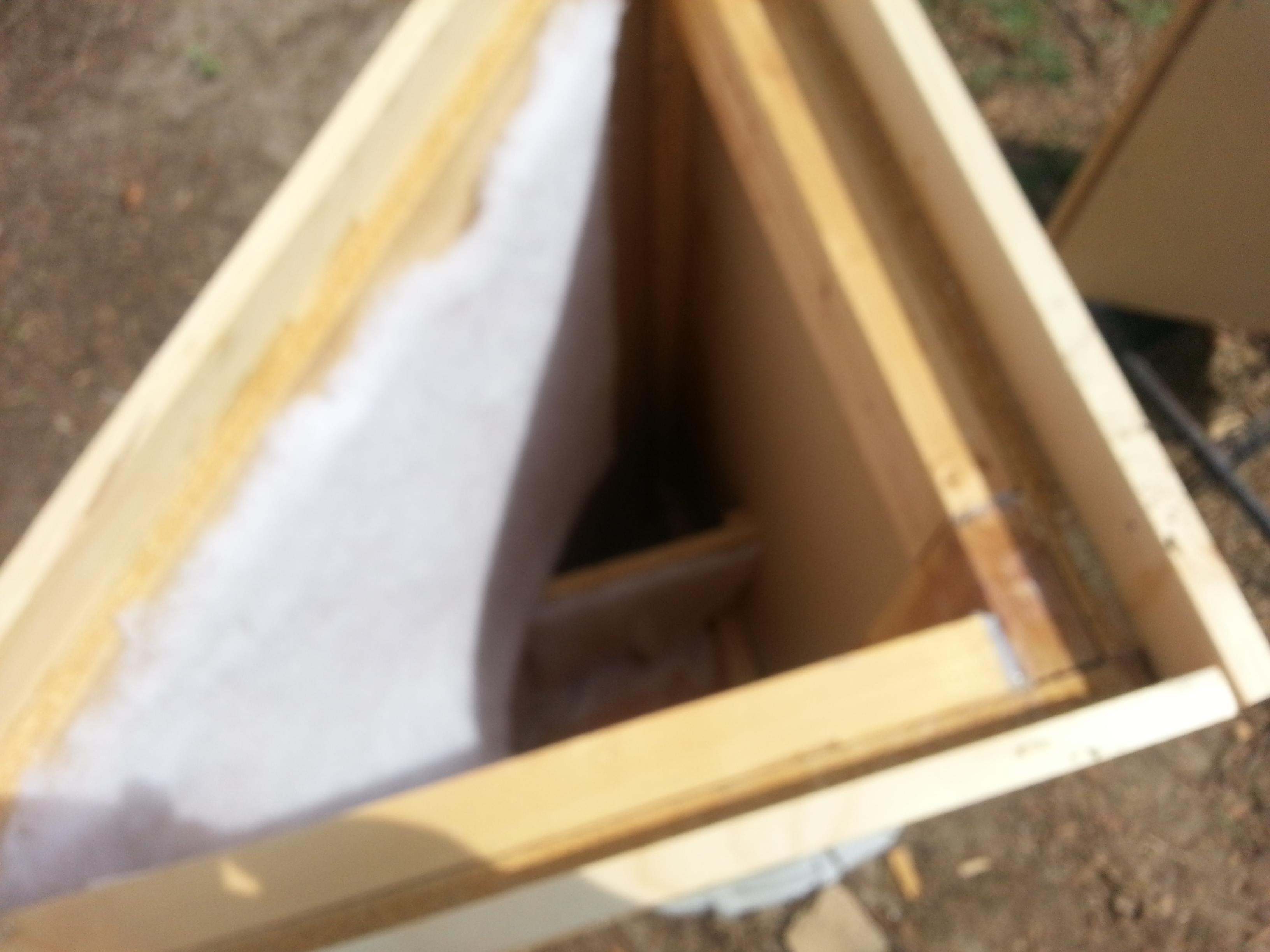

I put boards to create a flange around the top of the vertical boards. The plan is to put the larger box in place in the corner of the speaker chamber. Then I'll apply PL Construction adhesive to the top boards around the perimeter. Here's a rather fuzzy shot showing the area.

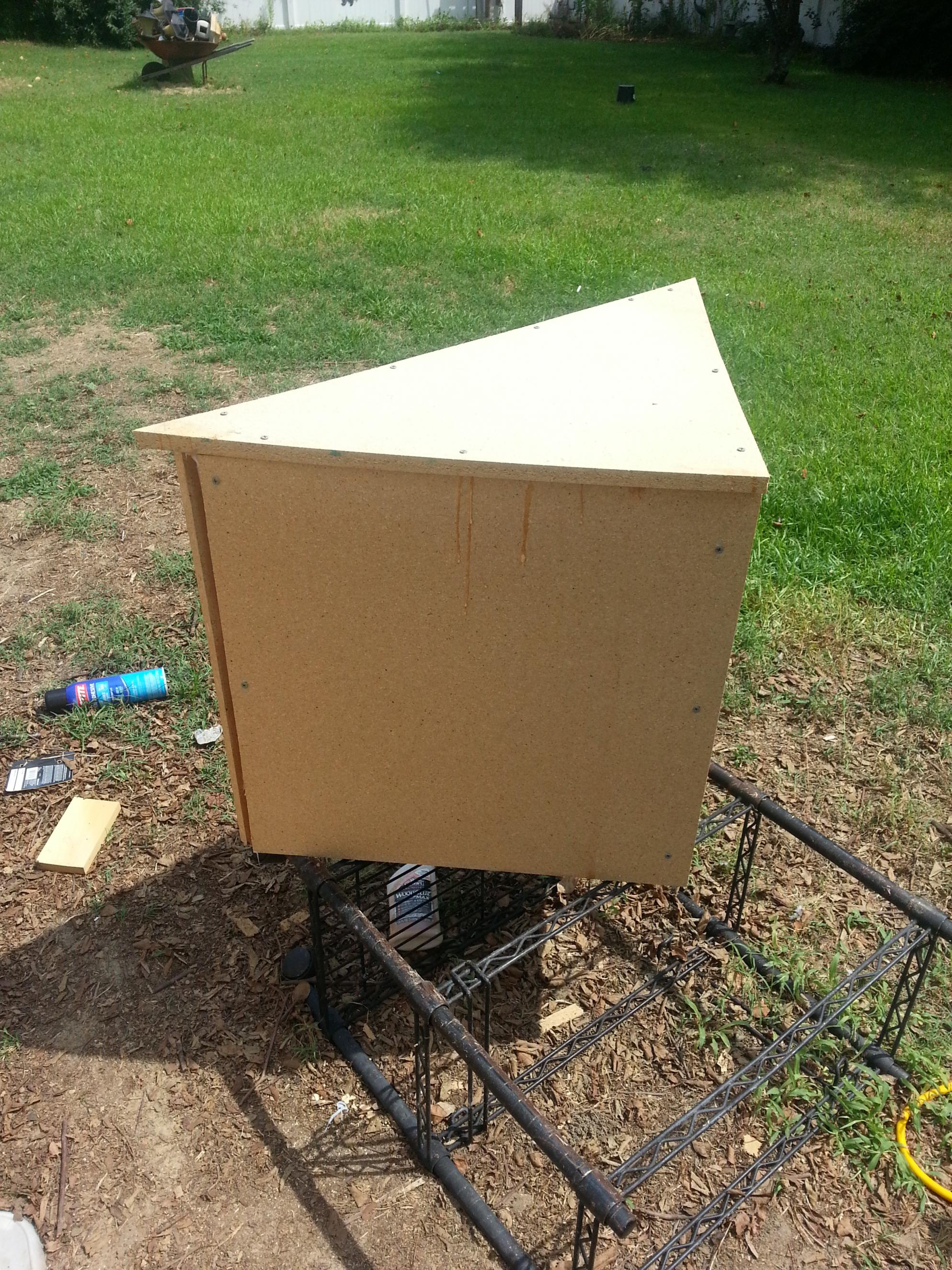

This is a shot of the shorter top box. It is roughly 25 inches in height. It will be placed in the "socket" created by the flange boards on the lower portion of the cabinet. I'd estimate it weighs roughly 50 to 60 pounds. I figure it will butt up against the boards in the previous photo. The PL adhesive should hold it in place AND provide some degree of seal for air leaks. I've already tried dry fitting it. And it seems to match up very well with the lower section. I figure two guys can lift it and drop it into the slot without much trouble.
I may be wrong in my thinking, but I've used exterior supports rather than interior supports. More Internal Volume was my goal. So the largest board will get external re-enforcement like you see in this photo. I'll do the same on the upper hypotenuse board. I'll also put quilt batting on the interior of the hypotenuse board of the upper section like I did on the lower section. I have some fiberglass batting. I was thinking of stapling some to the interior of the top.
My next task is to make the cut-out for the speaker. Once that hole is done, I need to put in a rounded over internal brace for the board right behind the speaker. I'll add boards around the eventual location of the speaker to protect the protruding rubber surround. It is right at 1 and half inches. Then I'll paint the whole thing with brown paint. After the paint dries, I'll do the wiring block and install the driver with bolts. Finally, nylon screen wire will be stretched and either stapled or otherwise attached to protect the speaker.
I think it will then be time to take it to the church. I'm guessing we're looking at something over 200 pounds when it is all put together. It seems sturdy. And I'm hopeful I'm sealing all the leaks with silicone caulk as I go. My concern is vibrations. But I figure I'll identify any in testing and try to eliminate any.
This cabinet looks like it will have an internal volume of just under 10 cubic feet. And it will fit well in the corner for which it was designed. Many thanks to Oliver for his plan. I'm cautiously optimistic that it will produce some low pedal sounds to go with the newly ported 13 cubic foot cabinet with the two 15 inch Dayton drivers. Keep your fingers crossed!!! 😕

Bracing inside or outside is better than no bracing at all.
You are looking to stiffen the panel and raise it's resonance higher up in frequency. And you have accomplished that for sure.
Your two part box idea is great. And the PL Premium will indeed seal the two together both air tight and otherwise as long as you have a good continuous bead of the evil stuff. Wear gloves unless you like wearing PL for a few days.
