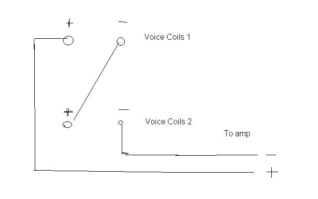

I'm about ready to do the wiring for this box. I'd like to confirm that I'm thinking correctly before closing up the box.
The speaker has two sets of 2 ohm voice coils. My goal is to connect the voice coils in a series - which should create a 4 ohm output from the amp.
Please confirm that this is the correct circuit. (Yes. I'm not all that great with MS Paint. But maybe you get the point.)
