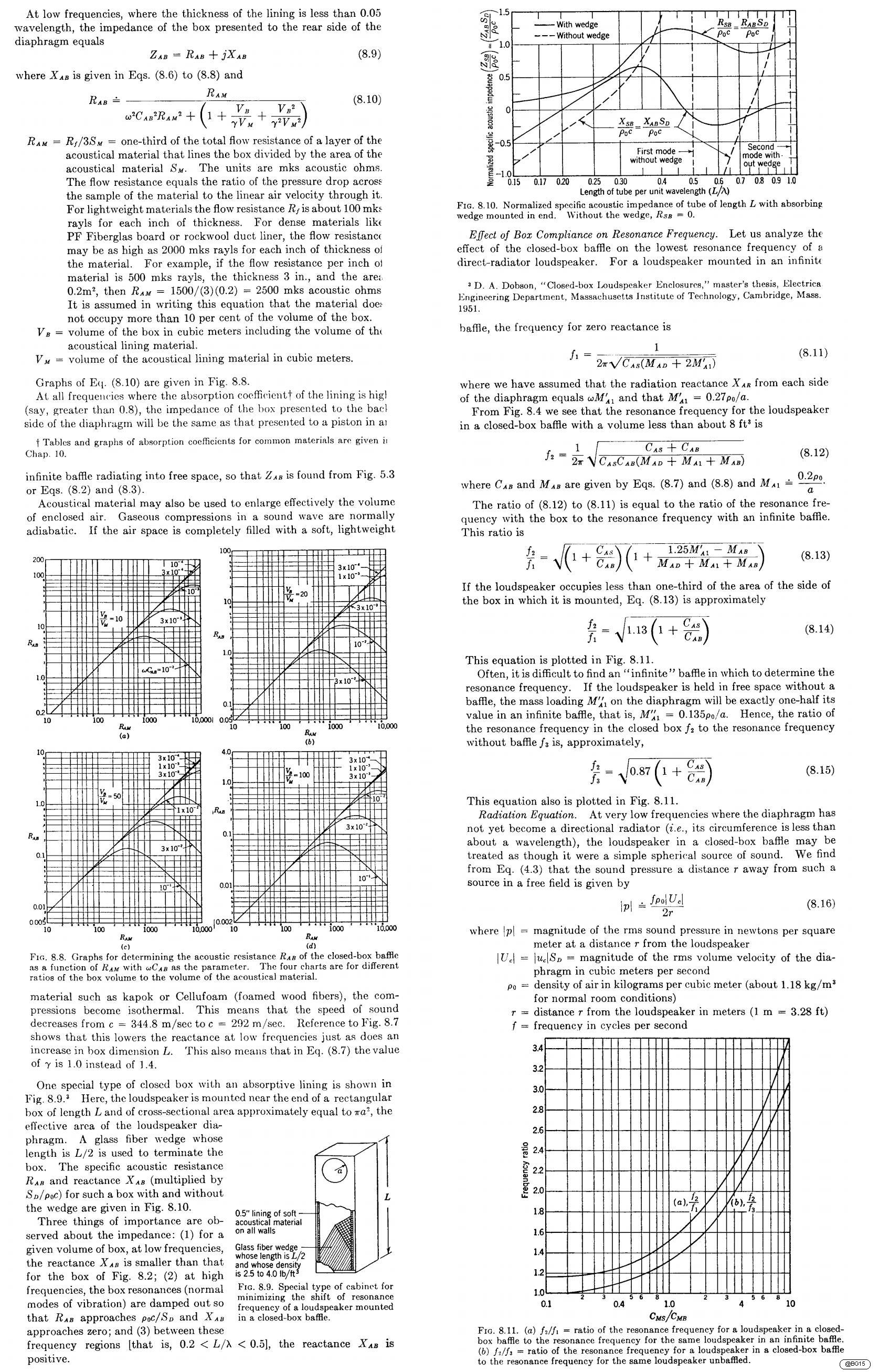

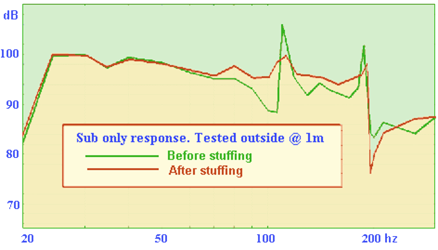

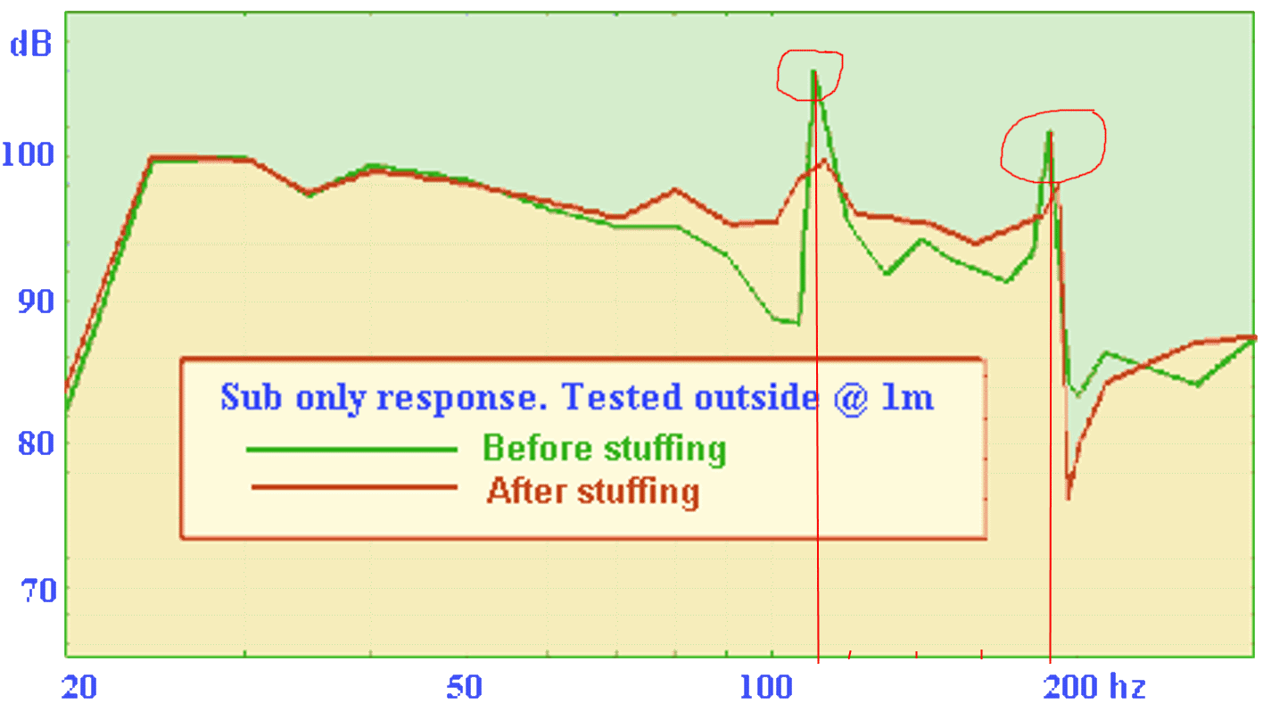

@bentoronto
I can't argue with measurements. They stand on their own merrit measuring the conditions at the time of the test.
What I can say is that a measurement graph in absense of the cabinet dimensions and measurement placement postitions etc is hard to discuss.
Just one variable such as the crossover slope being diffeent than the one I used can make a difference.
Another variable is the cone type and diamter. Number of braces and placement within the enclosure. Are they shelf type or full width and length braces? All these factors change the measurement outcome. Was their enclosure a cube? It is the worst scenario for resonances.
What I can say with confidence is that Rod Elliot knows his stuff, and that he is careful to post things he knows are true.

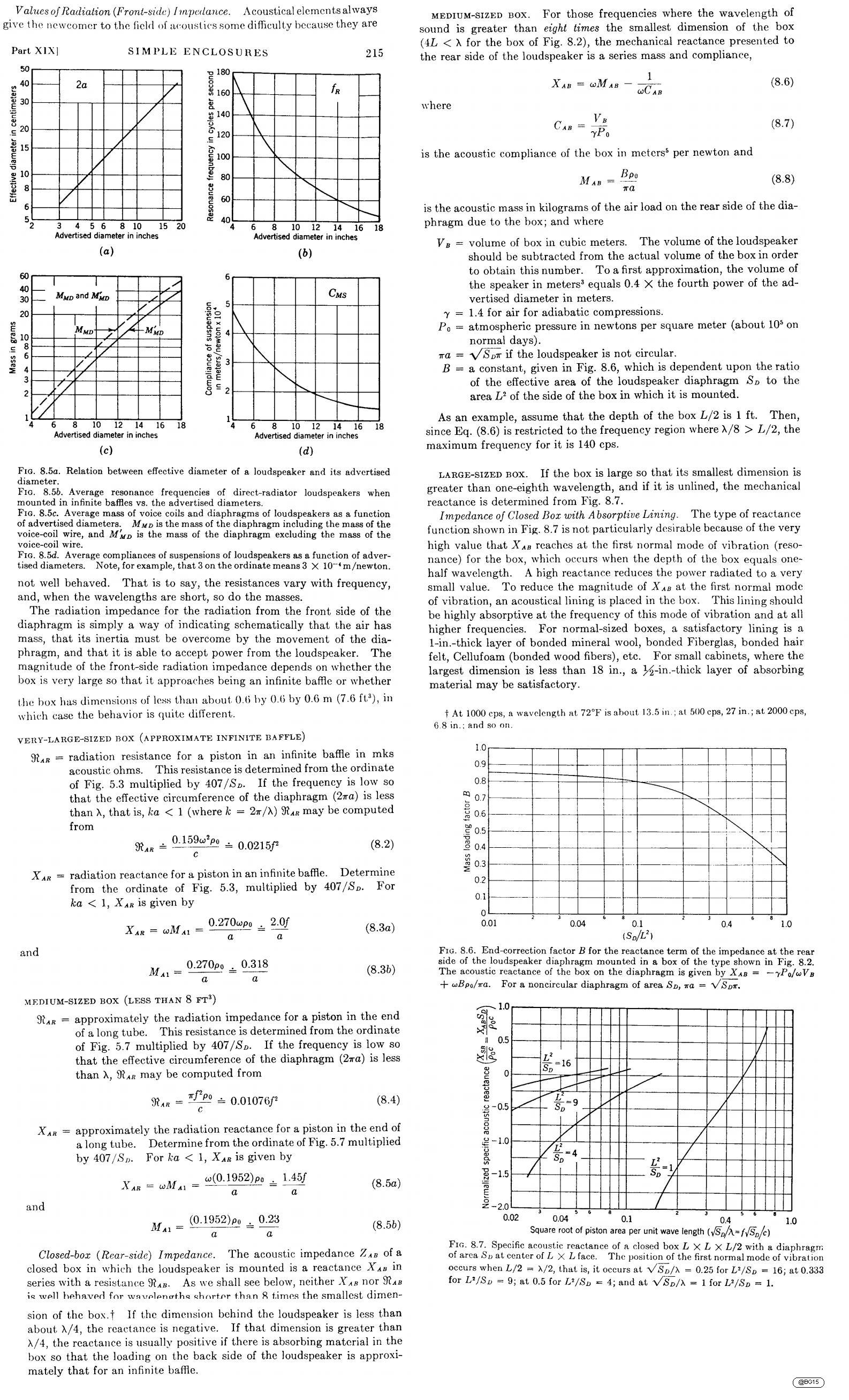

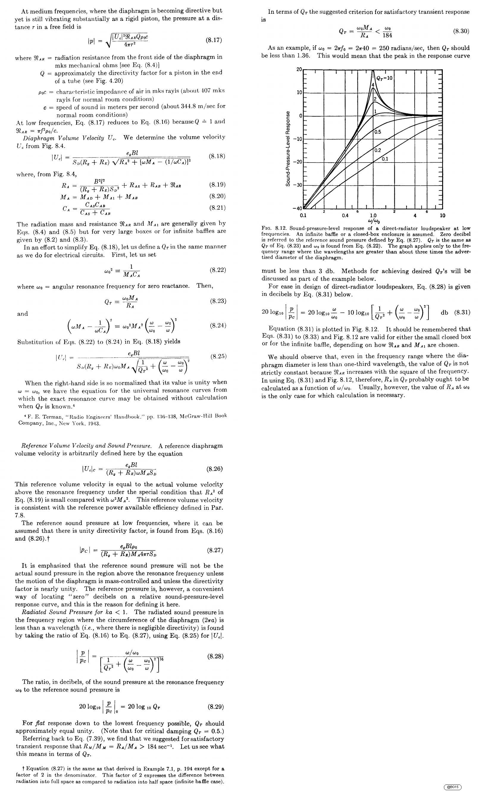

AFter I wrote that little paragraph I thought I owed you a look at the references. They are great examples of how to effect changes within an enclosure.
The graph comes from B. Collo's Website. What he is describing is not a passive absorber. It thickness and placement within the enclosure is a very intelligent use of movement within the damping panels. He uses thin foam on the side walls, and the just off center positioning of the damping panels is the key to his successful measurement difference. His enclosure illustration is below.
This is a very intelligent use of the natural resonance points within an enclosure and a method that will work. But it works because you are causing that fiberous tangle or insulation batting in this case to transfer the sound produced inside the enclosure to be converted into heat. The energy inside an enclosre is equal to that produced outside. As your other web reference aptly points out. Both references point to actual changes that have been effected. But it is not the wall lining that is accomplishing the effects. It is the correct placement of the slightly floppy panels. They act as resistive losses. Just as a resister turns a small amount of the electricity across it into heat in a voltage divider so a similar effect takes place interms of change of energy in one state or form into another through the fiberous panel.
I took the liberty of blowing up the graph a bit:
Here is a situation where the impedance plot could tell us quite a bit. If we had an impedance plot of the before and after application of the damping material you could see a few impedance peaks. They would line up pretty much with the peaks in the graphs:
The peaks are at approximately 110 hertz and 190 hertz. What is before the peaks are two valleys. These are usually caused by nulls. Basically reflections that meet but one is coming and one is going. When they meet they pretty much disappear. When you can dampen these nulls you will get a little better overall system response. This null in certain frequency wavelengths is caused by the enclosure shape and dimensions. As they are pretty close in frequency you can do a little math and calculated the possible acoustic dimensions within the enclosure. I said that carefully because the calculations cannot perfectly tell you interior dimension. Here is a simple frequency to wavelength calculator:

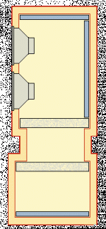

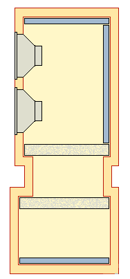

Placement or greatest effects is usually aliitle off center as shown in the diagram. A simple tacked in position with a long enough nail and a hard paper, carboard or cut out from a waste plastic container washer will hold it in place. You want it to be able to move. An you do not want to completely black off or divide your enclosure into sections.
The great thing about audio is that there are so many variables that change the outcome. That is why it is still in large part an art. Not in any way suggesting that it is less of a science. Parts of the art have been well quantified and understood.
Making application of the many possible decisions is the key part.dimensions that dominate the enclosure.

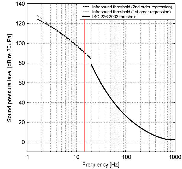

Just above the threshold for hearing out 50 feet way from the source. And that is worst case scenario.
You will have some boundary reinforcement inside. The wavelengths are indeed long. 16.8 hertz is around 64 feet long.
At the console this will be a reall treat.
The great thing about our hearing a way down low is that above the threshold of discernability any increase produces quite a large percieved increase. I'm thinking you will have a system to be very proud of.

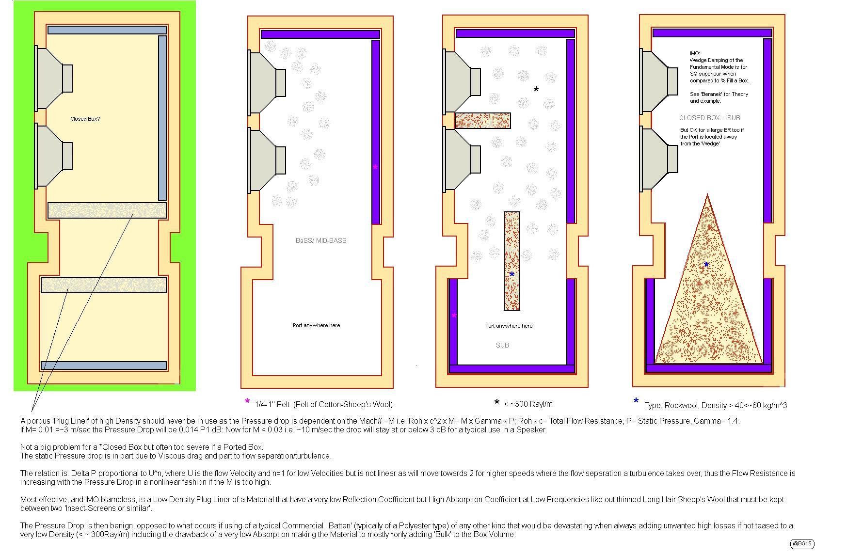

Damping the panels securely inside the box can make a positive difference to vibration reduction & leakage etc. Stuffing the box is NOT the same though, my any means !
Whatever size/shape box you decide on, to compliment whatever driver/s you install inside it, & tuned to whatever frequency you require, is one thing. When you stuff it with whatever, things change. The more you stuff, the more things change. Plus it depends on what you stuff with & how.
What changes are, the tuning gets lower than designed for, & lower the more you stuff. This naturally affects the frequency response & power limit. This is because the stuffing makes the box acoustically appear bigger than unstuffed. Unless this is factored in @ the design stage, what you expected to get you won't. The alternative is spending hours/days etc with stuffing trial & error methods, installing/removing/testing/listening until you're satisfied !
Plus, unless the stuffing is constrained, it will move in sympathy with air pressure, & also separately affect the tuning etc.
Better to take "note" now, than afterwards, but ulimately it's your gig !

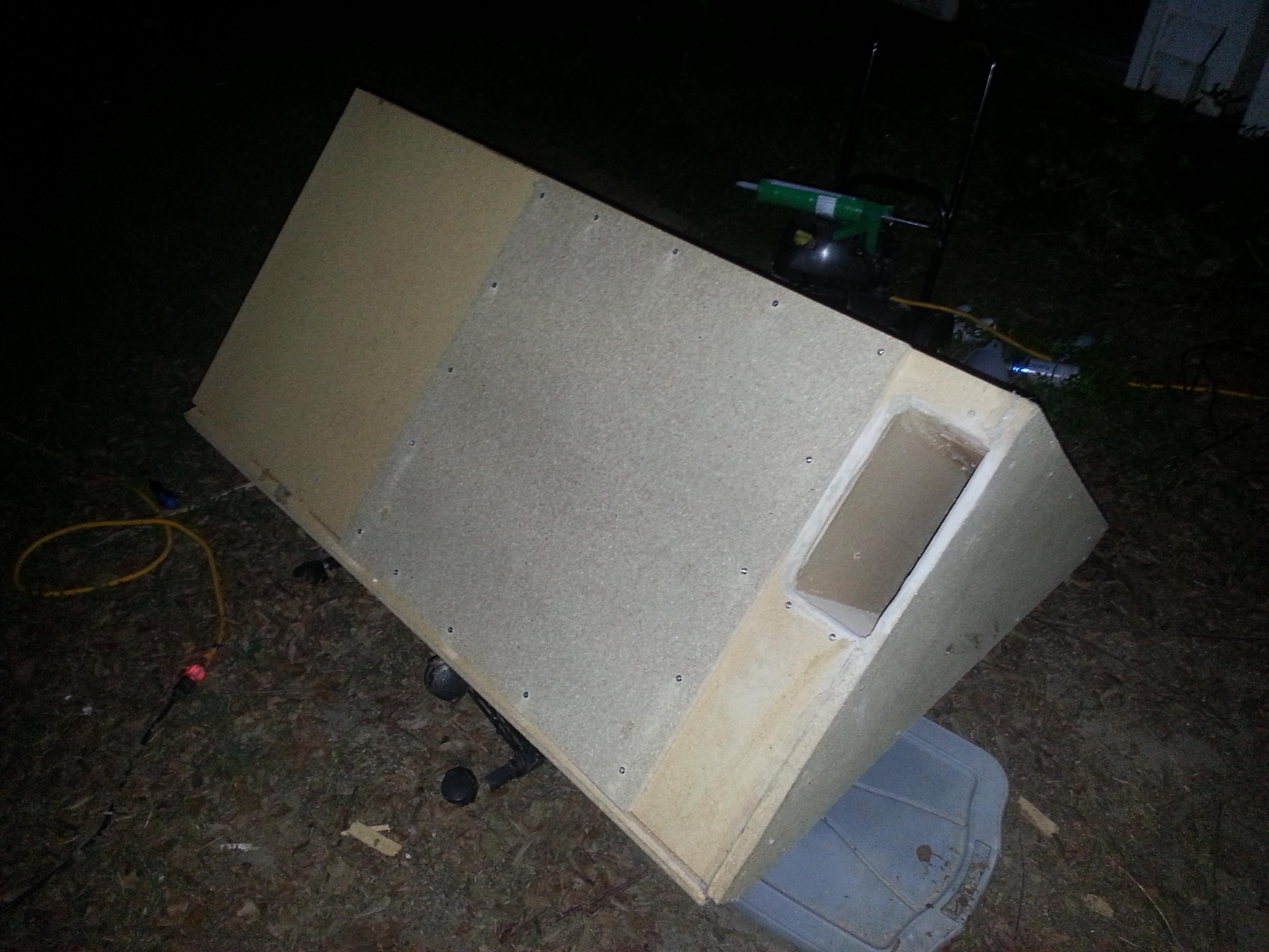

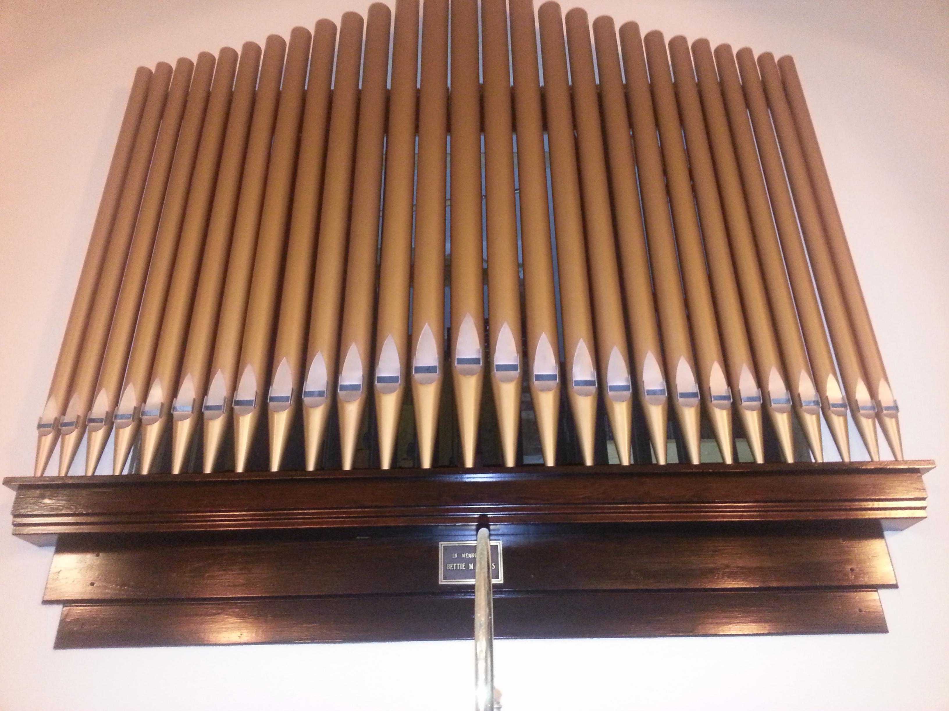

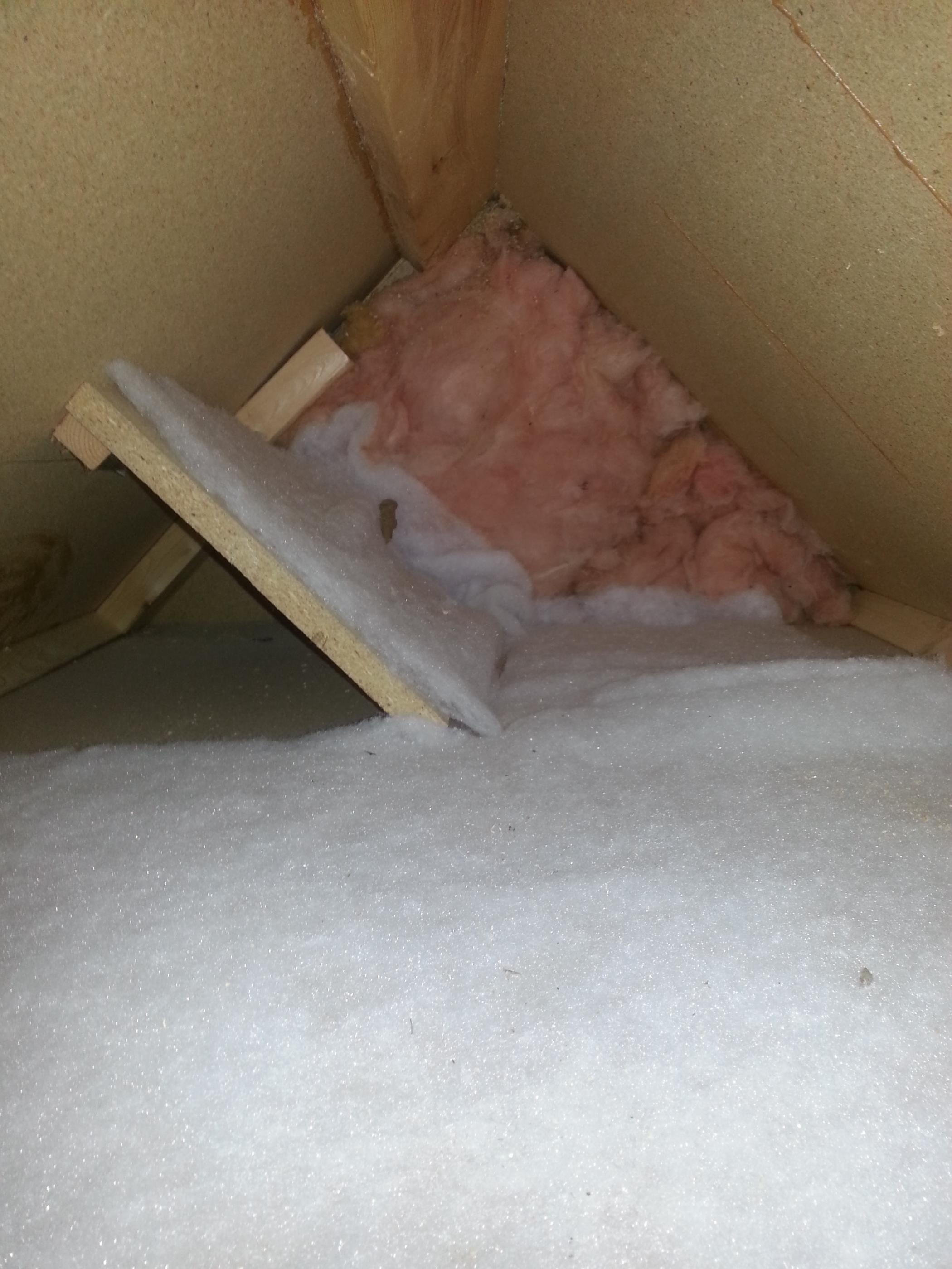

Here are some pictures.
The shades are located behind these non-working pipes. The shades were open and a light was on in the pipe chamber. You can just see some light coming between them.
Here's a shot of the small amount of damping material. Fiberglass was used in the area adjacent to the port. Then I used quilt batting for the area around the speaker and the upper portion of the hypotenuse board. It is held on using spray-on contact adhesive. It seems to be holding fine. The speaker will go in the board on the right. The motor comes down towards the panel on the lower left. The chimney of the port is right behind that panel. The motor extends 9.5 inches. The clearance is pretty close.
I added another board on the speaker face board. It gives a bit more rigidity AND brings the motor forward to reduce the chances it will come in contact with the angled hypotenuse board.
I did the best I could to round over the exit of the port.
Temps are predicted to be 100 today. So I'm going to forego any work on the box today.
I did add exterior supports for the hypotenuse wall last night. No pictures yet.
Bach On
Really nice job!
And holy Particle board Bat Man!
Going to be a heavy enclosure. I've moved around enough of that stuff in my lifetime. 72 lbs a sheet for 5/8". Around 84 for 3/4".
Hope you have eaten your wheaties when you move that box!
Stapling in a bag pf pillow stuffing (sometimes known as "a pillow") can't have an appreciable influence on the basic resonance but can help with noises higher up, as the previously posted chart shows.
Wrong again. It depends where you put it. A relatively small amount of stuffing can have a huge effect depending on what you do with it. Putting that pillow right in front of the port would really affect the fundamental to a large degree, and if you put that pillow INSIDE the port you could almost (if not completely) kill all resonance coming out of the box through the port. (There would still be sealed box resonance(s) affecting the driver output, but that's something else.)
If there were Gods of the Sim they would be angry that you didn't know any of this stuff when it's so quick and easy to learn by simulating. But really, with all your years of experience you should know this stuff anyway by experience and trial and error. It seems like too much time spent villifying these resonant boxes instead of trying to learn a bit about them has left you in the dark about how they work and what a properly designed example sounds like.

I know MDF is the preferred material. And that's what I used for the other cabinet - except for the top and bottom. But I wasn't sure how I was going to do those corners. So I opted for PLAN B. Lowe's had nothing thicker than 5/8 inch. So we have what we have. I tapped all over the two pieces I bought with a hammer listening for problems. But I think it is pretty dense - as am I.
And yes. It is heavy - though it will be in two parts. But the driver alone weighs 37 more pounds. So I'm calling out three or four of the muscle men. But we'll slide it up a ramp we create with an extension ladder. That worked well for the other boxes. I have a two-wheeled dolly to get it to the trailer when I move it to the church.
