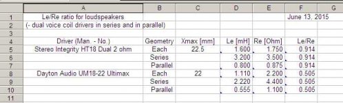

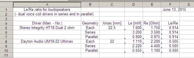

Brian, to address point 1, yes, comparing impedance curves is a great way to confirm accuracy. But as you mention in point 3 "if the measured impedance curve matches the sim, then the measured FR (done via short sine sweep with perfect measuring equipment under ideal circumstances, LOL) should be close enough to the sim'd FR as well."
This goes the other way too, if the simulated box dimensions are the same as the measured box dimensions and the FR curve overlays perfectly, the impedance curve is also going to overlay perfectly.
But as you mention in point 2, there are losses, losses inside the box, losses in the ground, losses in the air, so nothing is every going to overlay perfectly.

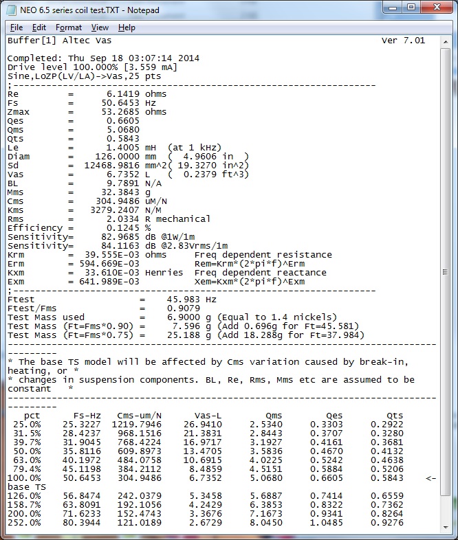

To start, let me admit right now my method is not perfect, it can't be, it's so incredibly simple it's actually a miracle that it works at all, and I apply EXACTLY the same tweak to every high inductance driver. But as you can see in the examples I showed it DOES work a lot better than just ignoring the high inductance completely. I'm nowhere near ready to present a doctorate level thesis on this topic, I just found a method that gets really good results and haven't bothered yet to refine the method. But as it is, it's already pretty good.
To go a bit more in depth, I have looked at impedance curves, but not at the level of scrutiny that you do. I'm mainly interested in getting the FR curve right, but as I mentioned, if the FR curve matches the impedance curve will match as well.
Also, as I mentioned, I didn't design or fold ANY of these example boxes that were measured, and it would take a LONG time to reverse engineer the fold to make sure the Hornresp inputs are accurate, something I am not prepared to do right now. At this point I'm happy with the results I'm getting despite putting in the absolute least amount of effort possible. I've been really busy the last few months and this is not high on the priority list, I don't even own a high inductance driver.
It's almost impossible to ignore the impedance curve anyway in this situation because I noted early on when adding Re to simulate power compression that the response humps up right at the impedance peaks. The same things happens with high inductance and it's easy to see. In the data-bass measurements look for the inductance hump and then check the impedance graph. The inductance hump correlates with the impedance peak in a sealed box and you get a rolled off response on both sides of the hump. In a ported box the inductance hump happens at the second (higher) impedance peak, and you also get the same rolled off response on either side of the hump. And same thing with tapped horn and front loaded horn (with slight difference for the multiple impedance peak enclosures).
Sealed boxes are forgiving of high inductance because it's easy enough to just eq the response back to flat so it really doesn't matter all that much. With ported and tapped horn you get a real mess, you don't get much output at tuning, you get a big hump at the second impedance peak, and a rolloff after the impedance peak. In horns (with multiple impedance peaks) the higher impedance peaks are enough to keep the response propped up so it doesn't roll off too much at higher frequencies, but you don't have that in ported boxes so the high frequency response just droops right down like it does in a sealed box. Front loaded horns are much more forgiving, you don't lose the output at tuning like you do with ported or tapped horns, you just get a spikier more overdamped response. This is all confirmed with many sims and measurement correlations.
Basically the high inductance presents as a weaker motor and you need a bigger box to prevent the overdamped response a weaker motor will give.

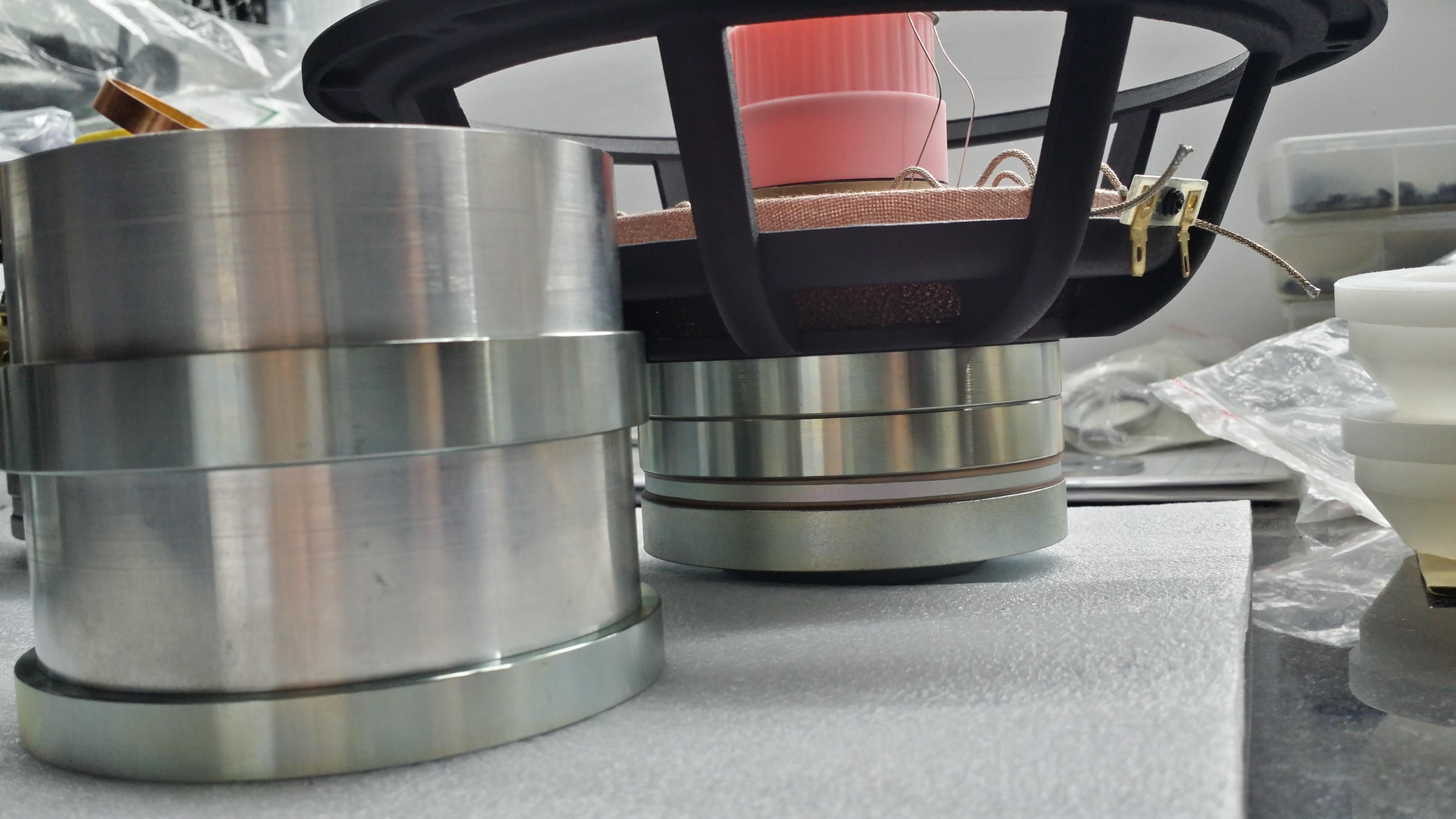

Now earlier when I mentioned that this is the first time I am aware of that anyone has attempted to simulate high inductance accurately that's not completely true. To explain, there are at least a couple of 3 point complex inductance methods, Leach authored one, and there's at least one more. But to use this method you have to either have the published 3 point inductance t/s parameters or measure them. (Re is one of the added parameters IIRC, so adding Re to simulate inductance can't be too far off the mark.) REW will measure complex inductance so it CAN be measured. But then you need a simulator that will accept these complex inductance parameters, and not many simulators will. Unibox will, but I've been told that it will NOT accept the t/s parameters that REW generates. And since nobody publishes complex inductance parameters you are kind of stuck.
My method works with simple t/s parameters than anyone can measure, the same t/s parameters that manufacturers publish. So anyone can do it with no extra info or complex measurements.
So there are options for simulating high inductance drivers.
1. Ignore it. This will NOT give accurate results, anyone can verify this in 5 minutes. Take a data-bass measurements of both a high and a low inductance driver. Sim the boxes with the box info and measured t/s parameters on the site. The low inductance driver sim WILL match the measurement. The high inductance driver sim WILL NOT match the measurements, not even vaguely close.
2. Use some other method to try to correct for high inductance. A very common approach is to add artificial Le to the sim. This will NOT produce accurate results.
3. Use the 3 point complex inductance t/s parameters. This probably WILL provide accurate results IF you are able to find or measure the complex inductance parameters AND if you are able to find a simulator that will accept them. It's especially hard to find a simulator that will accept complex inductance parameters AND have the ability to sim horns (or other more complex enclosures).
4. Use my method. This WILL provide accurate results. Not perfect obviously but a LOT closer than ignoring the high inductance or using an alternate method to try to fudge a closer correlation. The only better way is to use the complex 3 point inductance parameters, but good luck finding them (or measuring them) and find a simulator that will accept them.
I could say more but that's enough for now.

Hi Y'all,
So, JAG's analysis would mean that the Dayton would be the better driver for this box, as it has a much lower Le/Re ratio?
Le/Re ratio for loudspeakers:
(- dual voice coil drivers in series and in parallel)
Driver (Man. - No.) Geometry Xmax [mm] Le [mH] Re [Ohm] Le/Re
Stereo Integrity HT18 Dual 2 ohm Each 22.5 1.600 1.750 0.914
Series 3.200 3.500 0.914
Parallel 0.800 0.875 0.914
Dayton Audio UM18-22 Ultimax Each 22 1.110 2.200 0.505
Series 2.220 4.400 0.505
Parallel 0.555 1.100 0.505

Hi Y'all,
The Dayton is a better driver in general, there's measurements of both drivers at data-bass. But it's also more expensive IIRC. And I haven't simulated it in ported boxes but it doesn't look good at all in tapped horns.
