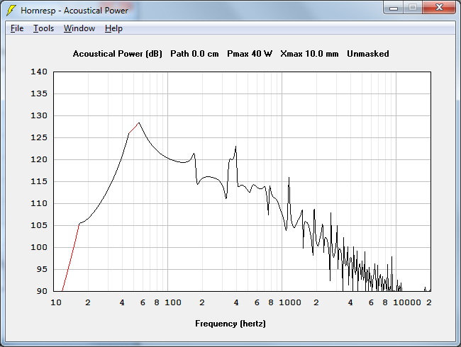

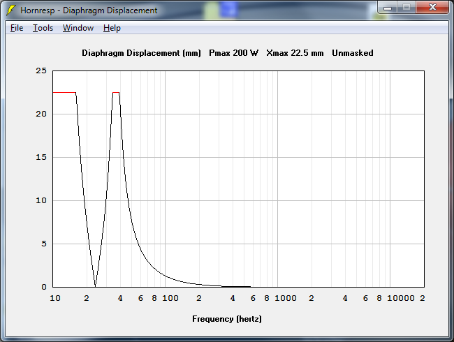

Hi Bach On,
Looking at a simulation of the UM 18-22 in the corner box @ 1kW (the rated Prms) the driver is still below Xmax (~ 18mm @ 26Hz). With both coils in series you are looking @ Re=4.36 Ohm, so the Crown XLS1500 would have to be used in bridged mode, Pmax=1.55kW into 4 Ohm. That should work very well, and leave you some power reserves.

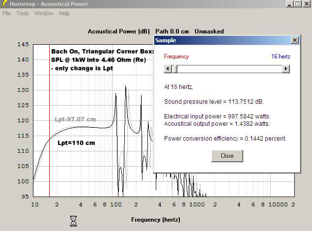

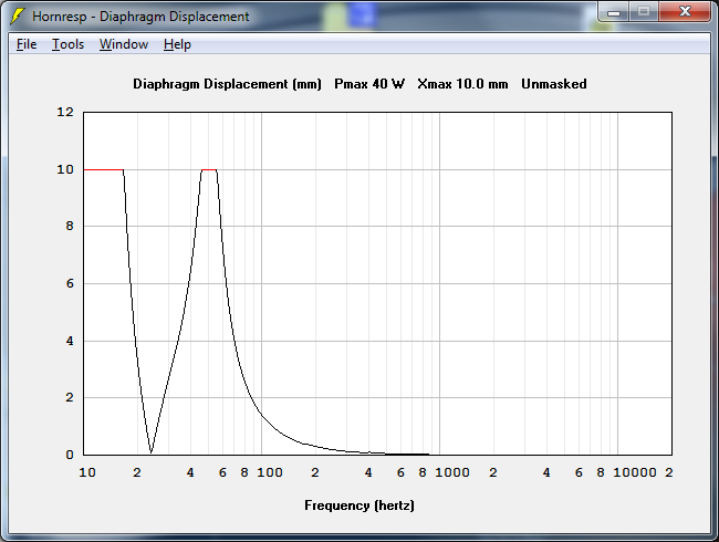

Hi Bach On,
The length (height) of that board determines the length of the port. The longer the port, the lower the tuning frequency (all else being equal). I'll attach a simulation showing the old length (97.07cm) and a new length (110cm), there is very little difference, the shorter length looks like it would be preferrable (see attachement).
The cross-sectional area of the port in that location (the back corner) is the triangular area that one is looking down at; this then turns into the rectangular port that comes out the front.

So, longer port = lower tuning. But what are the trade-offs for that?
And I've got to assume that there is a limit for what (good and bad) a longer port can do.
Yes. I know I'm consulting with the creator of the prototype. So I don't want to screw it up I'll try to make you proud. I do have one question about the rectangular port area. It's rather difficult to tell from the excellent drawing you posted. The triangular upright bends and connects to the bottom rectangular area. The opening at the front is 9.25 inches wide x 4.25 inches high. But the front face is 24 inches wide. So there is an area running parallel to the floor that is NOT part of the port. It is roughly half the width of the driver. It is separated from the port by an upright under the middle of the driver (ending at the hypotenuse wall). I'm guessing that the area should be open into the area directly right behind the speaker? It's hard to describe, but I can sketch it out if it would help..
One of these days I plan to actually learn to do these sims myself. I've just got a lot or irons heating right now. Thanks to all of you for your kind assistance.

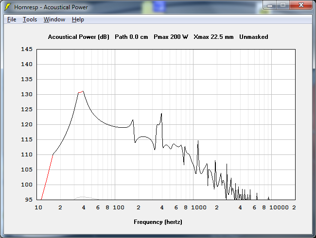

Hi Bach On,
Post #632: "...The triangular upright bends and connects to the bottom rectangular area. The opening at the front is 9.25 inches wide x 4.25 inches high. But the front face is 24 inches wide. So there is an area running parallel to the floor that is NOT part of the port. It is roughly half the width of the driver. It is separated from the port by an upright under the middle of the driver (ending at the hypotenuse wall). I'm guessing that the area should be open into the area directly right behind the speaker?..."
Correct. We need every little bit of volume we can get. The port consists of two sections, the vertical triangular section, and the horizontal rectangular section exiting at the bottom right below the driver. Looking back at the drawing from May 13th, Post #565: on the right hand side are a number of cross-sectional areas that I used to calculate the internal volume(s), the one that says: S_bot=64.304in^2... that is the area for that bottom section of the box. The next one up in the drawing is the area above the top board of the bottom rectangular section of the port located behind the driver, and the one on the top is for the upper box section above the port.
Use the brace @ the inlet of the port inside the box, and round over all inlet and exit edges. I matters.
Don't worry about the length of the port too much, as the Hornresp screen plot from Post #631 shows, even an increase of ~5" port length will not derail the system. This may be a terrible thing to say as some builders seem to fret about minute differences in length, but in this particular case it is really not a big deal (now, don't take that to mean you can just leave out the whole triangular section, or something like that 🙂.)

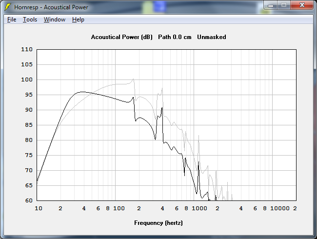

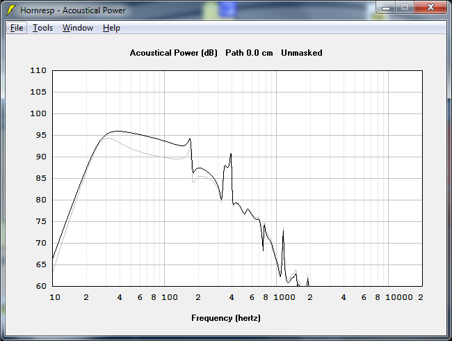

A quick check of the impact the inductance might make is to double Le, and compare the SPL curves. The UM 18-22 does have a rated Le of 3.09, going to 6.09 looks OK (some, but very little change).
That does not work at all to simulate the effects of high inductance. Adding more artificial inductance to the sim will not give an accurate result. I'll send you a PM later when I get some time.
I've run at least a couple dozen sims to verify my inductance correction method, all compared to high quality measurements, mostly done by Josh Ricci and most (but not all of them) are measurements on the data-bass site. So I've got a pile of sims of high inductance drivers in sealed boxes, one or two in ported boxes, a couple of tapped horn examples and a front loaded horn. My inductance correction method works very well to correlate sims to measurements regardless of enclosure type. Doubling Le in the sim won't even get in you in the right ballpark.

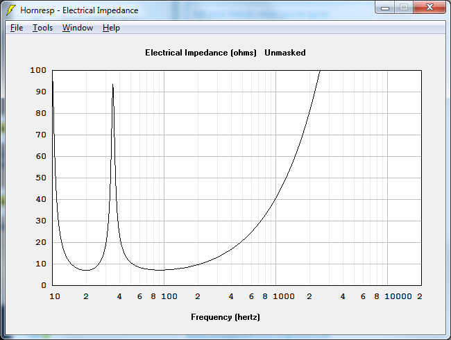

Add in the situation of where this subwoofer will be operating the impedance of the drivers is considerably higher than the nominal rating in the first place.
At different pitches the impedance seen by the amplifier varies quite a bit.
16 hertz 8.54 ohms
32 hertz 32.1 ohms
64 hertz 8 ohms
