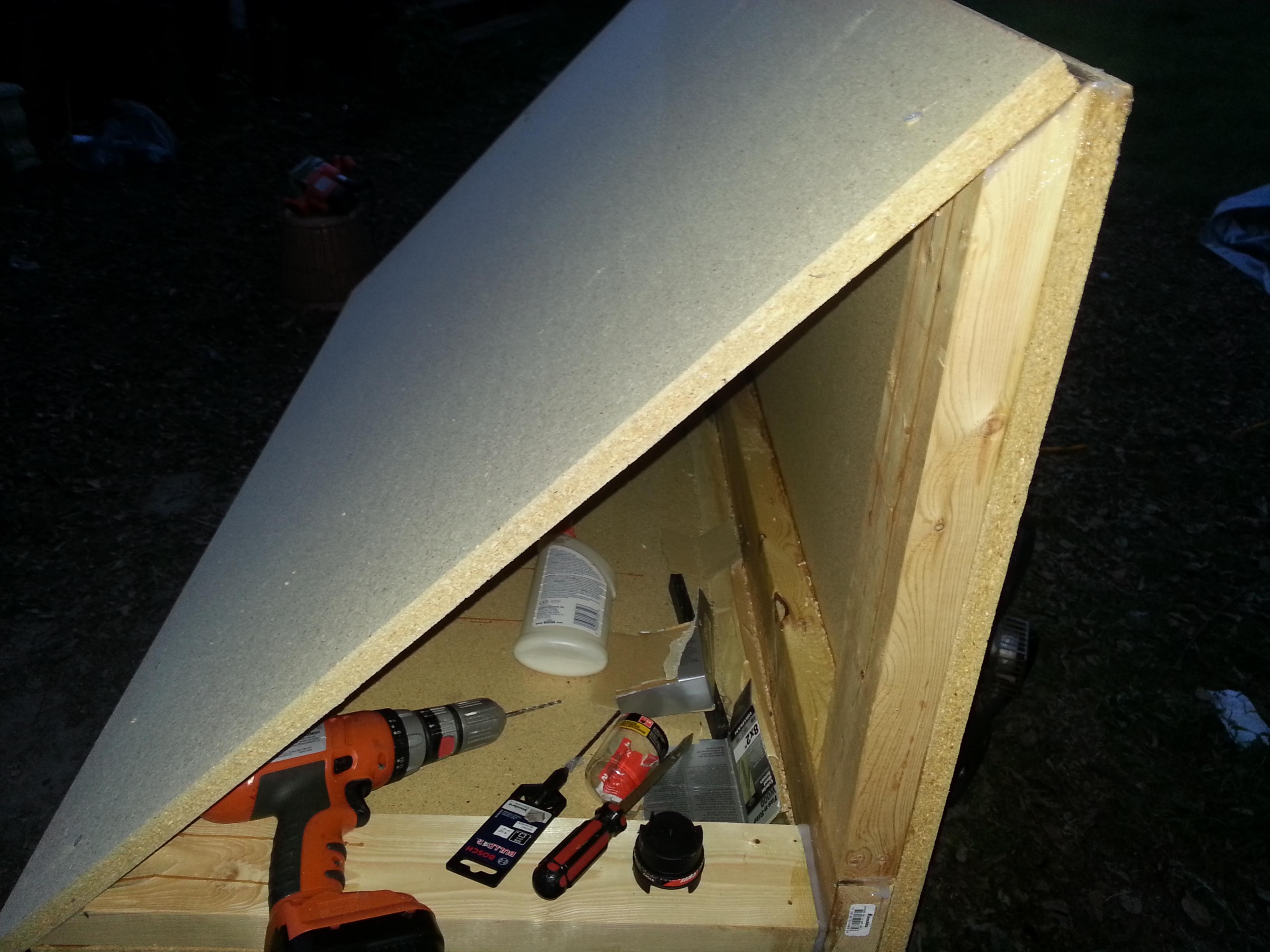

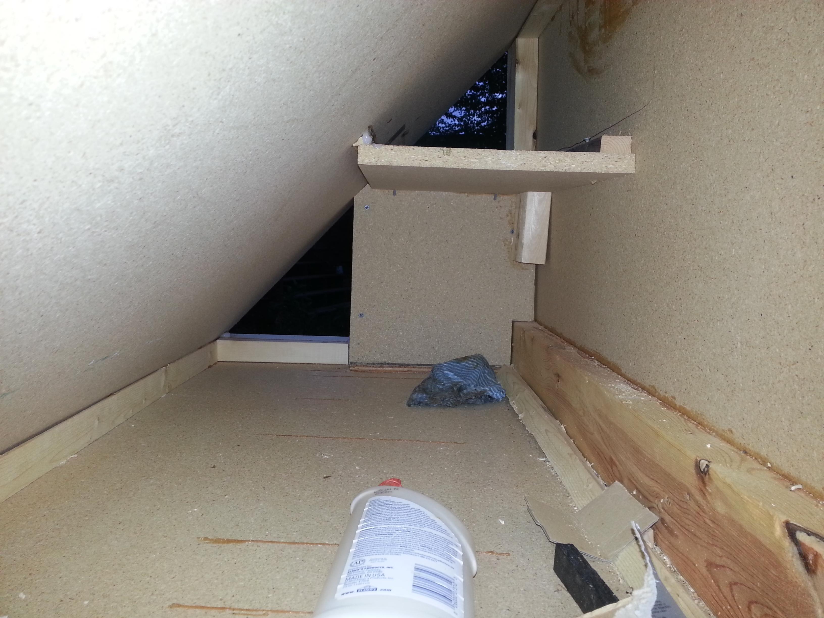

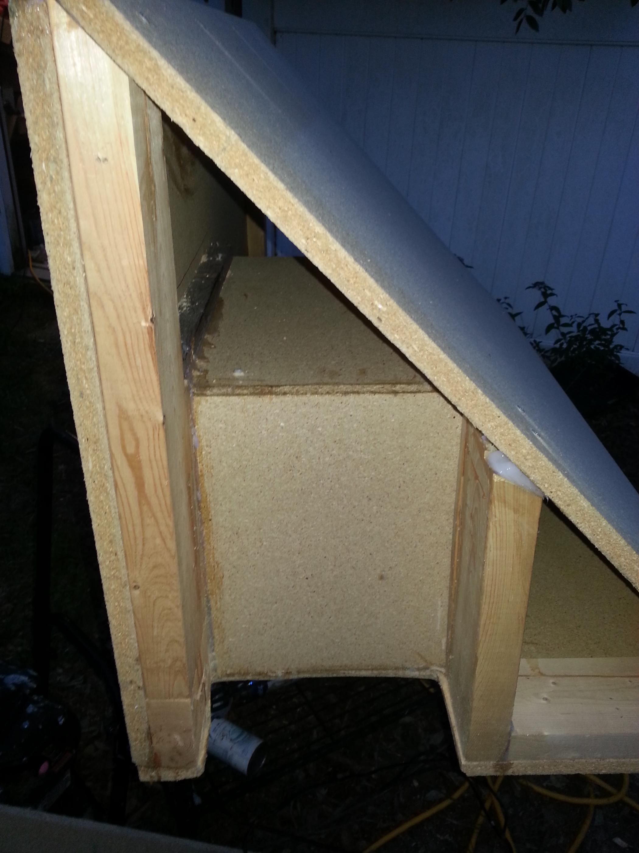

A little show and tell on the triangular bass cabinet:
I'll post some pics of the interior with the stuffing PDQ. Gotta go play at church.

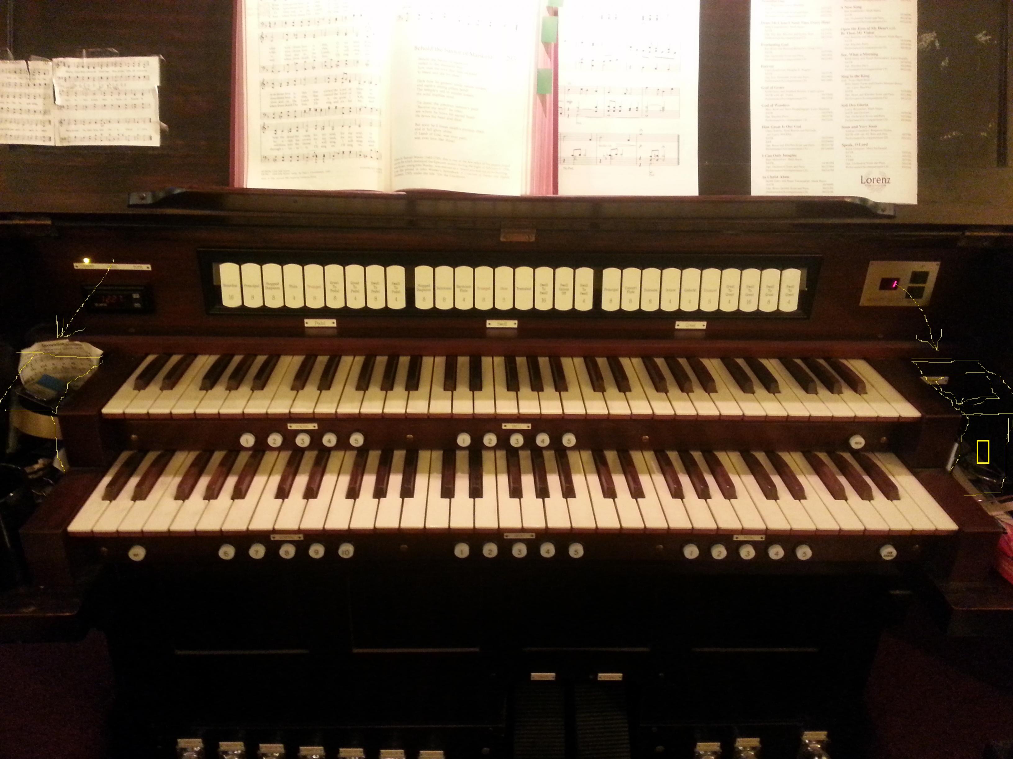

BTW - here's a picture of the organ console:
The things above the keyboards are the tabs. This is the part that is being fabricated right now. There will be more tabs, so the items on the left and right have to be moved. The yellow lines are indicating where the relocation will be made. This is a whole lot of the cost of this project.

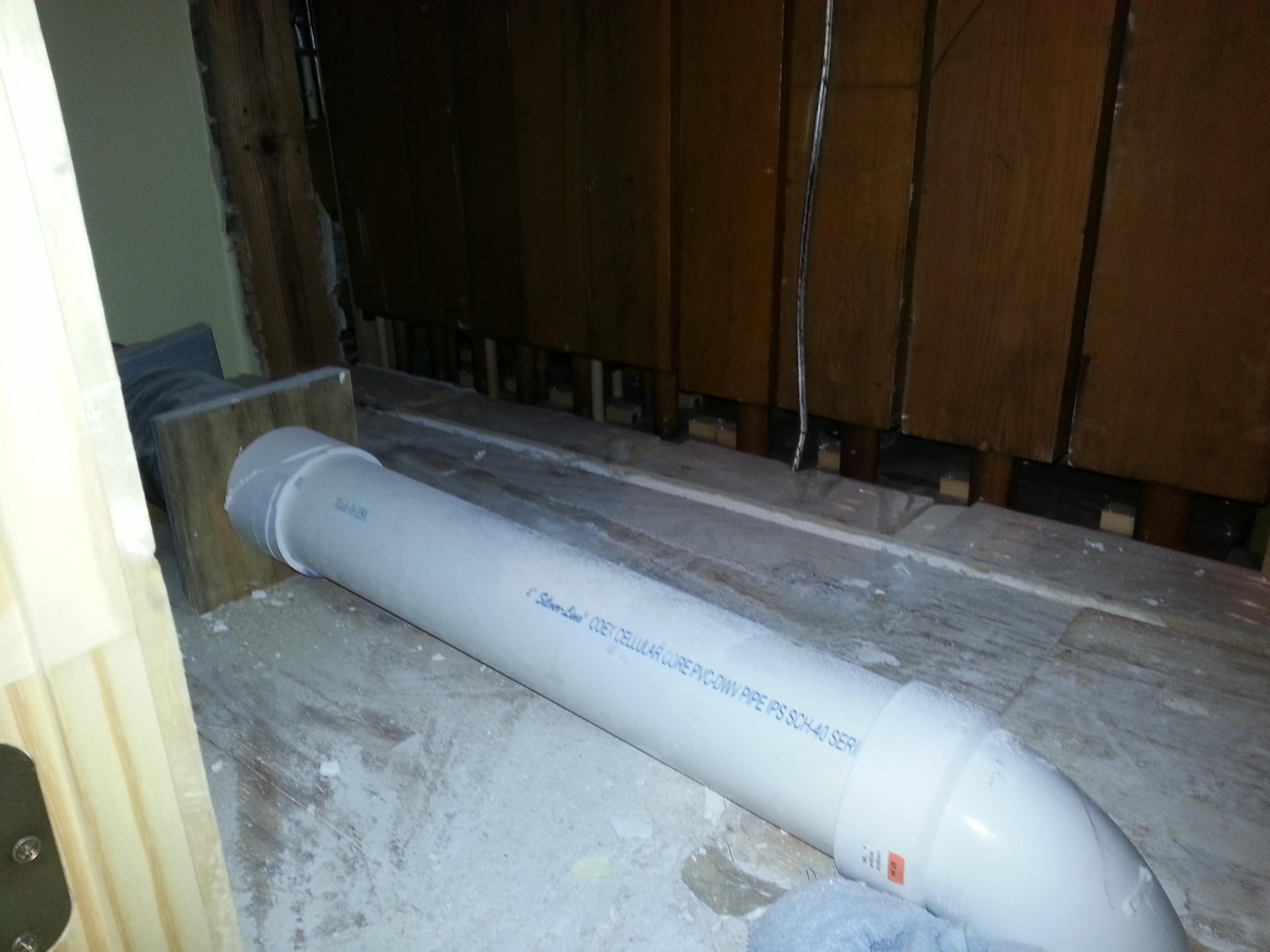

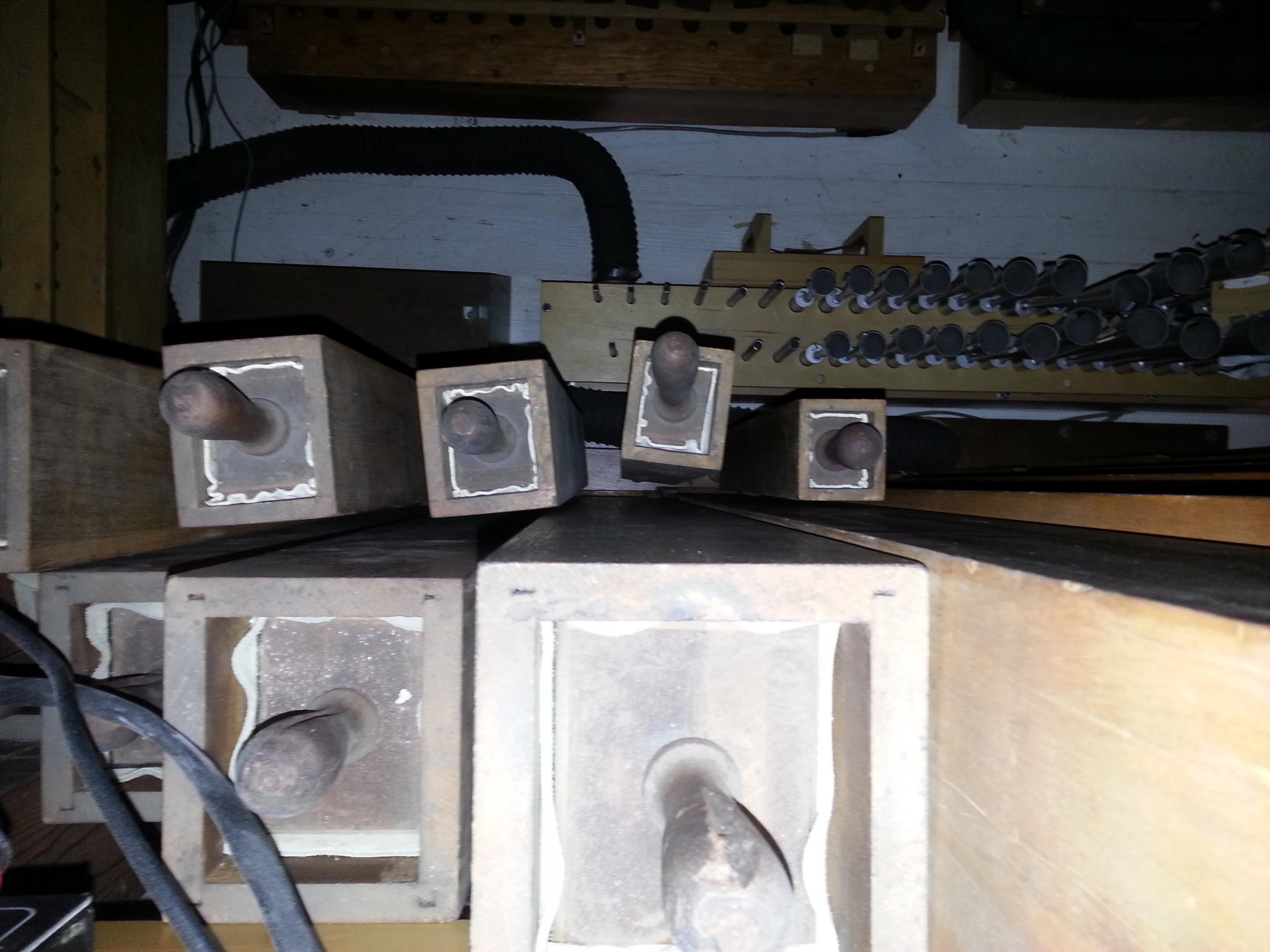

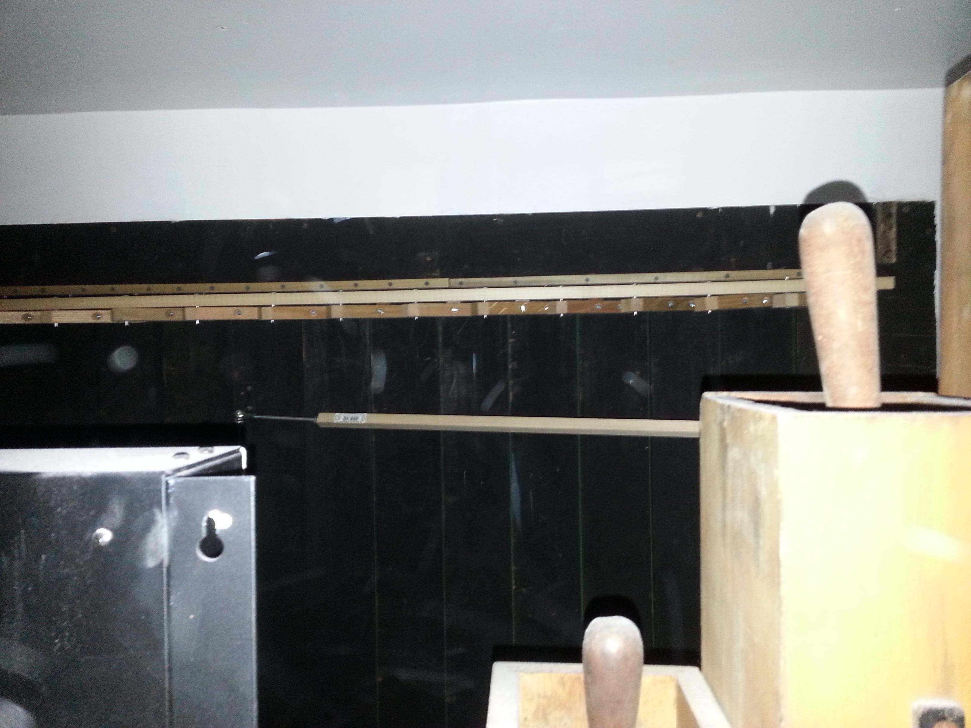

I've mentioned the wood pipes that are plugging up the opening from the speaker chamber into the pipe chamber.
Here's the doorway into the speaker chamber from the nursery.
This shows the floor right behind the wood pipes. (This photo was before we put any of the speakers in the chamber) The PVC pipe comes from the blower and goes into the windchest that maintains the air pressure. I've built an area with concrete blocks and 2x4s to get the speakers over this pipe. You can see the large wood Bourdon pipes on the right. Notice how close they are to one another. This is the opening into the pipe chamber. These pipes will be removed and taken away when the sound engine is installed.
I stuck my camera out an opening above the Bourdon pipes. I pointed it down at the floor of the pipe chamber. You can see that there are more pipes in front of these.
Here's a shot of the shades in the pipe chamber. The shades will control the volume that passes into the Sanctuary.

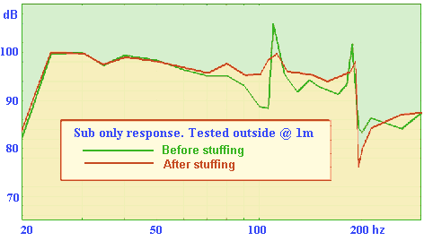

Respectfully, Mark's opinion differs from that of two other authorities, Rod Elliot ("ESP") and Bill Collison
Damping Treatments
The attached chart is from Collison showing greatly improved response with damping.
Without a whole lot of probably unfeasible stuffing, there is no realistic way to mangle the basic Helmholtz frequency. Too bad. So doing much about the main boom down there is not in play. So no quibbling with Mark about the absence of much audible or measurable influence on the basic box note.
The question then is the audibility of resonances in (1) a tall box, (2) considering that drivers play distortion harmonics that are vastly more audible than their fundamentals, and (3) we're only guessing what frequencies will be pumped into the new box (again, with upper notes creeping in from a low-slope crossover or an undocumented organ synthesizer being a lot more audible).
In light of that, I'd suppose the improvement shown in the graphic is quite applicable here.

It can't be sorted by stuffing in subs.
Do you have any non-averaged spectrums of the sound to post? Other data? Or are you basing your opinion on listening experience?
1 - Richard Small "Loudspeakers in vented boxes" is where i discovered that stuffing affects the T/S parameters & therefore response. Any extra moving mass is the culprit.
2 - I was going to show TL stuffing responses, but your Collo link is fine.
mwmkravchenko is in agreement with me. Also Collo's link states & shows similar.
Full-range speakers have acoustic wool stuffed into the box to remove energy due to friction as the air moves through the fibres. The effectiveness of this approach diminishes as frequency is reduced. By the time we get below 300hz, the stuffing is basically useless.
For subwoofers, stuffing will not help with the fundamental resonances, however it is still useful for treating harmonics, which may be exicted by distortion from over-driving, or by shallow rolloff slopes in your bass management system.
Damping Treatments
With designs for sub duty, ie less than 100Hz, & this is for 16Hz, stuffing will only make things worse !
Ben
No it's not. The graphic shows a HUGE resonance (15 db variation in the dip and peak) at a VERY low frequency (100 hz). A good bit of stuffing (like a LOT) in the right part of the box absolutely will help that, as the picture shows.
BUT in the sims I did, OP's box has a VERY benign resonance MUCH higher in frequency. IIRC it was maybe 2 or 3 db and up over 200 hz. I don't remember exactly and he didn't build from my sim anyway, he used tb46's. A resonance that small will be virtually inaudible, and if for some reason it is audible it probably won't be unpleasant. But if for some reason the OP doesn't like it, a small bit of stuffing would wipe it right out. Just keep the stuffing as far away from the port as possible (the complete opposite end of the box) and don't use more than necessary, it won't take much.
I do tl (and mltl) design too, these low frequency resonances are always present in those. They are easy to get rid of if you design them to be small in the first place and put the right amount of stuffing in the right part of the box. Easy stuff.
