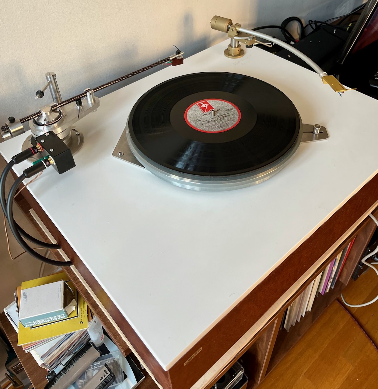

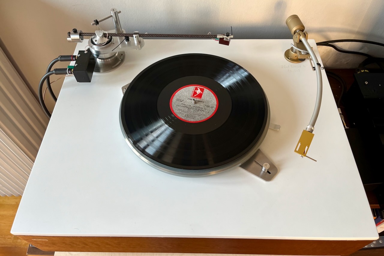

I have also used Corian as the top plate of my Lenco L78 restoration. The bottom part is birch ply. Corian is a great material, easy to machine with very nice acoustic properties.
I have a Mylar tape roll, so I do not have to buy ready-made belts. I can prepare Mylar belts of the appropriate length. The same with polyester thread belts.
Panos

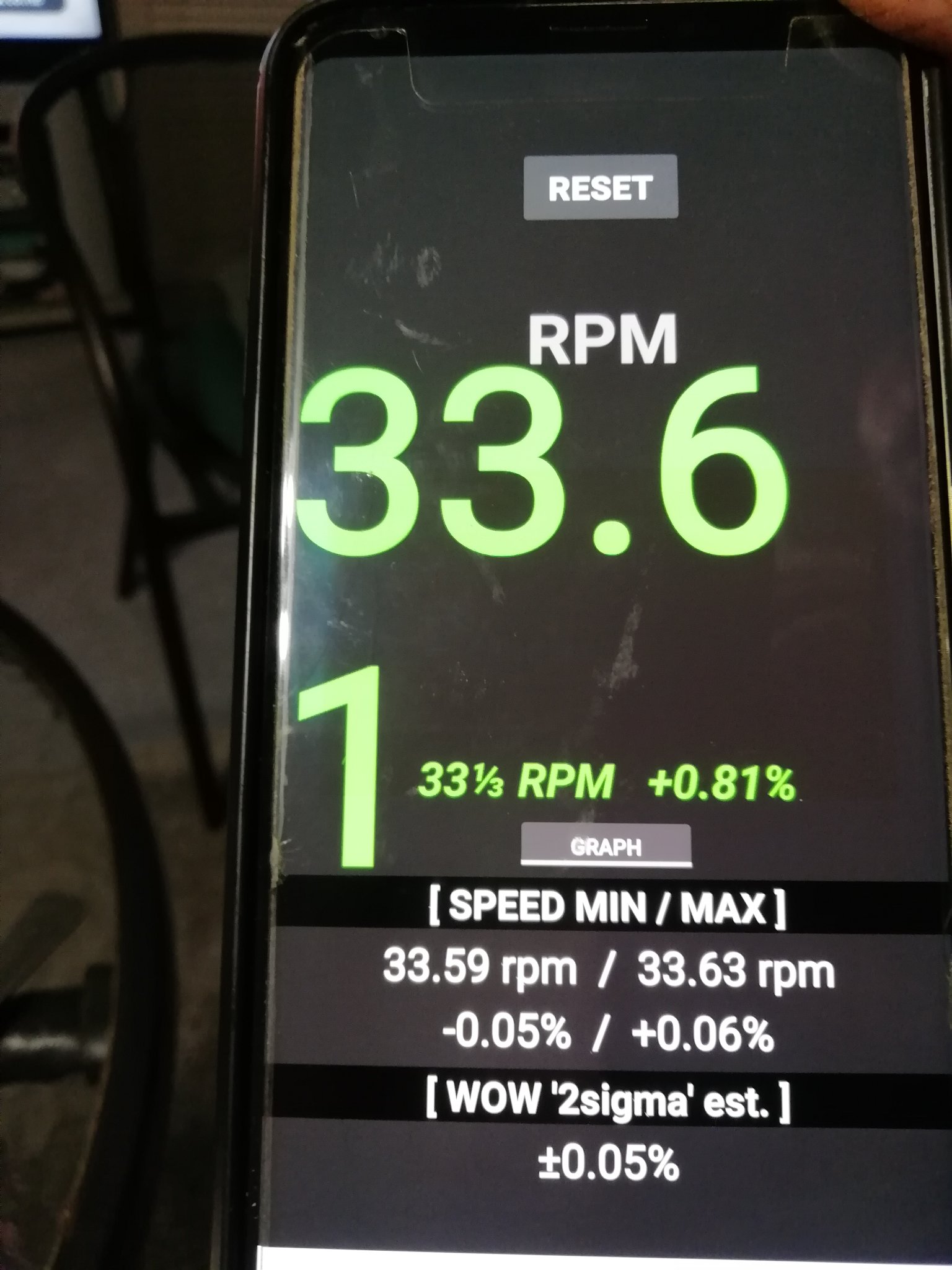

Hi, Just though I would share my 12 VDC motor & controller results, to show you what can be achieved. Running a Mylar bely around the platter perimeter.
Donor deck was a Lenco 78 & these results are better than when that desk was new. Slight overspeed is to allow for stylus load slow down when running.
Cheers

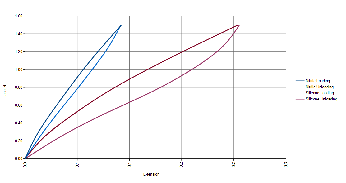

My experiments with drive belts is continuing slowly.
Unfortunately I'm going to have to give up on silicone as an option. The only product that I've found that can bond the ends satisfactorily seems to only be available in the US. The cheapest I've found it with shipping to the UK is about $80. For an experiment this is a bit steep.
I have taken another set very accurate measurements of all the dimensions of my deck and set up a little spreadsheet to calculate the required belt lengths to completely balance the side forces acting on the main bearing. Luckily it turns out that the belt lengths I have been using were pretty much spot on. This spreadsheet will be very useful when I get to trying different belt materials.
I've also set up a test gig to measure the stretch of different materials under varying loads. Previously I had only measured the stretch at the target belt tension. I've now measured from 0 to 1.5N both when loading and unloading the belt. Being polymers the belts will stretch and relax at different rates. When plotted on a graph the loading and unloading cycle forms a loop that shows the hysteresis of the belt. Hysteresis is very similar to damping.
This is a quick comparison I made between 1.5mm nitrile rubber and 1.5mm silicone. The Silicone is much stretchier (more compliant) as shown by the shallower slope. It also has greater hysteresis as shown by the width of the loop. Unfortunately I am unable to determine how this relates to sound quality at the moment.
I have ordered some additional belt materials to further this investigation. I have some monofilament polyester thread on order, thanks for the heads up Panos. Unfortunately my deck isn't suitable for mylar tape. 😢. I'll keep looking for an affordable way to bond silicone but my hopes are not high.
Niffy

My analysis of the difference between the hysteresis of the two belts was incorrect.
To compare I should stretch the belts to the same extension not the same load and the degree of damping is the area between the lines. If I had done so the area of the loop for the silicone would actually be slightly smaller than for the nitrile showing that the nitrile is actually better damped.
I did also measure some 2mm diameter silicone. This had almost exactly the same compliance as the 1.5mm nitrile but the hysteresis was only about half.
Niffy
