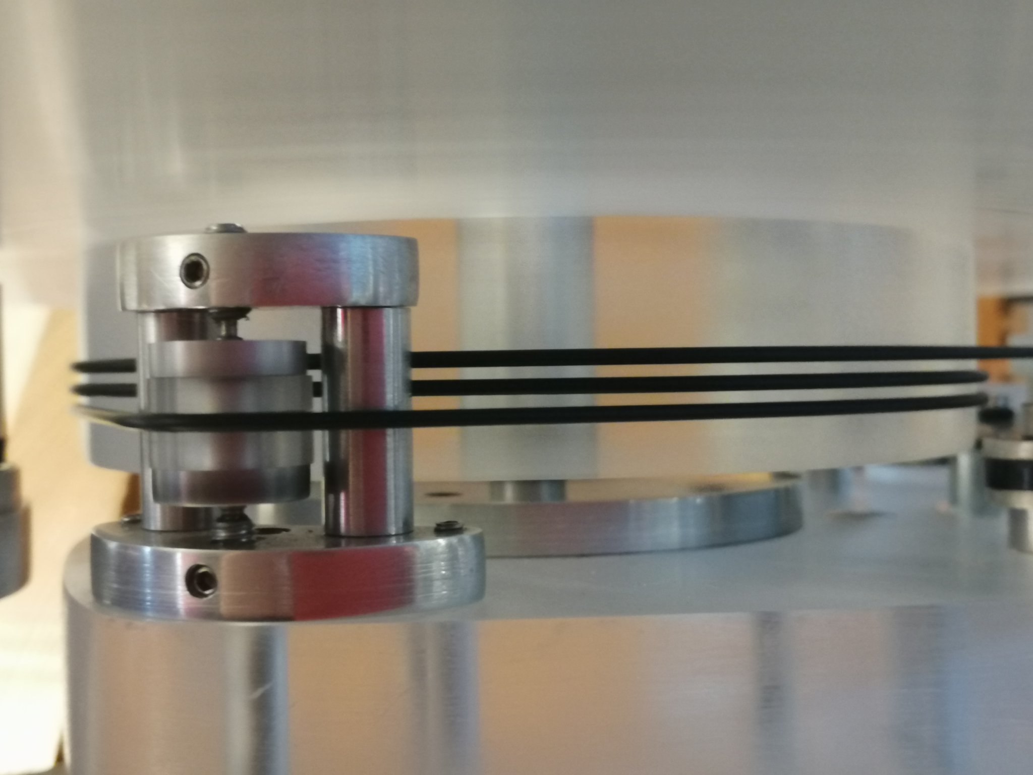

Round belts.
I have the rather unusual bearing and drive configuration with two idler wheels in addition to the motor pulley. I use a separate belt around each idler and the motor pulley.
This is with the 1.5mm nitrile belts, which are still my favourite so far. Hopefully I'll get to testing a couple more belt materials in the next couple of days.
Niffy
Niffy
I've made 4 more sets of belts today and given each a quick test.
The first up was some 1.5mm Viton. This was very disappointing as it didn't work at all. Even though I made the belts to have exactly the same tension as the other materials these suffered from massive slipping. The platter barely moved even though the pulley was spinning at full speed. Extra disappointing as this was by far the most expensive material I've purchased and I had had high hopes for it.
The next material tested was a bit of a long shot that I didn't expect to work at all. It is 2mm foamed neoprene. I've not seen foamed rubber being used for drive belts before. I thought that the foamed structure might have benefits for improving damping. The measured hysteresis was about average for the test group. The compliance was very high, similar to the 1mm nitrile.
This belt material performed pretty well with a score of 25.
It had a smooth and relaxed sound.
Image focus is a little vague but had good depth.
Nice mid-tone but lacked solidity.
The bass was quite soft and dynamics were muted.
The whole was better than the sum of the parts, I quite enjoyed the sound of these belts.
Next up was some 1.6mm EPDM.
This sounded very similar to the 1.5mm nitrile with a score of 29.
In comparison it was a little lacking in bass detail and transients very slightly softened. On the plus side it had a slightly warmer, richer mid-tone.
This material feels very similar to the Origin Live belt, I wonder if this is the material they use.
Finally I tested some 2mm EPDM.
This is the first material to beat my reference 1.5mm nitrile belts with a score of 34.
Again, similar to the 1.5mm nitrile but with richer tonality across the board.
Good image focus and solidity.
Good depth and layering of soundstage.
Real listen through transparency, low noise and blacker background.
My favourite to date.
