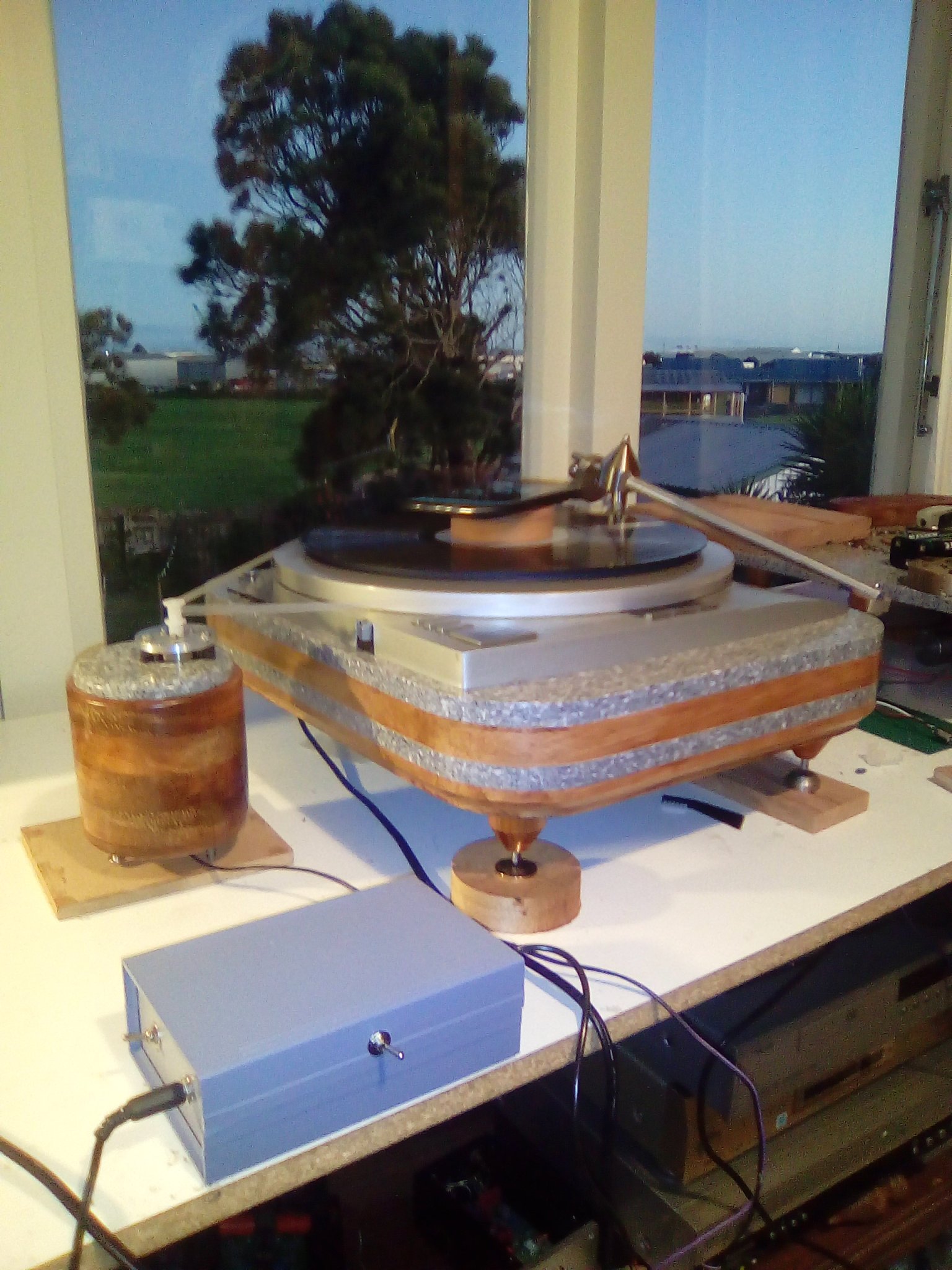

Hi DNic,
thanks for sharing the photo of your t/t. It looks great. If I am not mistaken, your plinth is made of slate and solid wood (not ply)? With respect to the belt, apart from mylar tape, have you also tried polyester thread? If yes, I would be very interested in your impressions and comparison of the two.
Hi, My T/T is made from re-cycled Rimu (a NZ wood) & Corian top plate. No I have not tried the polyester belt. Although I plan to in the future.
You can buy a ready made Mylar belt from Galibier Turntables, I believe, but do not know the diameter.
