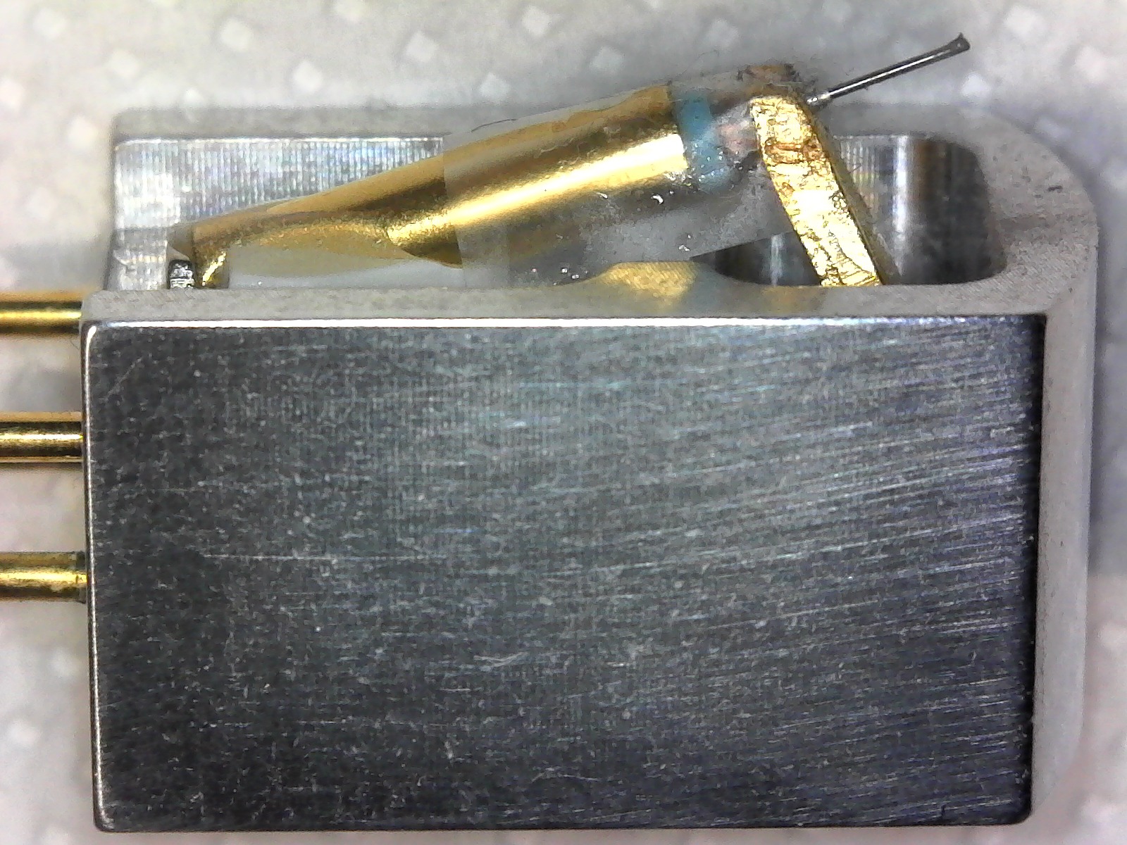

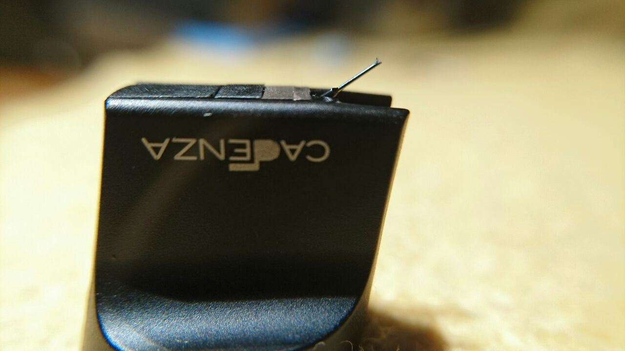

Bad news is usually followed by more bad news. It seems that my Ortofon Cadenza Black may have suffered a separation of the diamond from the cantilever. So, the universe may be pushing me towards my newly restored Lenco L78 and forget about the Roksan Xerxes. But I am resisting.
I've just replaced the Cadenza with my aluminum Denon DL103R with Namiki boron cantilever and microridge diamond. After the proper alignment, it's the first time I am properly listening to my Xerxes after the upgrade of the Origin Live controller with the bigger Nichicon capacitor and the setting of the power pack to 12V.
So, how does it sound? More stable and 'confident' than in the past. I have the impression that now the controller can better overcome the instant changes of stylus drag and allow a better flow of the music. And the bass has become even stronger. The improvement is not huge, but can clearly be seen (heard) in the details. So, I am happy about that. The change of the capacitor has been a significant upgrade. Many thanks to Sondeknz for the guidance.
Now, I have to see how the issue with the Maxon motor will be resolved and even more importantly how to fix my Ortofon cartridge...

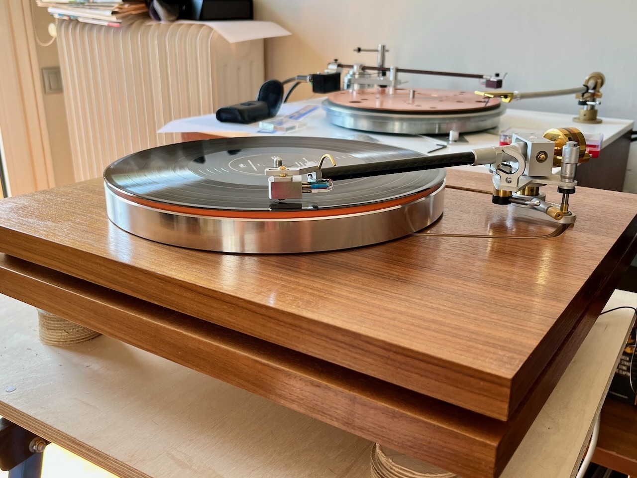

Here are my two babies back to back. The old guy (Roksan Xerxes) at the front and the young guy (Lenco L78) at the back.
Reactions: SONDEKNZ
Beautiful!
I don't really recognize either table, but they look gorgeous.
Well done, Panos!
PS: I'm running a stock DENON DL-103R these days. I'm pretty staggered at how good it is, at NOT huge sums of money. The big DENON could easily become my go-to cart, once our SHELTER 501/2 finally turns up its toes...
Thanks, Sondeknz.
The wooden deck is my Roksan Xerxes with a changed plinth. That's where the Origin Live controller works.
The deck at the back is a restored Lenco L78.

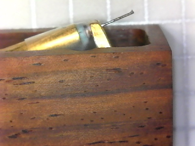

Sondeknz,
the aluminum body (not just an aluminum cap on top of the plastic body) would cost probably more than 100€. But the improvement is massive. More bottom end, better clarity. I also had my DL103R retipped. Instead of using the stock cantilever and elliptical stylus, I went for a Nakimi boron cartridge and microridge stylus. Both DL103R are not comparable with a stock 103R anymore. Worth spending time and some money to do an upgrade. You will be rewarded.
You may search on e-bay to see what's on offer.
Wood is a less expensive alternative and can also give very good results. You can also find many wood types on eBay, to choose what you prefer.

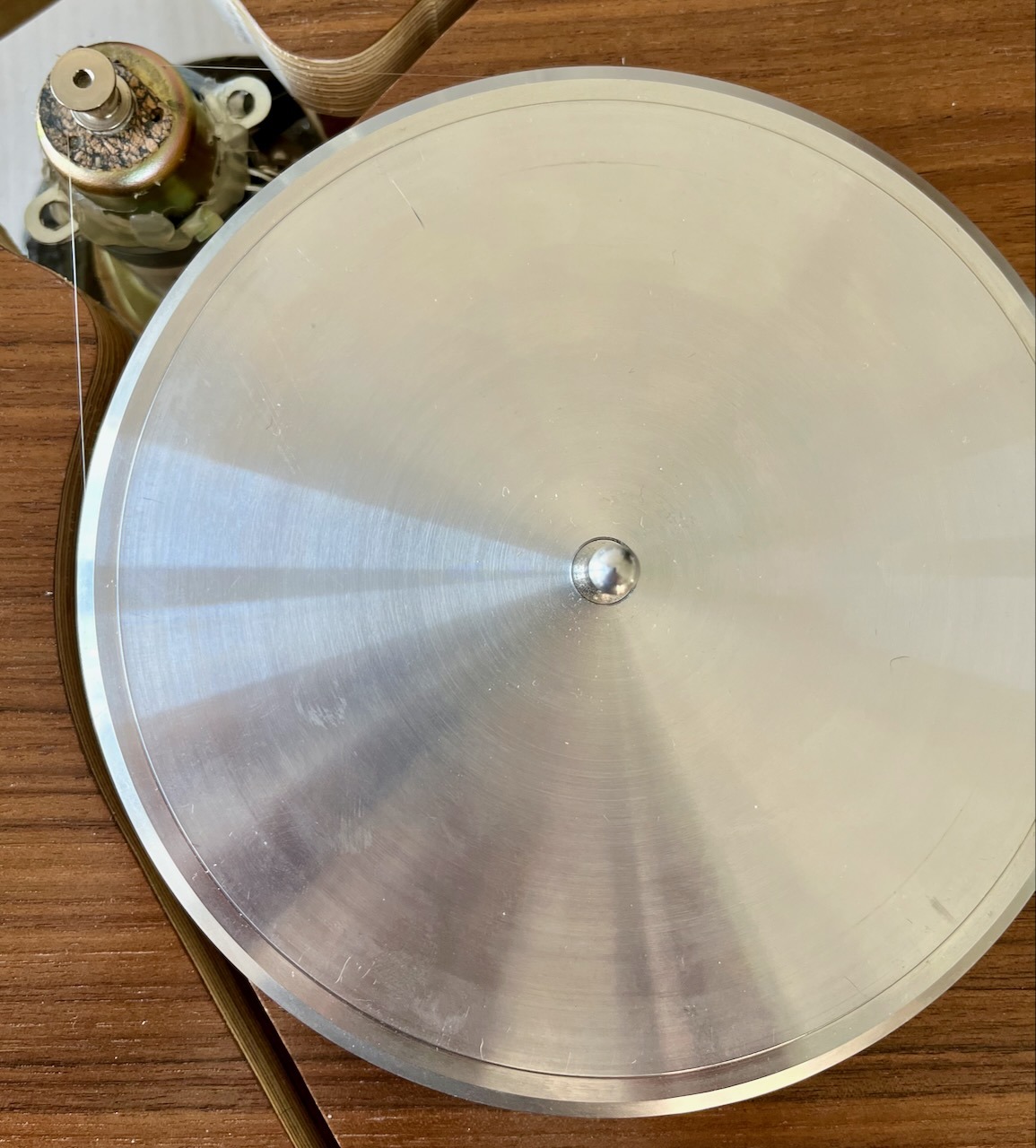

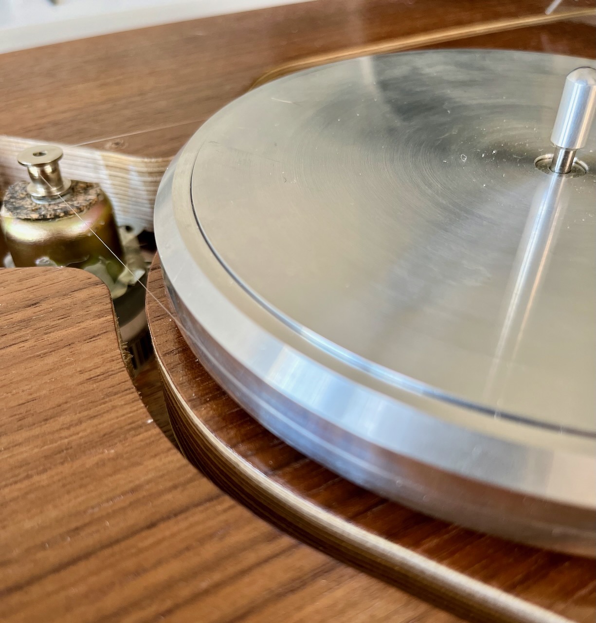

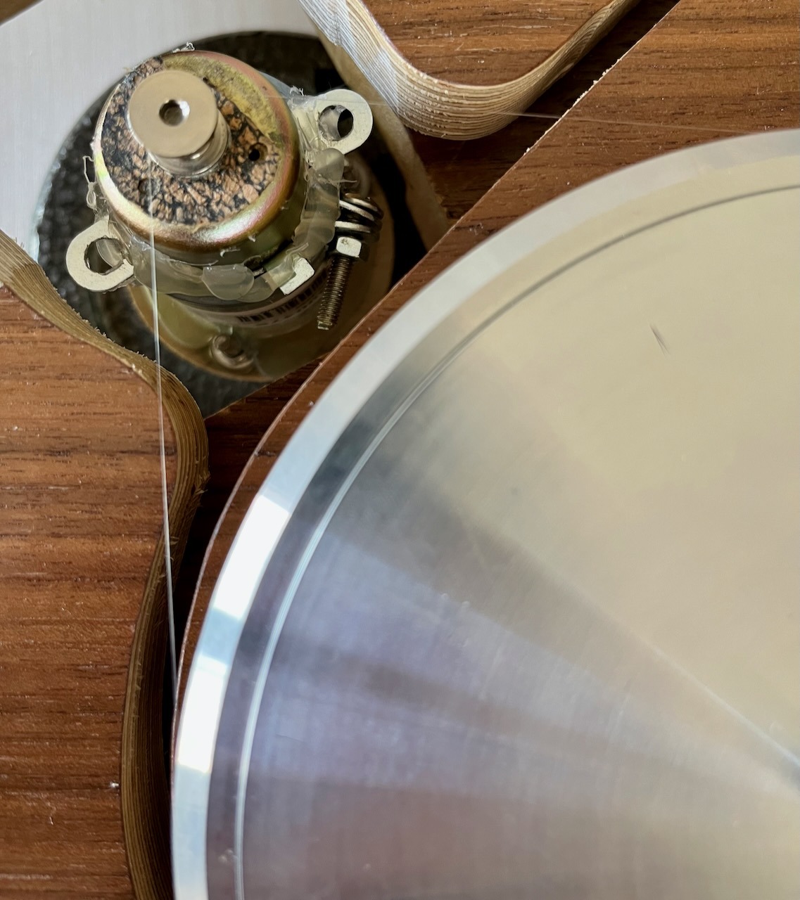

With respect to the belt issue, I have bought polyester (non-stretch) thread, and following the directions of a video, I've built a polyester belt to replace my rubber belt sourced from Origin Live. As a matter of fact, I've built three different lengths and chose the one that fit best my needs.
Although I was a bit reluctant at first, that the polyester belt would not provide sufficient traction, I have been proven wrong. Despite being extremely thin, it works and sounds absolutely fine. It is at least on par with the Origin Live belt, if not better. And the good thing is that you can make as many belts as you want at the cost of a single thread spool, which is 2000m long (!)
Enclosed some photos of the polyester belt. I hope it is visible.
An inexpensive and reliable solution. Very easy to implement, too.
